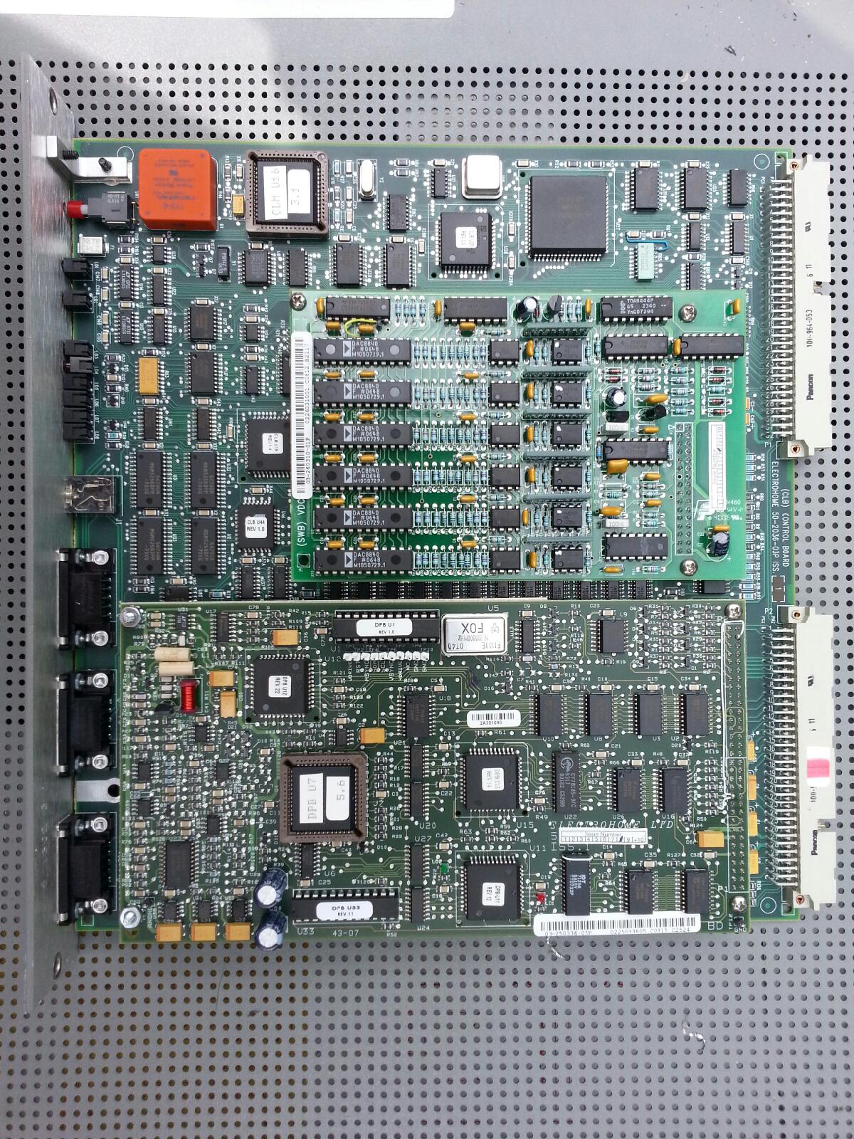

So, that's what comes up! Version 6.1
Tubes look 100% unused, but the hour meters are in the 20-30 THOUSAND hours...
The projectorlooks unmolested.
Mfg. January of 2008.
Is this an unused projector???
It came to me on a pallet of 5, the others vastly used and essentially crushed...
- Melifluonze

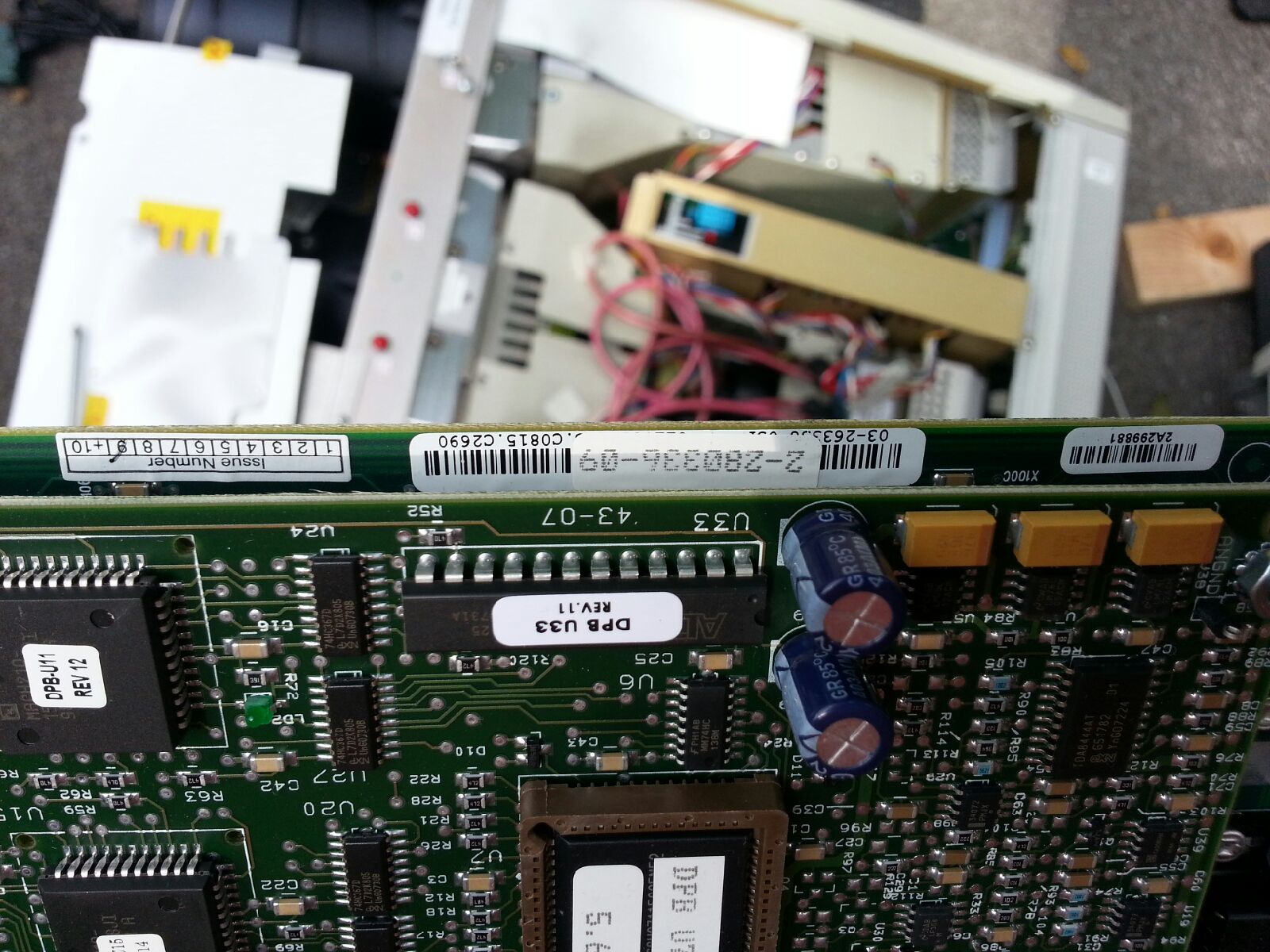

Part Number
 Filesize:  75.23 KB
 Viewed:  7569 Time(s)

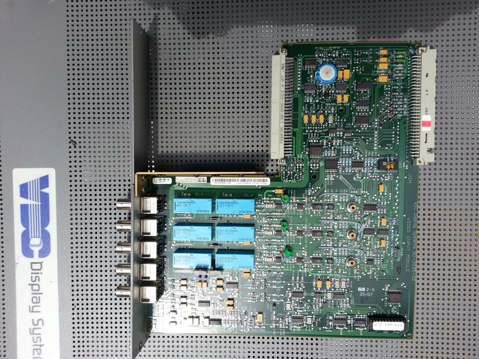

Neck Board
 Filesize:  308.61 KB

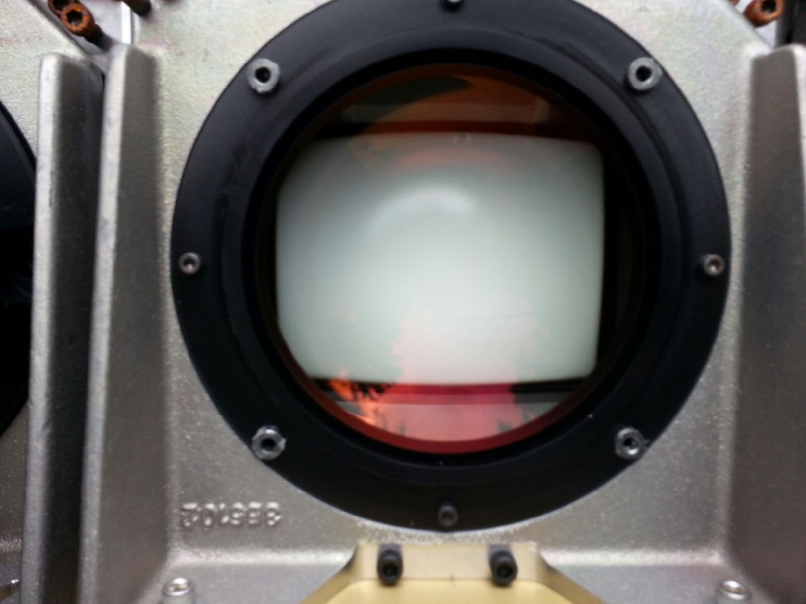

Green Tube
 Filesize:  141.51 KB
 Viewed:  7571 Time(s)

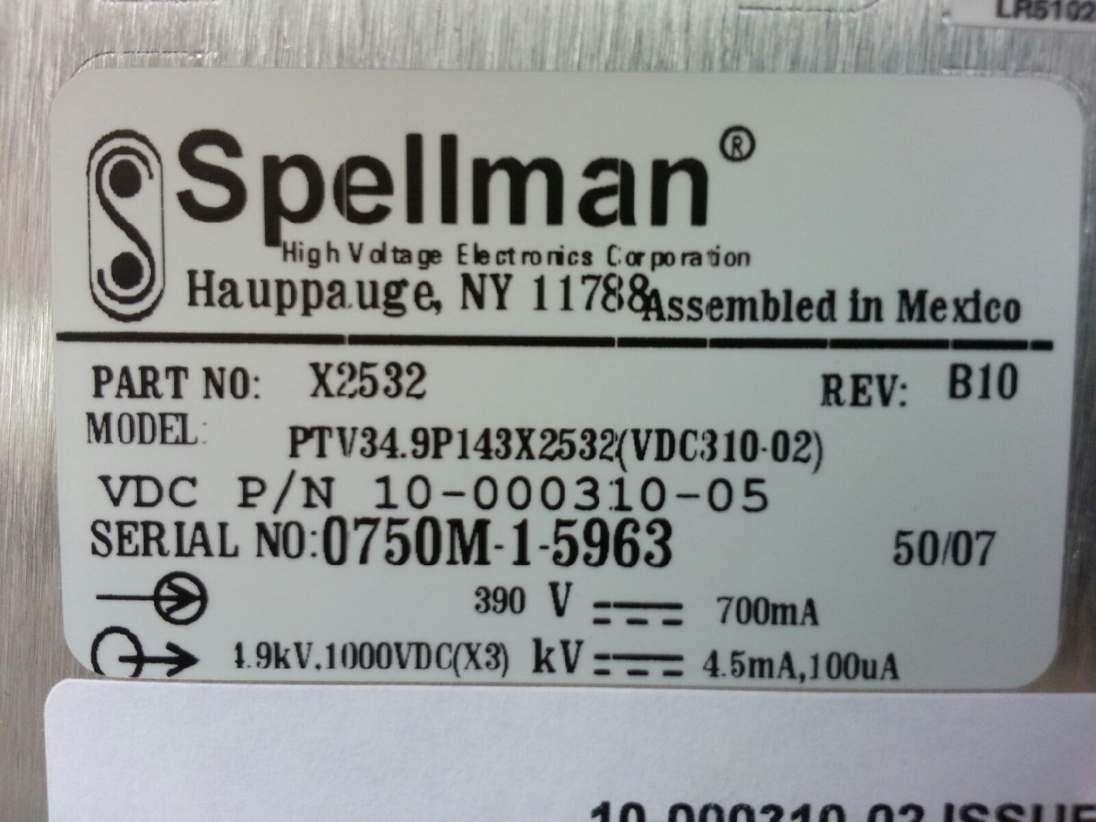

HVPS... Think the voltage is a misprint?
 Filesize:  183.36 KB

Part Number is different too....
 Filesize:  214.9 KB
 Viewed:  7568 Time(s)

Here's the green tube part number...
Going to check if that's normal...
I'm trying to figure out why it says SIM In the description, and why the part number was rev'd...
Tube Number
 Filesize:  192.73 KB
 Viewed:  7549 Time(s)

Sweet on the neck boards!
Curt, you sure you've got these? My other three are not SIM machines... 09 part number...
No... All are HD-10L...
So, is the LUG a better tube? And is the "43" the fast response phosphor?
Posted: Sat Aug 23, 2014 4:55 pm    Post subject:
LUG are nice, not sure if those neckboards are made for LUG tubes, normal neckboards need a mod to run with LUG tubes.
And no 43 is not fast phosphor, be happy about that.
Are they all LUG tubes.? Wink
