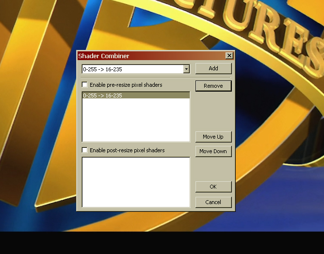

This is a stand alone player that allows 0-255->16-235 both in standard and as extra filter.
http://www.winpenpack.com/main/download.php?view.1228
I was forced to use the filter to get my low gamma right from my tricky computer. It may be worth a try to see if you get out real 16-235. (remember to double check the moome to be in 0-255.)

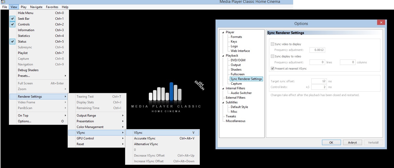

Oh, I'm so glad I ran into you again. I downloaded the player and one thing that really caught my eyes were the several modes of V sync.. maybe there's a solution for my modded VIM 03 in there somewhere! Very Happy
Thanks!

Posted: Wed Aug 27, 2014 7:35 pm    Post subject:
