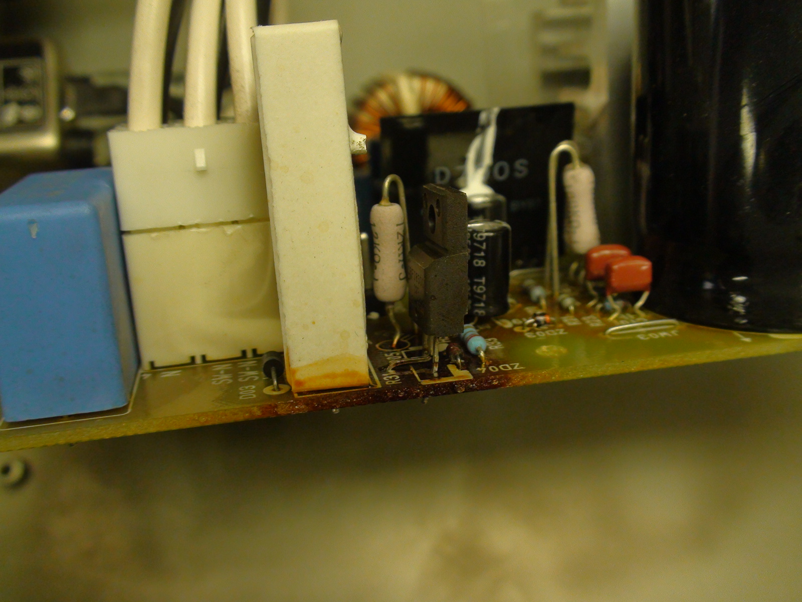

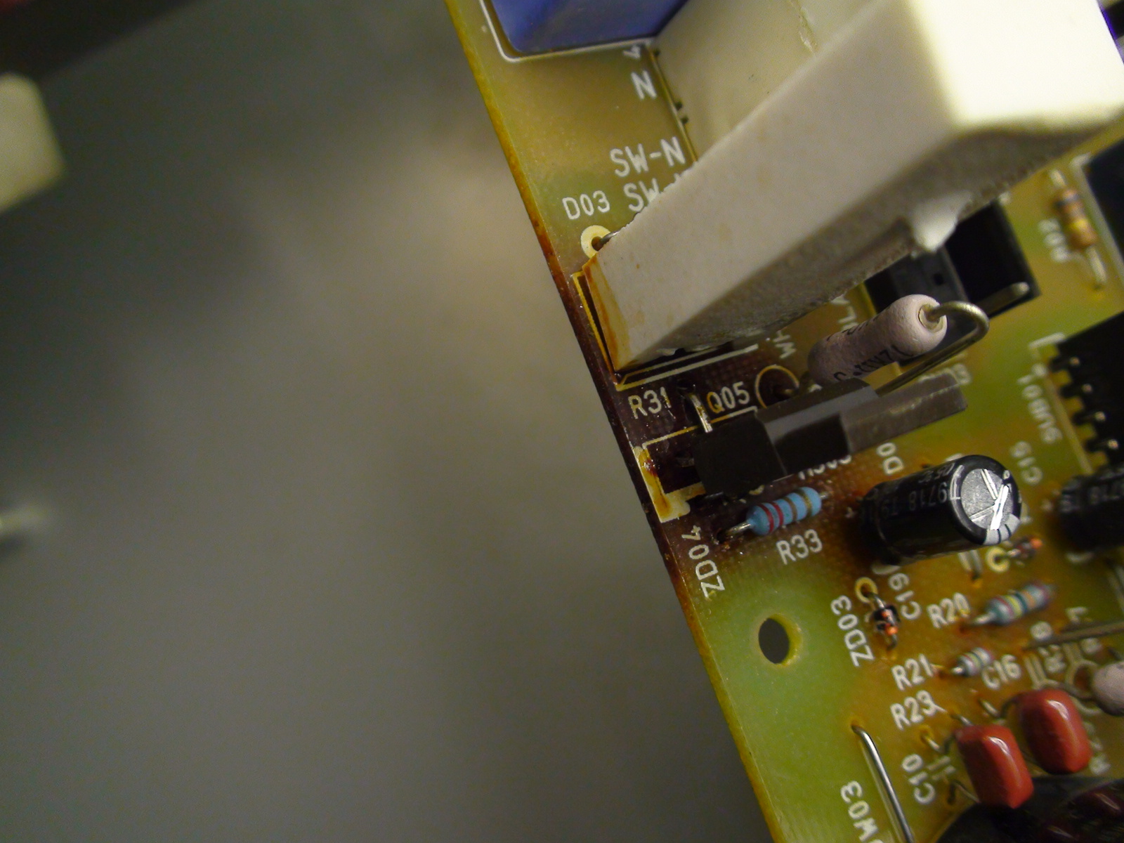

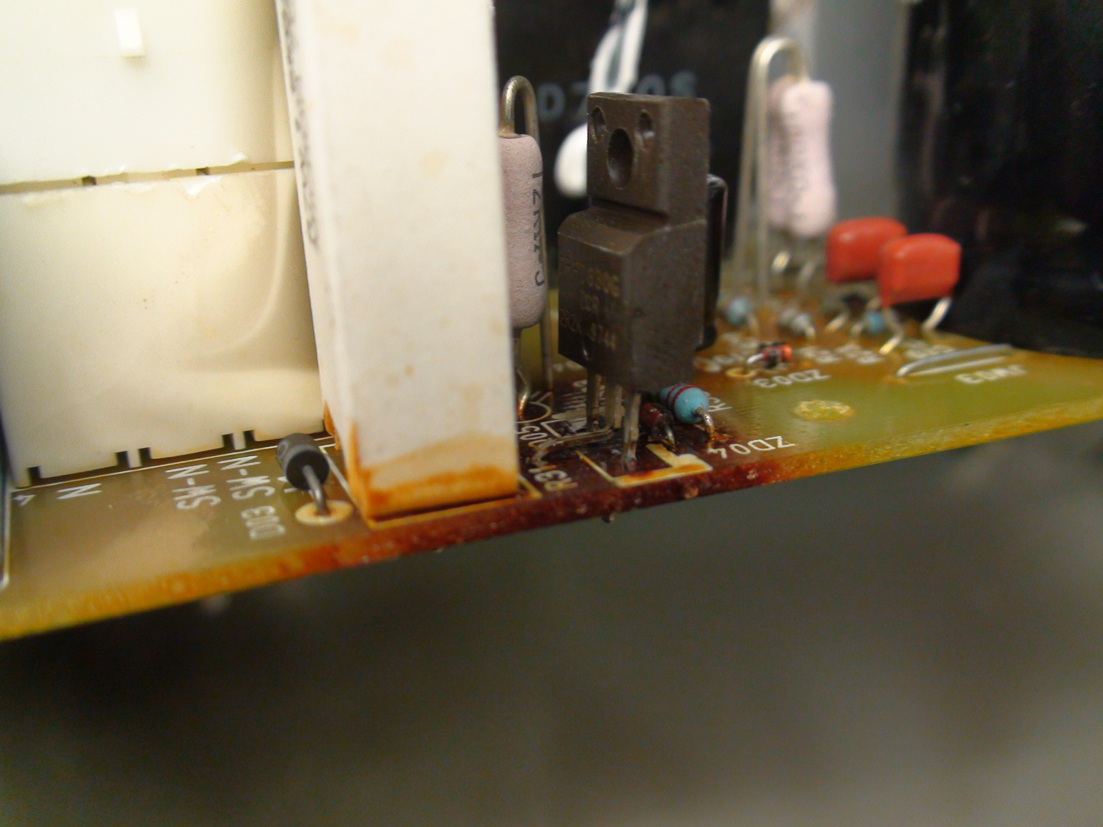

Rainy day here on the wet coast so I thought I'd dive into my f***'d up XG and see if i could see anything amiss. Pulled all the boards out of the card cage, inspected all the HV and deflection boards - no sign of damage...the only thing i did see is when I pulled apart the power supply module and took it to pieces ( it was high time I did that anyway it was getting dusty). There were three areas on the two PS boards that look burned or at least like they've overheated. One was on the main input/filtering board around Q05 (part no IRF1830G) - all the resistor values around Q05 are ok and its not blown open but it sure looks bad. On the daughter PS board there are a couple of other toasted looking areas but not nearly as bad.
One thing I did not mention is that the screen shots I posted earlier do not represent a "continuous" image...there is only an image up on the screen for a fraction of a second on the RGB input...via the moome card it stays up full time. So its "flapping" on RGB.
SOme pics of the toasted looking PS input/rectification/filtering board area around Q05:
 Filesize:  491.8 KB
 Viewed:  4332 Time(s)
 Filesize:  504.99 KB
 Filesize:  505.7 KB

Given the set powers up i think the main issue at this spot is really poor heat sinking of Q05 (it has a heatsink which i removed for the pic - its a really crappy clip on one), obviously this area has been running quite hot for a very long time to look like that. Curt, the boards I bought from you last year (or so) are:
PWC-4271 D-CONV (digital convergence)
PWC-4193 WAVE PWB
PWC-4271 OSC-PWB
Plus I think an
F-DRIVE
V-DRIVE
C-DRIVE
I do not have a System Board.... maybe you could PM me with the cost of that one plus someone mentioned my symptoms could be one of the deflection boards ( looks like vertical possibly given the glitches are in portions of the vertical scanning...
...Dave

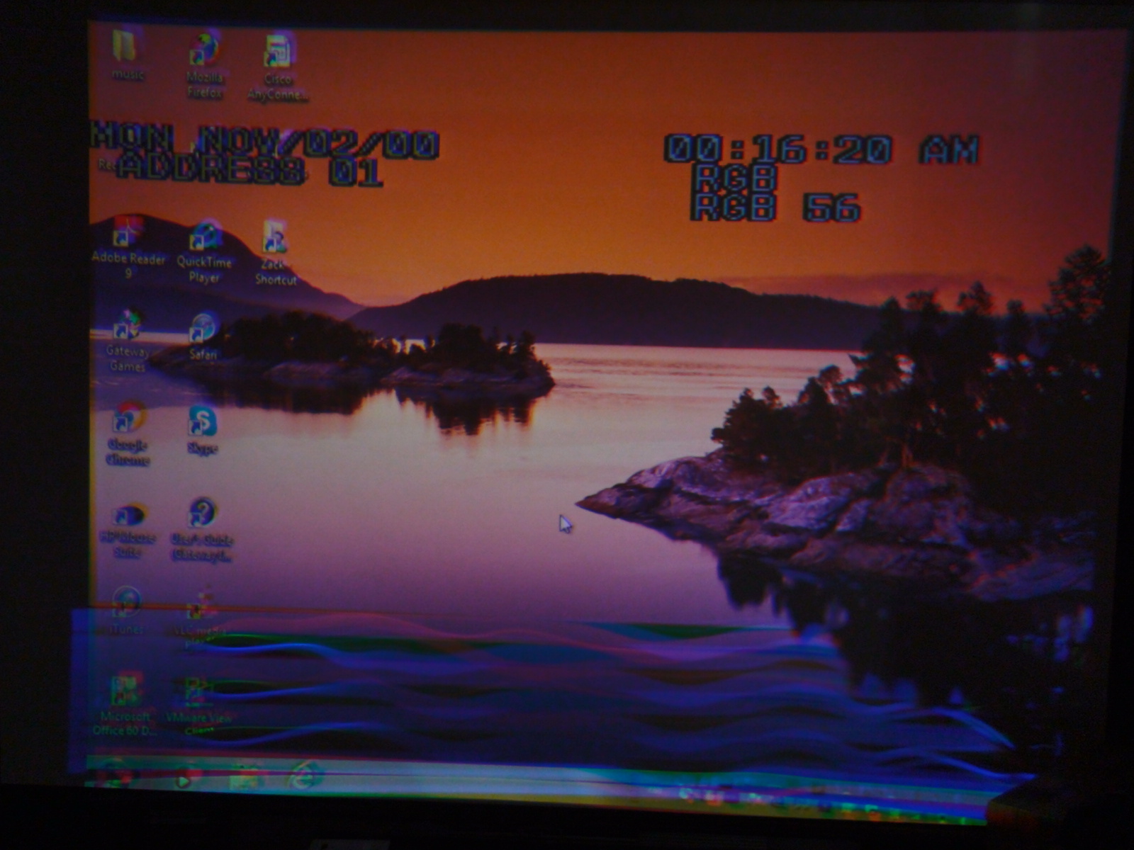

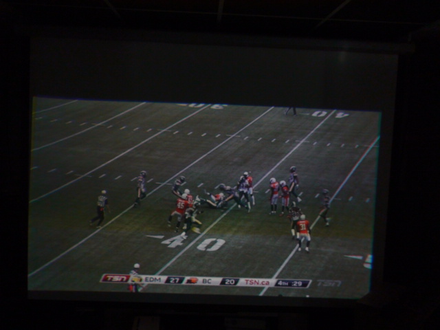

Things are looking somewhat better - although it appears I have an intermittant...I think it likely IS the system board because when the set craps out i lose control not only with the remote , but also can't even power it off using the green enable button on the rgb /input area on the rear edge of the set. Does this sound "system board" Curt ?
I tried swapping in all the logic boards I had from Curt made no difference.
It appears to stabilize with the set warming up, so maybe I've got some bad caps somewhere....
Some screenshots attached - things are still wonky even tho the image is clean - the position of the image is about 1' too low and I've lost my perfect convergence on the edges. It only looks somewhat clean because I adjusted the static.

Screenshots. Oh and I added a nice big heatsink to Q05 in the PS input board before I reassembled the set....

What a weird problem ....after watching a nice clean image (BC Lions game) over the Moome HDMI for the past 30 mins, look what happened when I switched to a laptop RGB connection...bottom 1/5th is smeared with weird wavy lines in the raster !
 Filesize:  429.11 KB

Posted: Sun Jun 29, 2014 2:56 am    Post subject:
Delete that source and make a new one. You might have to delete them all and redo them.
Posted: Sun Jun 29, 2014 9:16 am    Post subject:
By the way, your last picture shows the symptoms of a bad D-convergence board.
