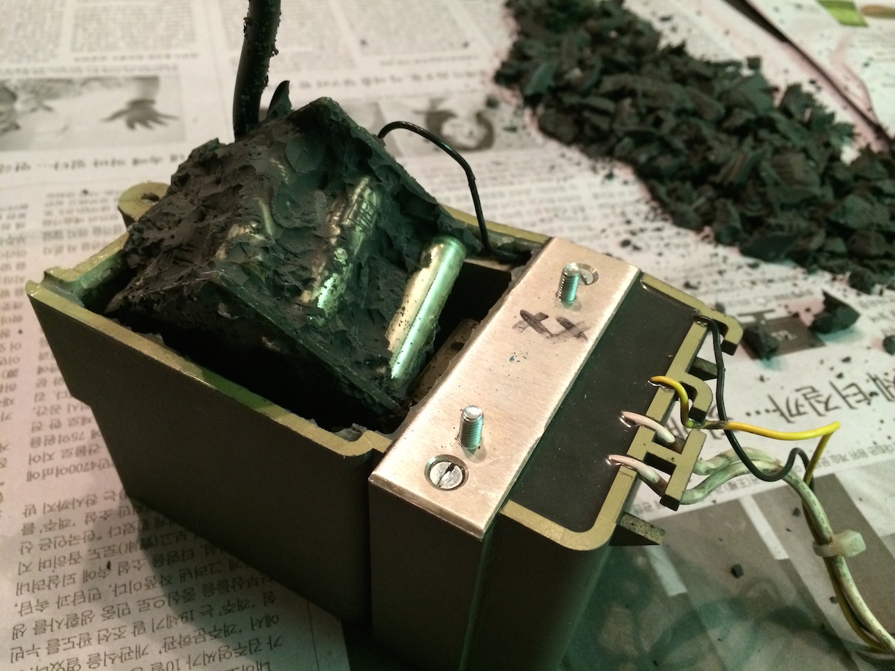

I have 4 quadruplers for cine9.
and two of them have faulty condition.
One has HV shutdown after 30 min.
other one has no HV and eaten my EHT card (EHT fuse was not a slo-blo type Sad )
I am thinking of edge blend. so having spare parts is must.
buying of used or new quad is one of solutions. but I want a high reliability quad. so I dug my faulty quad.
I need informations for replacement capacitors and diodes Very Happy
original capacitors are - ero MKT 1816-230/115 maybe from vishay. 3000pF 10Kv

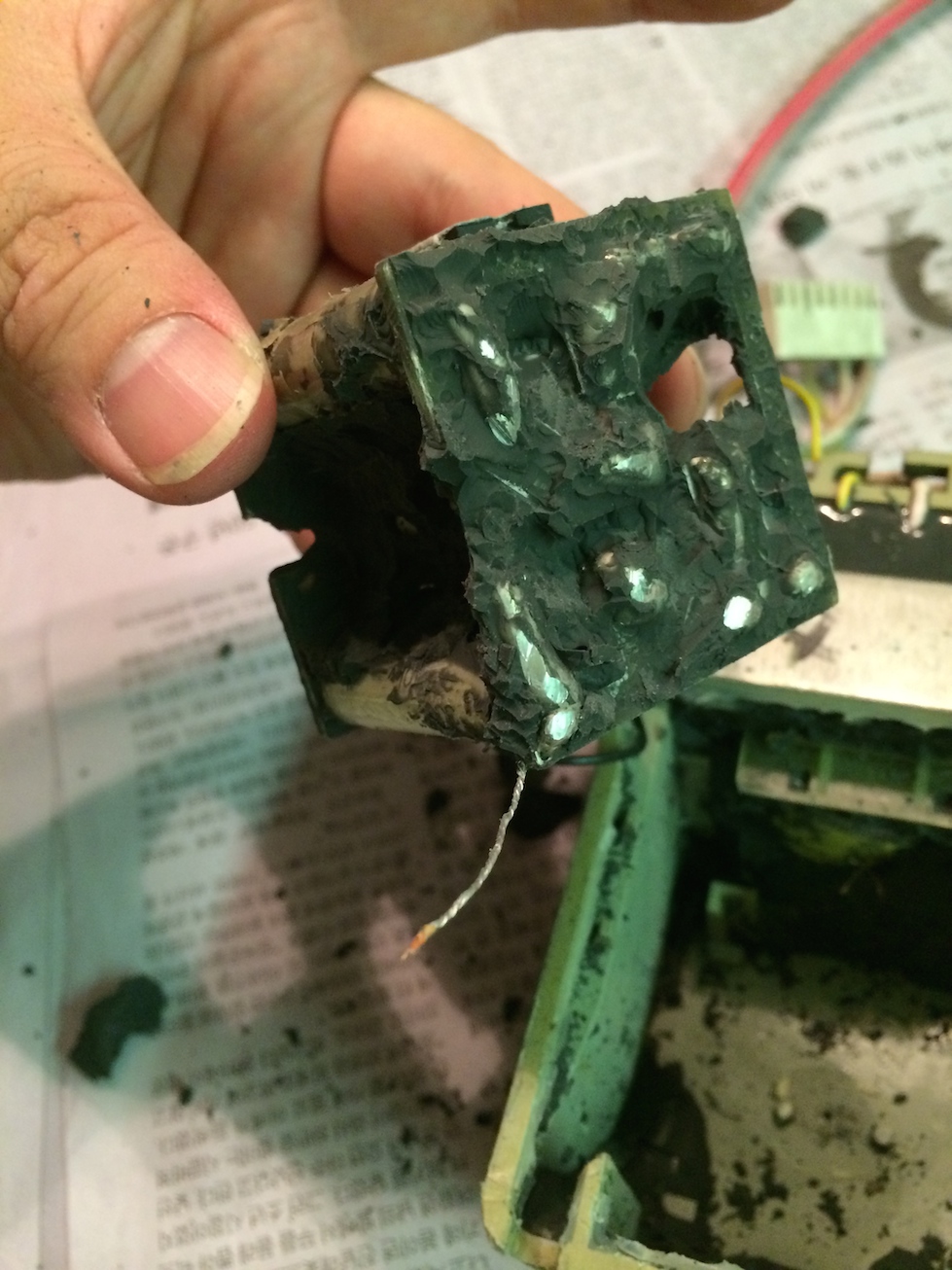

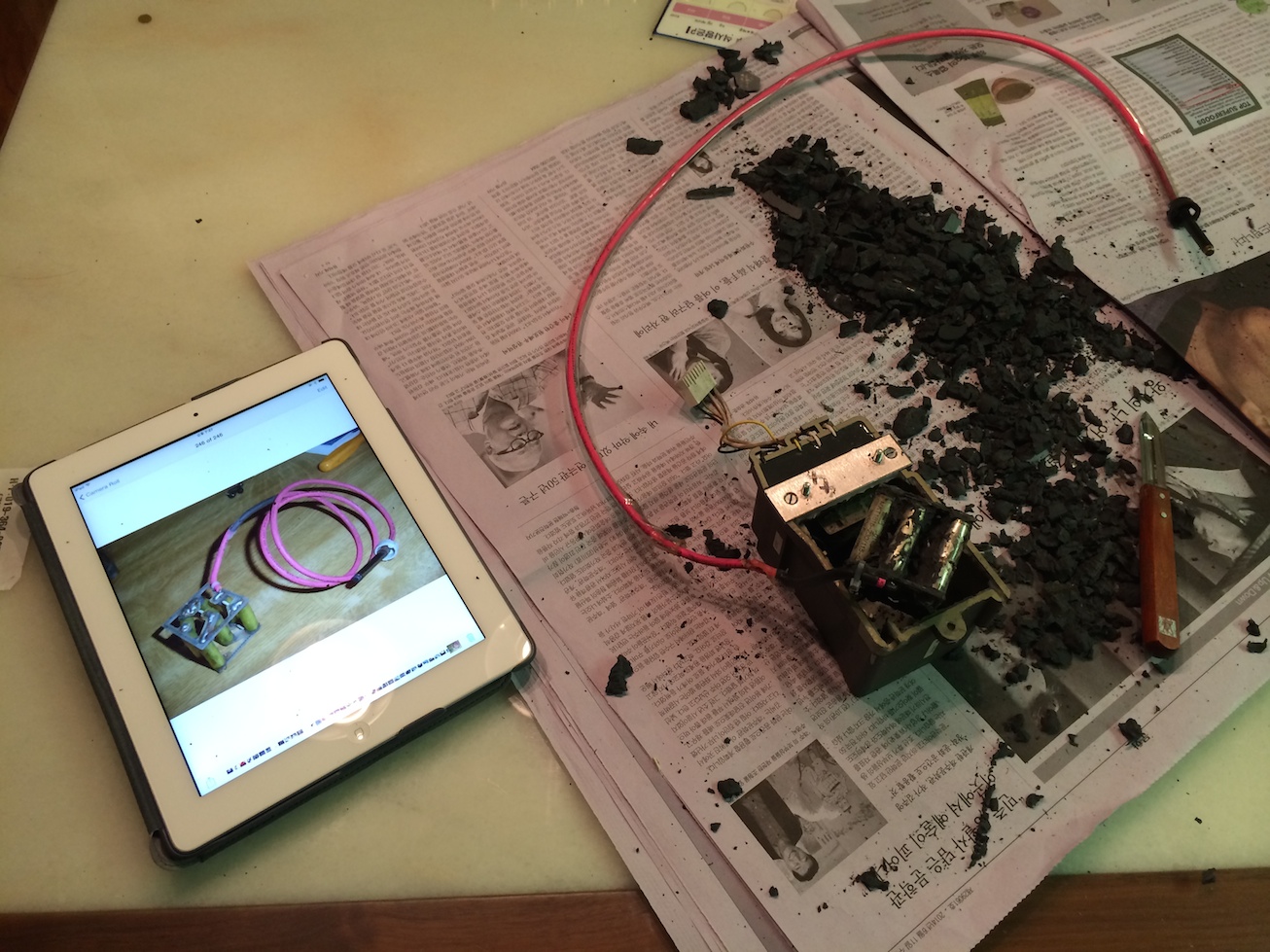

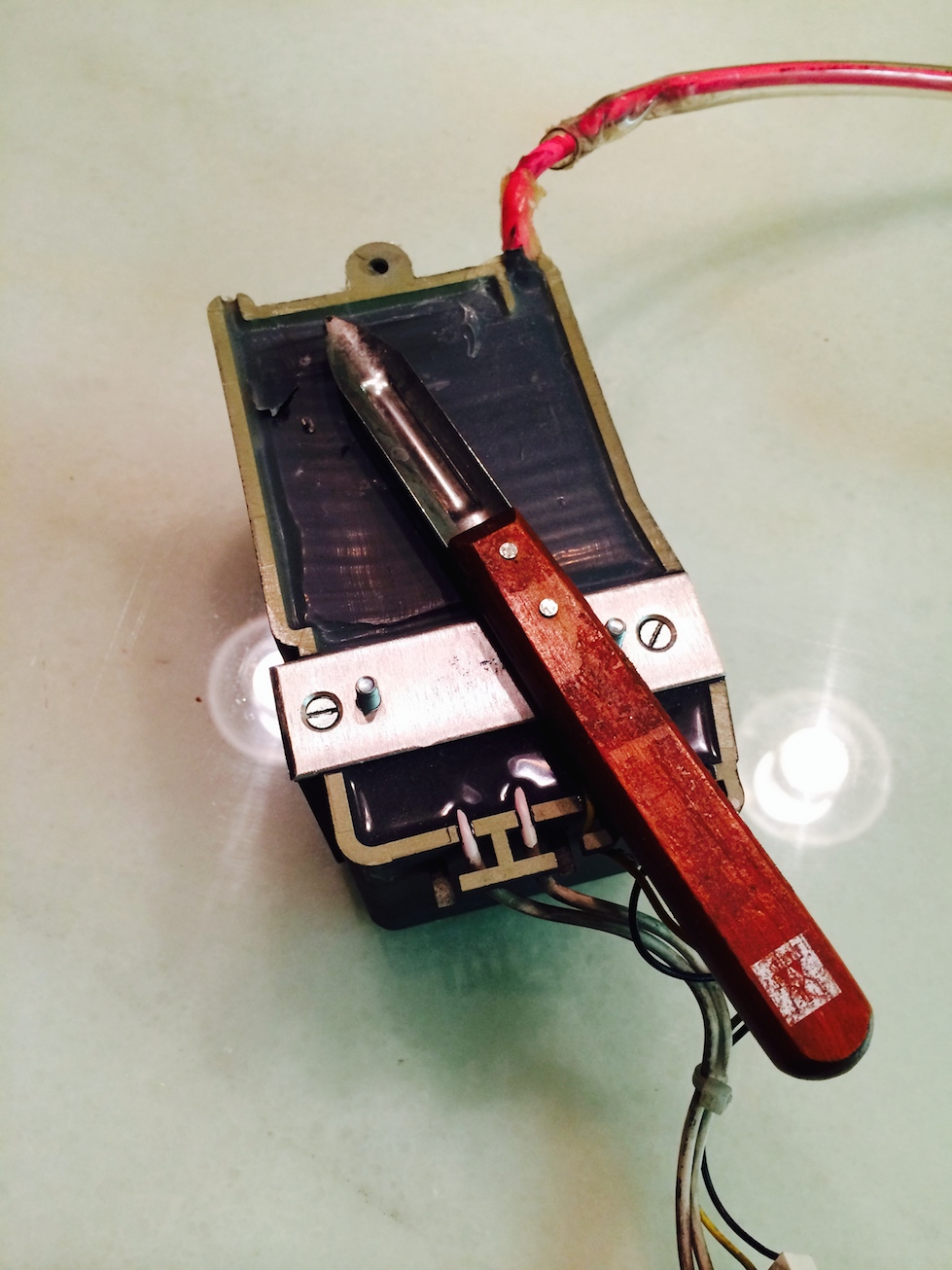

Potato peeler is my best friend!
 Filesize:  369.68 KB
 Viewed:  22981 Time(s)
Before digging a big scoop, poke vertically. potting is not so deep.

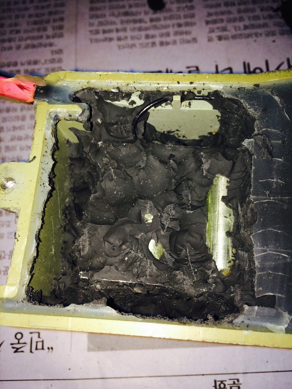

There is a wire on the edge. be careful.

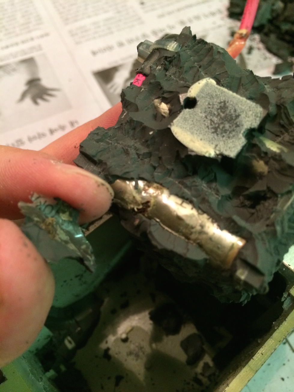

finally, I took capacitors out.
 Filesize:  401.53 KB

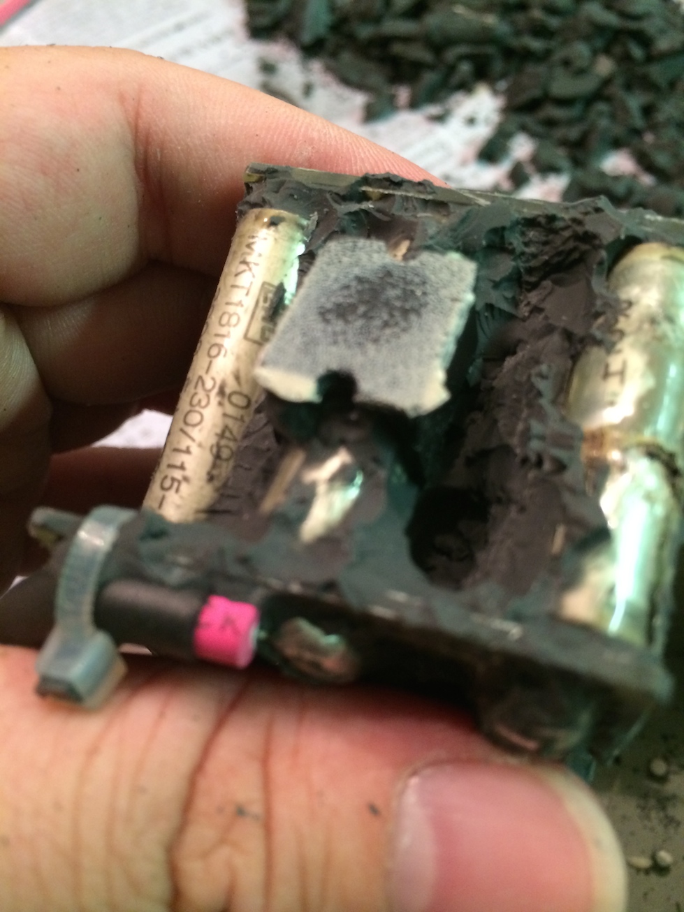

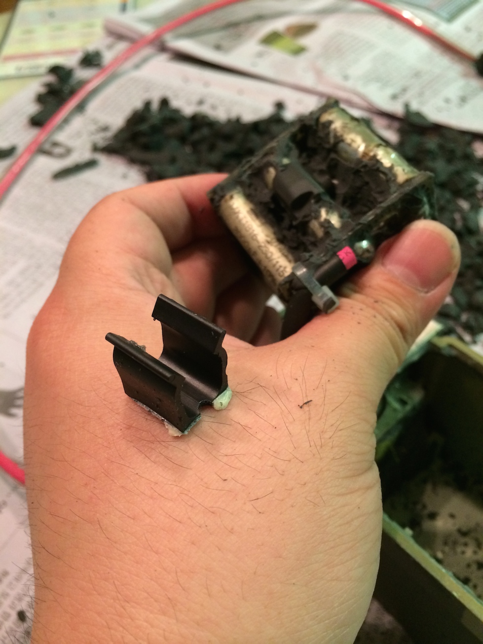

There is a blown capacitor. WOW!!!
 Filesize:  380.25 KB

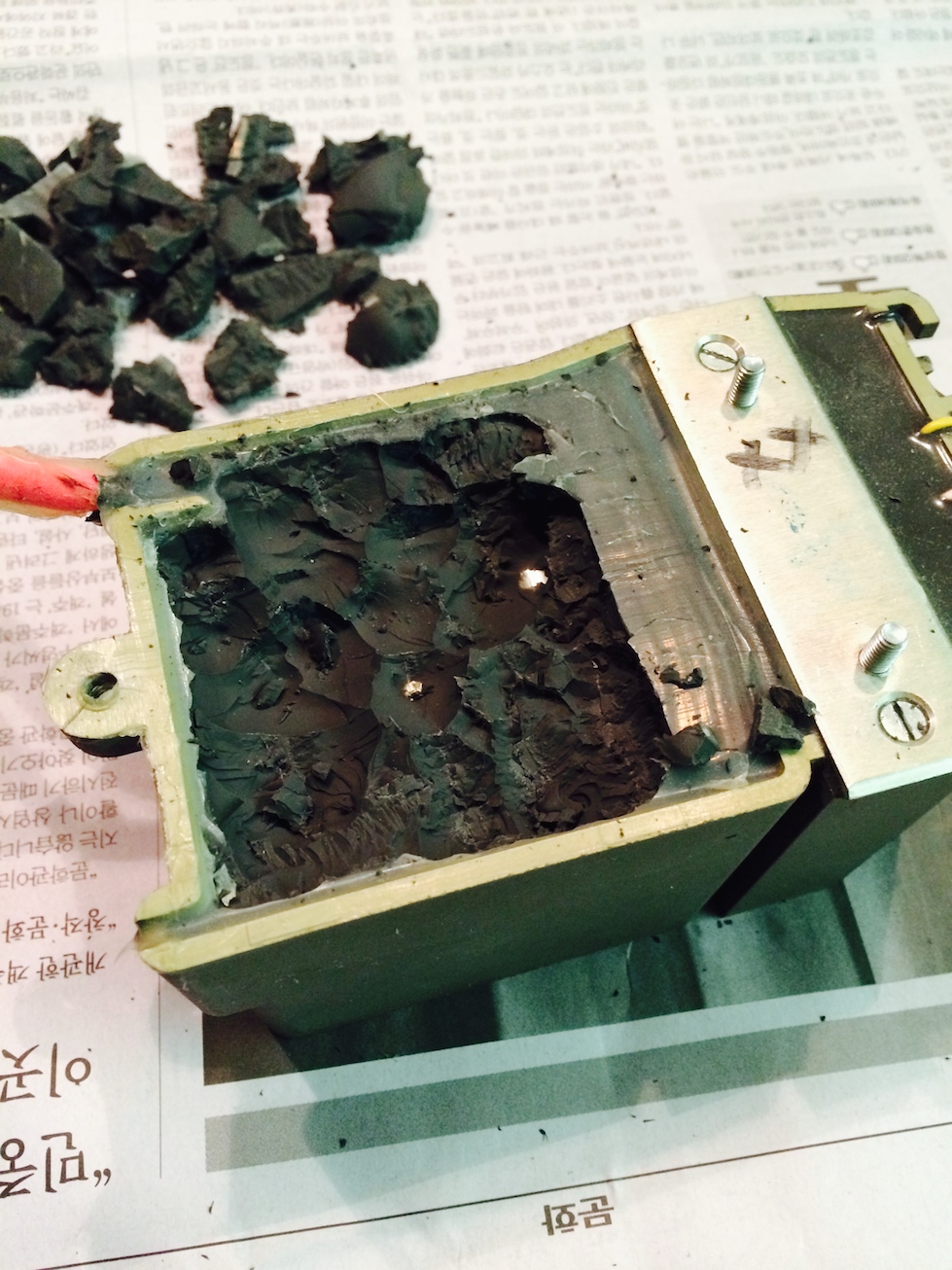

there is a MOUNT on the bottom of caps
 Filesize:  370.68 KB
OOPS.. I cut the wire from transformer. Can I fix it?
 Filesize:  405.66 KB
This is the mount.
 Filesize:  376.77 KB

As I see you already found the other thread where a guy talked about repaired quads. Acording to him, the capacitors are going bad, because their voltage rating is "too low". So you have to find capacitors with the same capacitance and 12,5kV or 15kV rating.
Thanks gjaky!
actually he said 20kv rating.
but I could fine 30kv rate one only. If it's size can fit. I'll try one.

Actually, from what I've found, the problem with the newer quads is not defective parts, but it's the potting compound that goes conductive over time. Being able to find non-conductive potting compound that is good to 34Kv, and seals with no air bubbles in it, that will be the trick.
