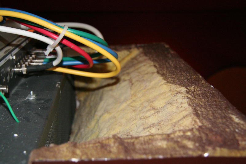

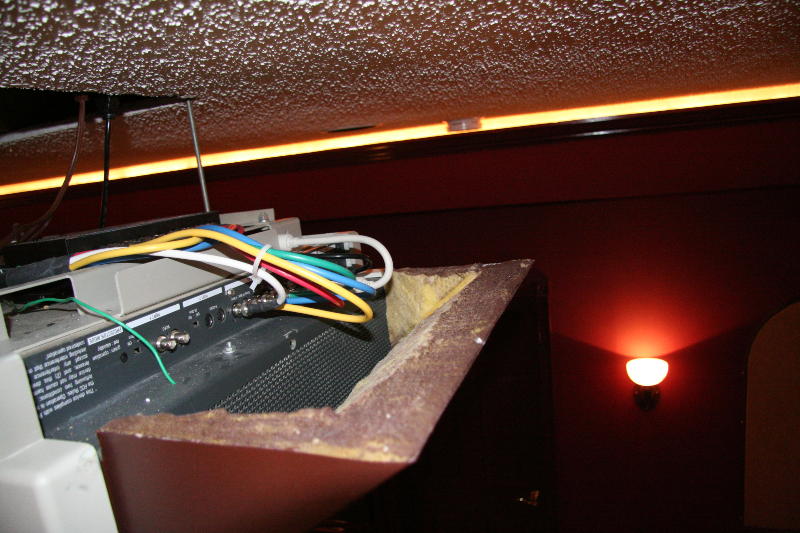

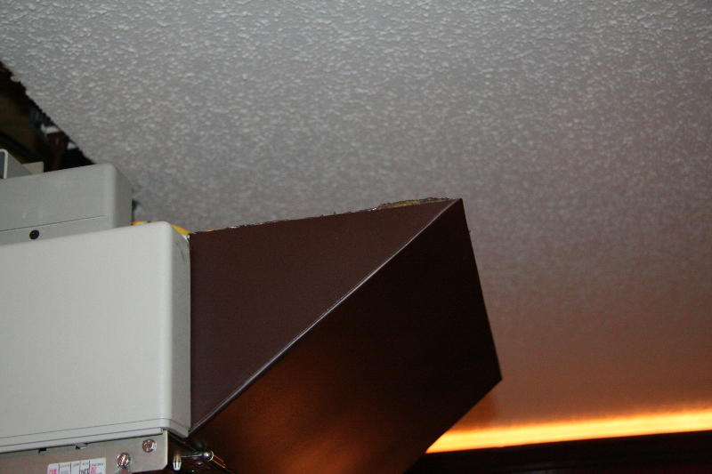

I would say it cut down on the directional-ness by about 1/2. Noticeable. I mean the noise is still there but it more diffused...especially if you sit right under it.
I used some pre-painted aluminum flashing material that came in brown. 14" width I think. I then lined it with some fiberglass board. Since the board isn't rated to go on the inside of a duct and is friable I sprayed the surface of it liberally with 3M contact adhesive until it created a skin on it (you can't see it in the photo but it's there). I also tapered the insulating board down on the edges so as to not obstruct the airflow.
REMEMBER: If you do this, make sure you spray the insulation with some sort of glue to keep it from frying. You don't want to be breathing fiberglass!

Very cool picree. So, are the fans working harder, or is the airflow enough? I would have thought it might need a more open area around the fans.

I haven't noticed a difference in fan speed. The vents aren't as blocked as much as it looks in the pictures. I don't have a thermostat or anything. If I can judge by the amount of convergence drift I see over an afternoon of football, I would have to say it's running pretty cool. After having the proj on for even six hours I check the dot-hatch and there isn't any drift. FWIW...
