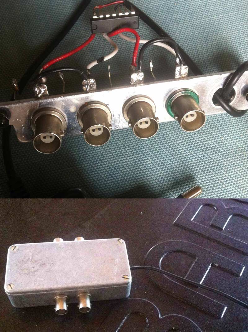

hiddink wrote:
Hello,
Today I made a sync inverter for barco G 808, based on this part:
http://nl.rs-online.com/web/p/hex-inverters/0307503P/
I got the +5V power from a cell phone, followed the scheme here:
http://www.twobits.com/sync.html
Look at the images for the result (proof of concept)...
Now, when I connect a normal DVD-player to port 5 WITHOUT the inverter, I get a good image from the projector.
However, when I use the DVD-player WITH the inverter, I get "Source not available"...
What could I have overlooked that it does not work? Any ideas?
Thanks in advance,
-brt
gjaky wrote:
Port 5 accepts only negative sync, right?
So your DVD player have negative sync on output, since the projector works. Now your sync inverter inverts sync so the negative becomes to positive, which is not accepted on port 5 so to me it seems to be working.
tschaeikaei wrote:
An inverter inverts the signals polarity. Barcos run on negative Sync polarity. So if your DVD player puts out negative, the inverter will invert it to positive.
And the projector does not run with that. OK?
Regards, Julian
I got your point and you're both right: when I connect my MacBook Pro to the Port5, in case I DON'T use the sync inverter, I do not get an image ("Source not available"), in case I DO use it with my inverter, I get a nice image of my Desktop at 1080p...so that's good news...however, the image disappears for 2 seconds, I get a grey, noised or "snowed" image and after 3 seconds, the Desktop image comes back for several seconds, disappears, and so-forth, and so-forth...
Any idea where this comes from?
Thanks again!
Regards,
-brt

I definitely can confirm that the DIY sync inverter works, used in combination with the HD Fury...
Tonight, I connected a raspberry pi (tiny media server capable of playing 1080p) to it, and without the inverter, I got a "Source not available". When I connected the inverter with it, I got a nice and stable image...
http://www.raspberrypi.org/
http://www.raspbmc.com/
So I am wondering why the inverter did not resolve my issues with the iPad...any ideas?
Thanks and regards,
-brt

Posted: Thu May 15, 2014 6:28 am    Post subject:
CasetheCorvetteman wrote:
Yeah mate, timings are incorrect. Someone else will be able to explain it better, but from memory i think it was sync width that is too short.
FINALLY, I got a nice picture on the Barco G808 with a Netflix-video from the iPad (with HD Fury on port 5)!!!
After that I had built the sync-inverter, I had tested it with an iPhone, then I got a "Source not available" so I gave up for then, supposing that both iPhone and iPad would act in the same way. Until then, I could only successfully connect a Raspberry Pi with XBMC ...
However, yesterday I tested once again now with my iPad and guess what: I got a very nice picture, I am very happy with this result! I need to do some fine-tuning on the projector but the overall result is very nice...One of the reasons I like connecting my iPad to the Barco is that I can stream the audio directly to my hifi using Airplay on the iPad while the video stream goes into projector.
You mention "incorrect timings" but how can I become aware of the specific timings (h-sync and v-sync) a specific device needs? Just by trial and error? I saw how to configure a custom-preset in the barco (h-sync, v-sync) but how assure that the connected device picks up this specific preset?
Thanks again for all your help...I am very happy so far with the result...last week I ordered a Chromecast http://www.google.nl/intl/en/chrome/devices/chromecast/. Want to test this also in this set-up...
The only thing which remains unclear to me is why the port3 with a thoroughly tested custom-cable (VGA-D-sub 9) does not work. Would be nice to have that working also in order to compare results...
Anyway, thanks again to all of you for your patience!
Regards,
-brt

Posted: Fri May 16, 2014 1:19 pm    Post subject:
So did you get port3 to work?
If timing on the source are not changable, try to switch retrace time on the projector menu.
so that's good news...however, the image disappears for 2 seconds, I get a grey, noised or "snowed" image and after 3 seconds, the Desktop image comes back for several seconds, disappears, and so-forth, and so-forth...snowed
I know of a strange behavior my Barco G400 had. It switched itself off from time to time (tubes black) and back on after a few seconds.
This is similar to your problem, but not the same.
In my case it was because the sync level (amplitude/voltage) was too high.
If you have a scope maybe measure H and V-Sync voltages and if it is too much, try a resistor in line.
I do not know if a resistor is a good solution in that case, but other people can tell.
But, don't worry, you cannot kill something by adding a resistor. To me, it was a good help.
Regards, Julian

Posted: Mon May 19, 2014 6:34 am    Post subject:
Regards, Julian
Hello Julian,
No, port 3 does not work, I still need to solder the Scart-Dsub-9 cable to check whether there is a problem with the board of port 3.
I made a beautified version of the sync inverter this weekend and with that, port 5 works very well at 1080p (iPad, Raspberry PI, etc)...
The issue with the noisy or snowy image sometimes appears but can be fixed easily by releasing/connecting the HDMI cable to the HD Fury once, the sequence of how I connect projector/inverter/hd fury/device seems to play a role there...Not a big issue though...
What remains is port 3, have to work on that to see why the customized cable does not work...
Thanks again!
-brt
