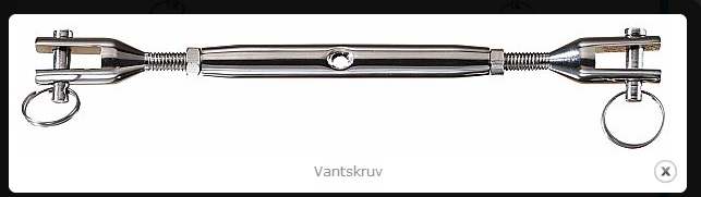

the big E wrote:
You wouldn't happen to have the set suspended do you?
If yes does it move?
I am toying with the idea of getting two marquee split pack chassis for my blend setup
All I can tell you is this - chains are not equal in size as one would imagine. Of the 4 chains that I bought, 3 were more or less equal in size, but the 4th one was a whole link longer than the rest of them, forced me to make a "thingy" that would counter act the pj being way off now. I used a laser for all of this and yet the outcome was very disappointing, the image was off by at least a foot to the left. So chain are no good at all I'm afraid.

thewolfman wrote:
Remove a link in the longest chain

the big E wrote:
thewolfman wrote:
It took 5 minutes for it stop. Gave it a little nudge, but It's still moving after 5 minutes, but just barley, so 5 minutes is the rate for me at least. Chains are good if you incorporate length adjusters that are found on boats that are tied to the docks for an example. I'll post an image showing how they look. Using them chains are perfect to the tee.
And yes, the chains in the roof need to be separated by at least a foot wider than that of the pj. Doing this should make it solid in place indeed.

thewolfman wrote:
the big E wrote:
thewolfman wrote:
Noted not sure yet how I will mount the sets but ceiling mounted sounds best as having two of these beasts setting in the floor is a tad but of a space hog

the big E wrote:
thewolfman wrote:
the big E wrote:
thewolfman wrote:
And one more thing, don't be tempted to make it absolutely in a 90 degree angled towards the screen, it doesn't have to be, but rather a foot or so higher and slid a comfy recliner underneath instead, or slightly ahead. To be the King of your domain sort of. Smile
