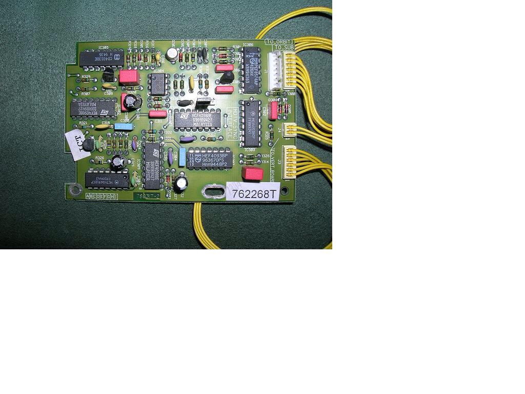

Hulio
Joined: 15 Apr 2006
Posts: 494
Location: Belgium
Posted: Thu Apr 24, 2014 10:48 pm    Post subject:
I am sure that in not the orbiting module. I owned the HDTV module in the past ( AKA tri-level sync board ).
The orbiting module is rectangular and have only two wire connections.
On the HDTV board there are three connection jumpers and also the shape is a bit different. Here a pic of my former HDTV module.
 Filesize:  199.95 KB
 Viewed:  3369 Time(s)
Decibel
Joined: 31 May 2007
Posts: 904
Location: Roma - Italia
Posted: Thu Apr 24, 2014 10:58 pm    Post subject:
ok Thumbs Up
Domenico (Barco fan!)
