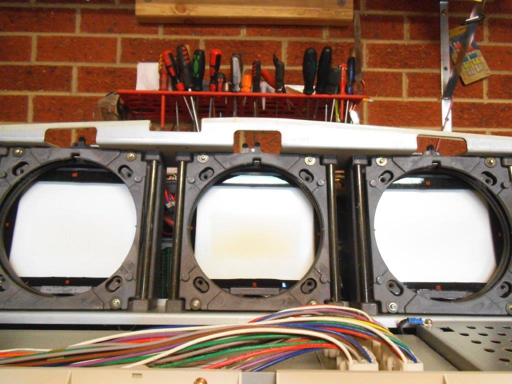

Hi Guys,
I have been out of CRT projectors for the past 5 years. My last projector was a NEC PG9+. I have just picked up a NEC XG75 in near mint condition. Picture of tubes attached. I will be running it from my Onkyo TX-NR809 or my Oppo BDP103. Both have great video processing but I think I am stuck with either 1080i/50 or 1080p/50/60. What would be the best resolution for the XG75?
Thanks,
Greg.
Picture of tubes
