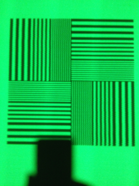

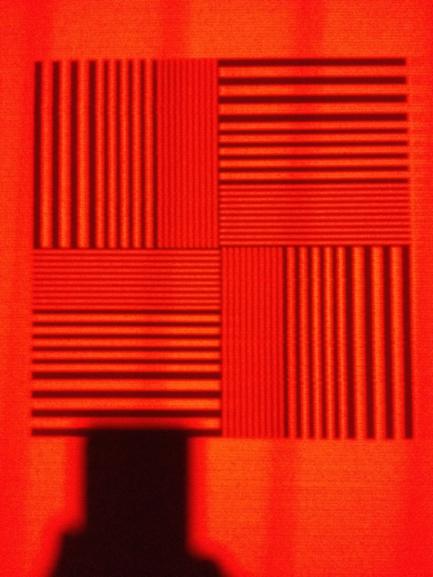

Two more pics but with peaking off. 720p@72. The diagonal waves come from the iphone there is some interference at 72Hz with the iphone that scrolls over the screen.

Posted: Sun Sep 14, 2014 9:17 am    Post subject:
Looks nicer, now there is just a hint of peaking on the red, and it dont seems like the extra peaking helps much anyway, other than just distort the image.
Now where did that new shaking noise come from.?
What pixel clock are you running here.? 90Mhz.?

I was thinking it should be possible to get a 800p@42 because it is almost the same bandwidth as 720p@72. I read that using very small porches the flickering should be not visible?
Also I have to check why red is better. Changing the neckboards etc. It is possible!
I will check on these numbers. I had a hard late night yesterday with trying to get Moome on non standard resolutions. The image was to small with very small porches so I made it the best I could by tweaking 5 pixels at a time in the porches. Took a long time and is not the right road Smile
I looked up the manual Moome says to adjust the phase with a button and store it in the memory.
Posted: Sun Sep 14, 2014 9:24 am    Post subject:
I guess its normal that the colors dont behave the same, specialy when there is peaking in play, so when you dont have the bandwidth to resolve the signal, and its peaked up, it will behave different depending how you drive the tube, thats why i asked you to always run contrast from 0 and up to see how it comes out of black.
If you have a high real bandwidth who just need a bit of peaking, its possible to match the peaking to each color and get a close to perfect out of black, and keep the color balance all the way from 0-100IRE.
I prefer a bit of roleoff over a shifting color balance.
Try shoot a pic of all 3 tubes with 25-50-75-100% contrast, and lets see how it behave with no extra peaking.
