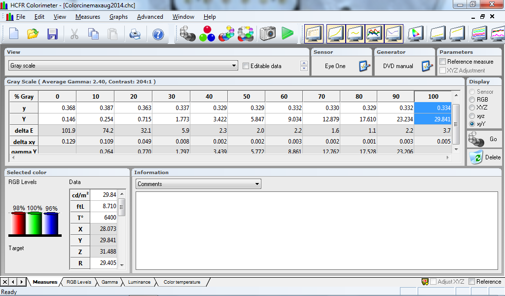

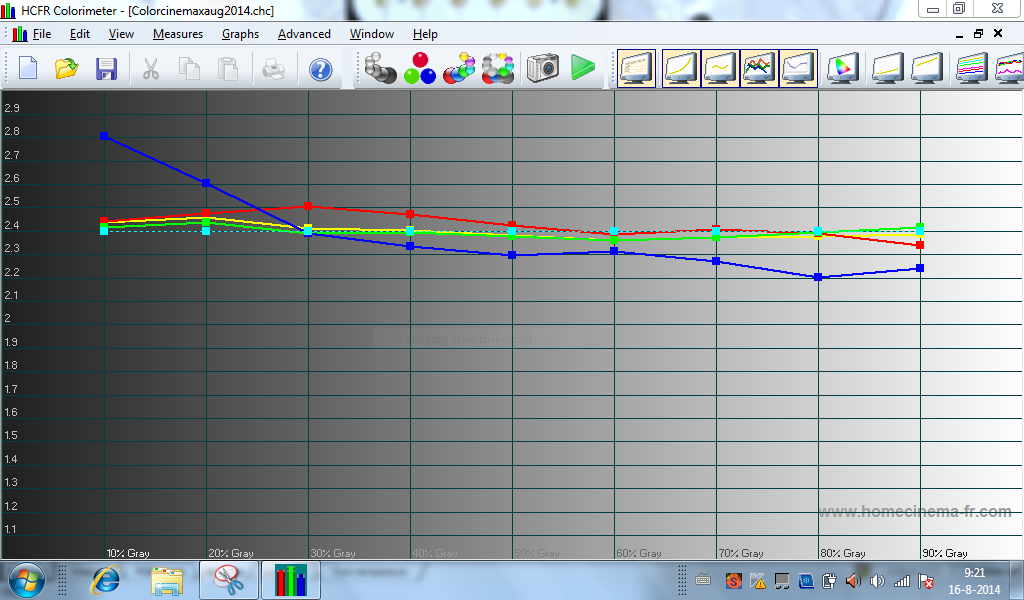

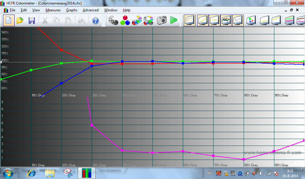

Posted: Mon Aug 25, 2014 6:00 pm    Post subject:
Can you post the data of that calibration, im also using a 100" screen.
redfox001
Joined: 16 Mar 2009
Posts: 2257
Posted: Mon Aug 25, 2014 6:08 pm    Post subject:
I see I was on 8,7 ftL. But I was low because of the 'streaking' issue. I had 11 ftL on 70 or so. I was now on 65 I think.

Posted: Mon Aug 25, 2014 6:14 pm    Post subject:

That calibration is noooooo goood.. A contrast 204:1 Thumbs Down
You need to have full atention to your low end.. all colors have to come perfect out of black, and you need to have a contrast that is higher than the HCFR can measure, think it maxes out around 25000:1

The contrast is bad because the low end is not measured with my i1pro. Below 30 ire I will need another meter.
There is a trick however and that is to make a small screen and place it close to the CRT than the light level will be enough to measure the low ire part. But I never did that yet.
Posted: Mon Aug 25, 2014 7:05 pm    Post subject:
What probe did you use.? I never had a probe so bad that i was not able to do a pertty decent 10% IRE, and by eye checking.
20% should not be a problem at all, maybe its not a reference measurement, but unless your reed time is very short, ill say it should display quite well whats going on.
In the old HCFR you can adjust the read time at low level, it takes some time, but it works quite well.
