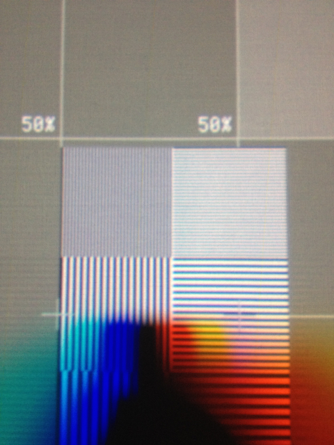

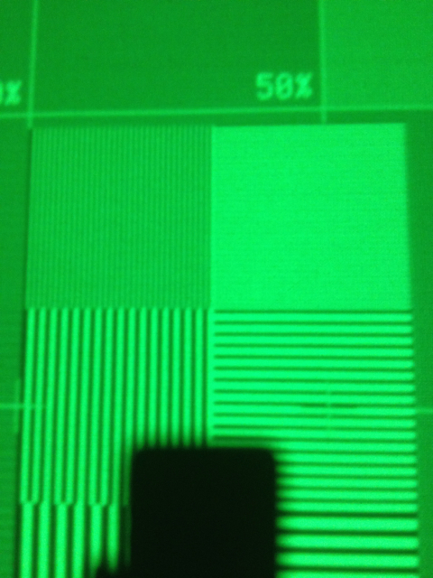

Hi there I replaced my 1,5m vga cable with a 30cm vga breakout cable and the result is sharper than it used to be. I have the idea that the shorter vga takes the max out of this solution. To be honest when I compare these bandwith pictures I do not see much improvement but it is very hard to see. But as I said the picture looked sharper. Smile Wanted to share this info Wink
My macbook is now placed on top of the Cine max Smile

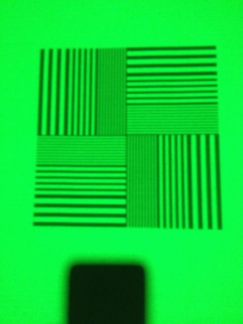

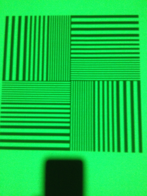

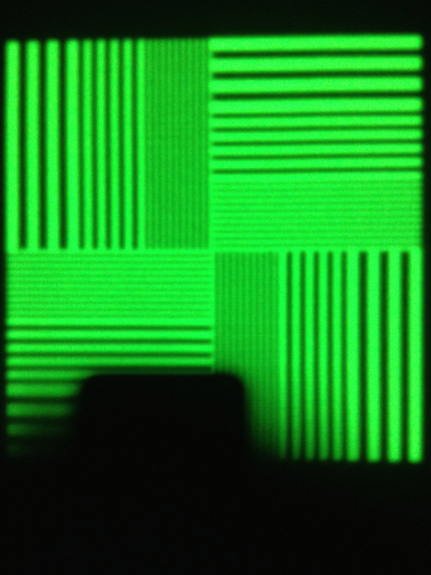

Ok for future reference and for fun here are 804p, 720p and 1080p picture showing bandwith. 720p seems to me resolved and 804p not totally at least less than the Eisemann/Moome modded barco from Francisco. I will evaluate some movies to get a feeling what a good resolved picture looks like on 720p. It seems that 804p and 1080p do not differ much in bandwith resolution.
1080p@60 148mHz
804p@60 114mHz (1920x804)
720p@60 64mHz
edit: was confused in the pictures Smile

Might be either that test pattern or the iphone, but im sure my 1-1 is alot sharper than that on RGB.

The setup was not perfect but it looked sharper than I had before so perhaps too the iphone a little? I am starting to dig into the zone adjustings but in the center that should not make a difference. But blue was defocused to get the gamma right, I have to look into that again.

Oh by the way I use a program from Nec to give the right pictures at different resolutions. Happened to be a nice program together with the nokia program.
Still I am learning on focus in all the zones and astig everywhere and I think that a skilled setupper could get more sharpness out of my Cine Max for sure!
Posted: Sun Aug 24, 2014 1:19 pm    Post subject:
Nice pattern.
Its clear that you will get a much sharper, dynamic and better contrast running the 720P 64Mhz resolution. As it seems to fit the bandwidth of your video chain.
Can you share that pattern with the rest of us.?
