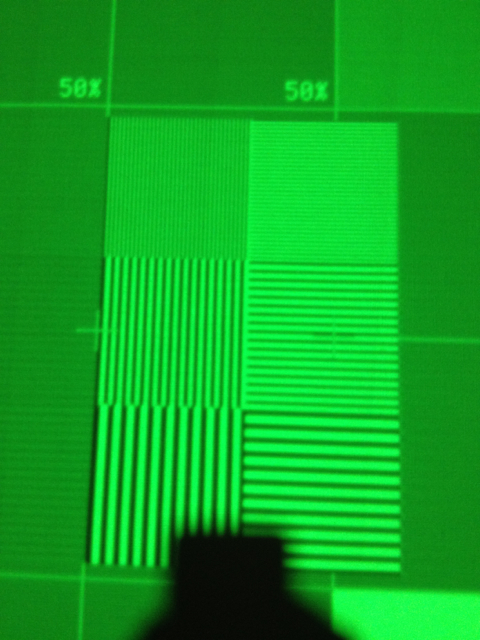

Posted: Mon Jun 23, 2014 8:46 pm    Post subject:
Did some testing with lower resolutions to see were the roll off is.
Chain is as mentioned in my earlier post, will also try with direct source attached to it. Will also try a modified moome RGB2 board soon as well.
Also these tests are with Eisemann mods and modified neck board.
To be honest on this test pattern SMPTE I even see vertical lines darker then horizontal and this is 720p only ! (no peaking)
In actual picture or movie all looks very good, sharpness is sublime, no picture noise anymore tubes fosfor is also very fine, also a lot of depth in the picture. Im curious about a side by side test with a modded marquee to see what "this lack of BW" will show in actual picture.
some photo's 720p@60hz

What pixel clock are you running..? around 75Mhz ill guess.?
Can you try run 720P 50hz.?

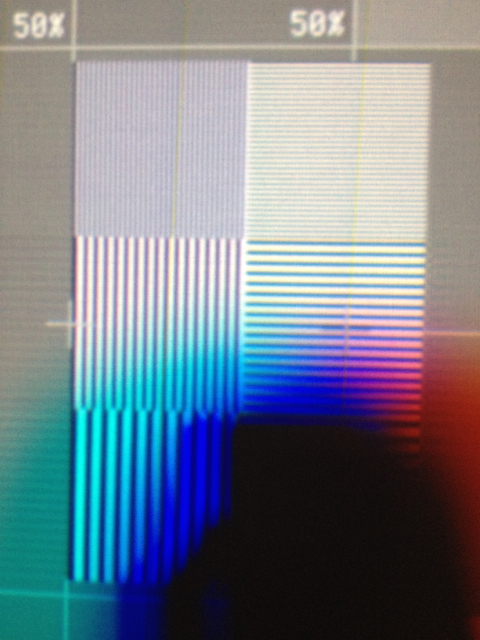

Posted: Mon Jun 23, 2014 9:27 pm    Post subject:
Also try run the Croma Multiburst at 1080P, it do more or less the same as the Croma zone plate, its just much easier to see whats going on.
It tells you how well you convert color space, and how well you resolve the colors.
It looks like this, and can be found on the Spears & Munsil Blu Ray.

Posted: Thu Jun 26, 2014 2:21 am    Post subject:

@strids here are some pictures of 720p@50hz, I can keep going lower but it doesn't change it still behaves the same.
Al taken with Iphone5 so don't judge on noise and grain.
720p@50hz

Posted: Thu Jun 26, 2014 4:36 pm    Post subject:
Is the croma multiburst also taken running 720P ?
You need to ask Greg if he cant get the bandwidth up to at least 75-100Mhz
Then you might benefit from using a bit of peaking.
I doubt that the bandwidth limitation running 720P 50Hz is in the projector, ill guess that the HDMI input has a problem.
Do you have a video processor you can run RGBHV out of, one who have a confirmed 165Mhz analog bandwidth, then you might try that, to find out where the biggest limitation is.

Posted: Fri Jul 04, 2014 8:34 am    Post subject:
@strids, yess multiburst was also taken in 720p. I found that limitations on BW are not entirely within the Barco as Redfox and Case also proved. I have done some testing with different custom made HDMI input boards and found that 1:1 attenuation is far better, not as good as the Marquee but certainly comparable with Sony G90 judged and compared by our Iphone pictures.
This was without the Eisemann modifications, so original 800mhz video chain of barco. I'm talking to Greg to see if we can combine things, best input board with eisemann's modifications on video chain.
What I clearly can see is when I compare original boards with greg's that sharpness and picture noise are far less than with the modified boards. But I think the HD fury is not holding the max BW, and limiting the video chain too much.
