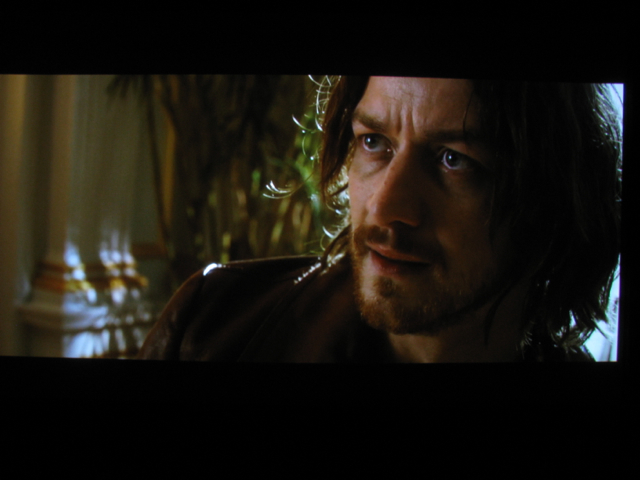

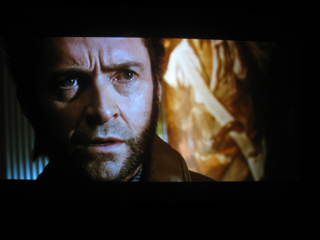

Don't know if it shows on these screenshots but I made a 48Hz resolution with no flicker at all, simple not visible. It looked sharper to my eyes much more background. Also these pictures use the internal Moome through port 3 on my switcher with high bandwidth buffer and Mike Parker boards that hold this resolution very nice. Not perfect but I don't think this resolution can be much improved on. The 1080p resolution is very bad though but that is largely because this Moome is not so good at 1080p. The VGA was clearly better but the same on lower resolutions. The video dac of this Moome has its -3db at 90MHz. I even tried bypassing the complete buffer but still bad.

Here are a couple I just took, from the PC HDMI to the Harman/Kardon AVR to the MOOME V3 EXT to PORT 3, 1920x1080p at 60Hz standard timings.
