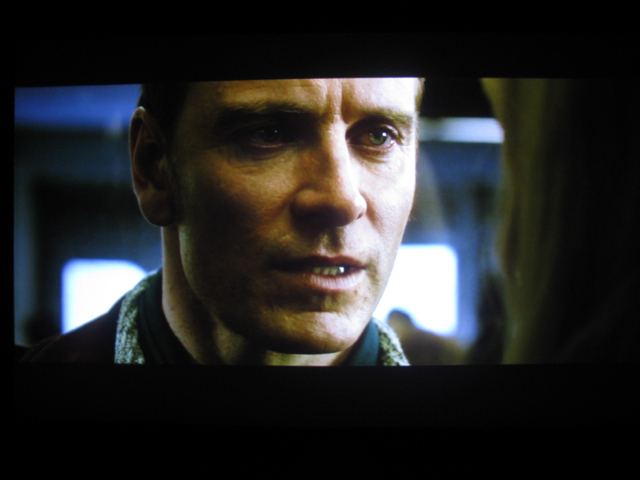

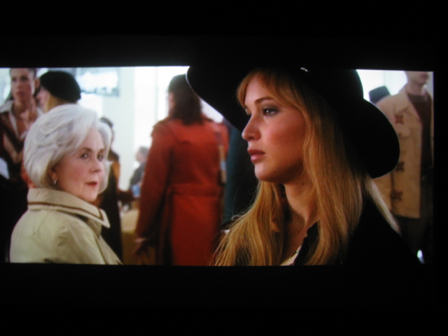

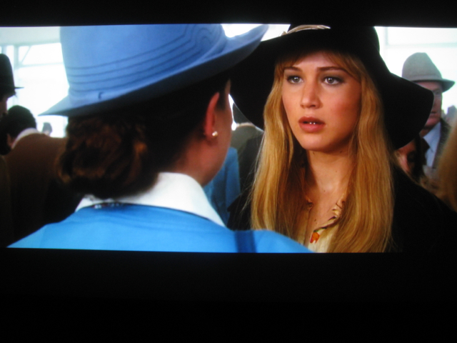

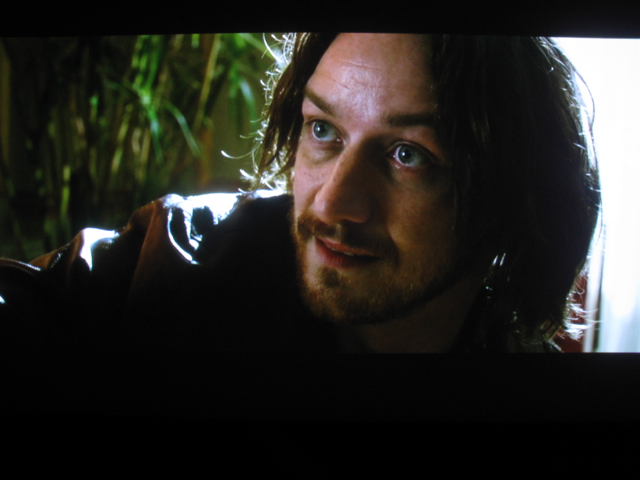

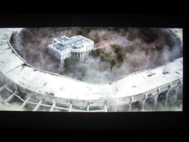

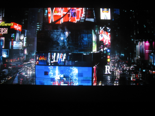

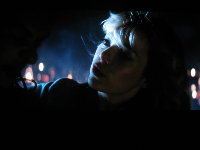

Few screenshots. Have to get the camera better fixed.

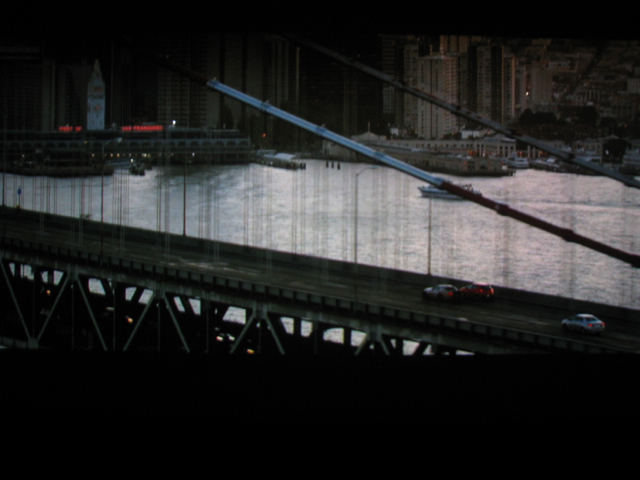

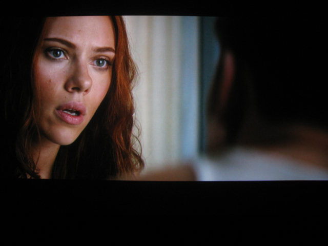

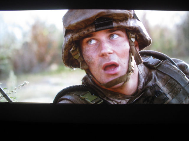

Some more.
