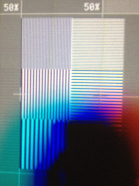

Ok, I do see scanlines Very Happy
It is a lot sharper especially text is a lot better to read, the characters are blacker.
It is visible in the testimage.
see below.
However there is also some kind of background jitter when contrast and brightness are on zero, the raster is flickering and there are lines. Could this be something with sync is it normal perhaps?

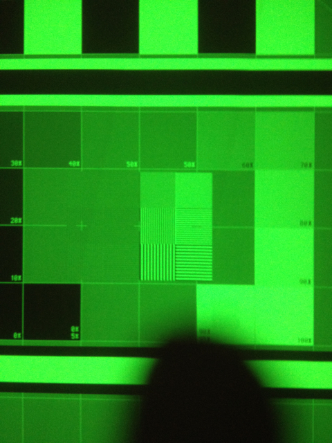

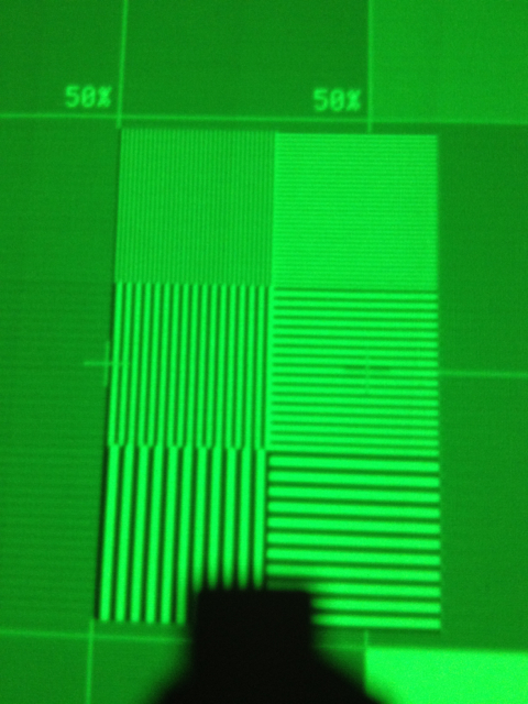

Posted: Fri Jul 04, 2014 7:37 am    Post subject:
Do that pic with just the green.
redfox001
Joined: 16 Mar 2009
Posts: 2257
Posted: Fri Jul 04, 2014 2:21 pm    Post subject:
Just green.
Also I removed the ferrite bead and a new T-connector and it seems there is less noise looking in the tube with zero brightness and contrast. Overall the noise is not better or worse than with the internal is my feeling but I found the internal full of mosquitos.
