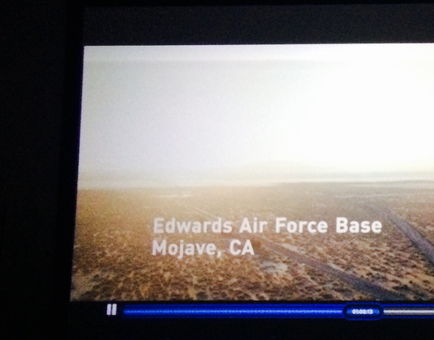

I had the same problem. I solved it with changing smps. so I tought problem was smps. but faulty smps works fine in another cine9. strangly there was a good combination between smps and quadrupler. I could see the line in high contrast scene. when I downed contrast under 50, lines disappeared. I think it's HV arc near quadrupler.

redfox001 wrote:
CasetheCorvetteman wrote:
There is controls for that, its in the picture menu, select custom instead of one of the preset kelvins.
Oh man I selected 6500K and indeed there is custom so that is the trick thanks!
By the way the picture is still amazing I think the effect mentioned earlier must have something to do with gamma because it is less now.
Just two shots with the phone.
Tell me, does your set squeal from around the area of the quad? Mine did, and i get simular lines top and bottom, more so top, and if you bring up the crosshatch convergence pattern, it had a very slight waving in some areas.

Mine too. but there was no waving. after changing smps, black line's gone, sequealing's gone.
Yes that certainly is the same thing in the image. I will check if contrast has an influence. Strange thing was the line disappeared spontaneous one time while pauzing.
Perhaps unrelated but I have other strange things going on. When I was doing astig in the menu and I had green defocussed with the sharpness button than I went to blue and defocused blue and the whole menu seemed to disappear the picture tha. Became black and resetting sharpness everything returned after some time. The same thing happened in the gamma menu while maxing some setting. It happened to me on blue sharpness several times. I thought it might be software bugs but I am getting a little woried the Max is behaving strange.

Made a new picture of the same scene. It is almost gone by changing the gamma. But in some other scenes it is still very visible.
I tried the EHT board and that was not it. Will try the quad but the quad does not make any sound.

But it did not fix the problem. However I finally found the right menu and did a greyscale and after that it became much less visible. I am not sure why. Perhaps differences in light do not produce differences in color anymore?

different gamma makes different overall light output.
I think this makes noise line less visible.
I had same experience when I adjusted moome gamma control.

Well I also checked if contrast had an influence and it seemed that it did not get worse with higher contrast. At 50 it was the most visible.
But I guess my peaking light output is way to low at 70 contrast with new tubes. So this all seems to suggest that the SMPS is not providing enough power?
