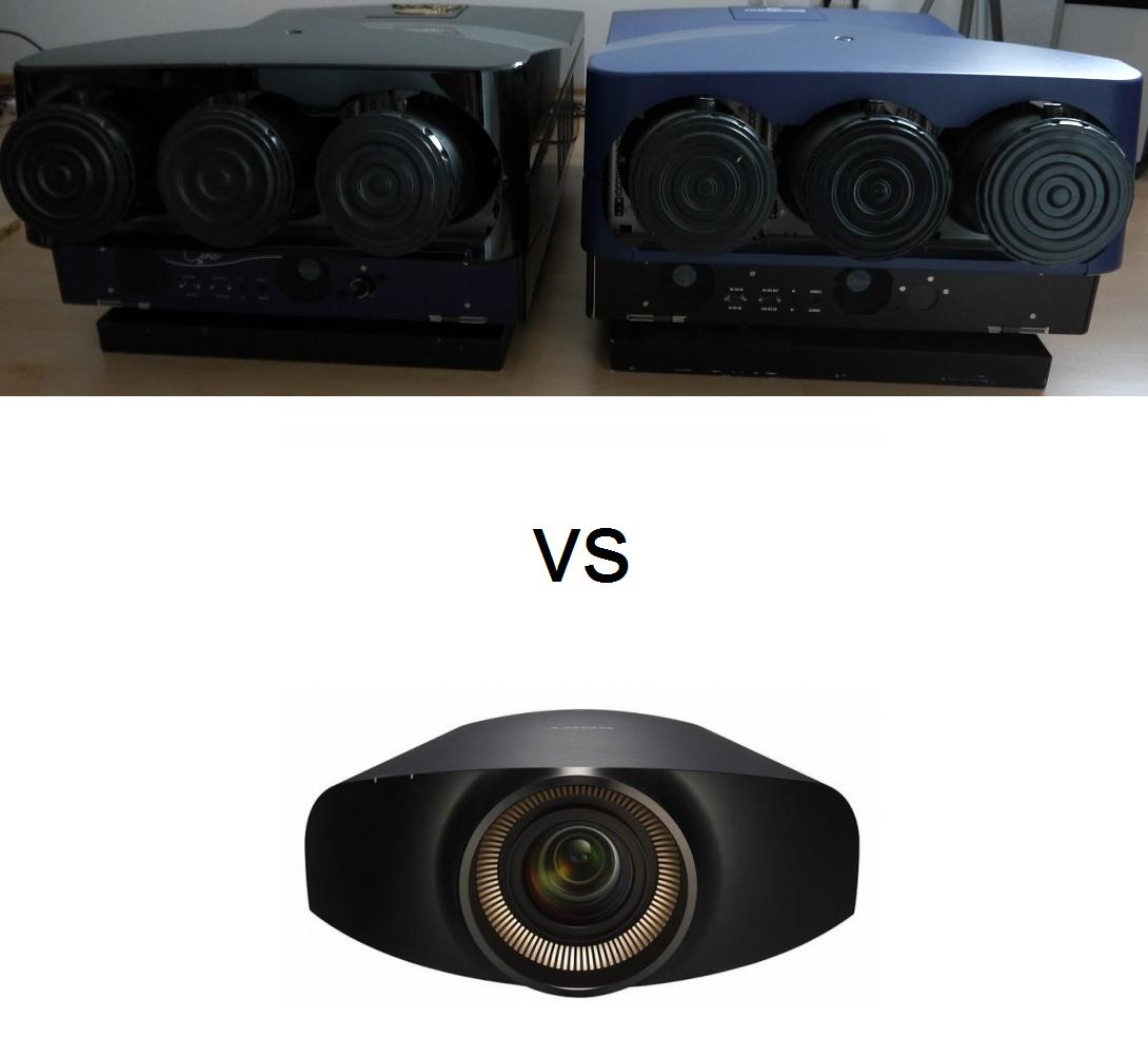

 Viewed:  4807 Time(s)
Barco Cine 9 the one and only

I'd rather take the Barcos, the whole 3200x1360 (2:35:1 AR) brings the resolution to near 4K, I honestly have no idea what the Barco would look like at that resolution, but I imagine if it can resolve it, that it looks pretty damn good.

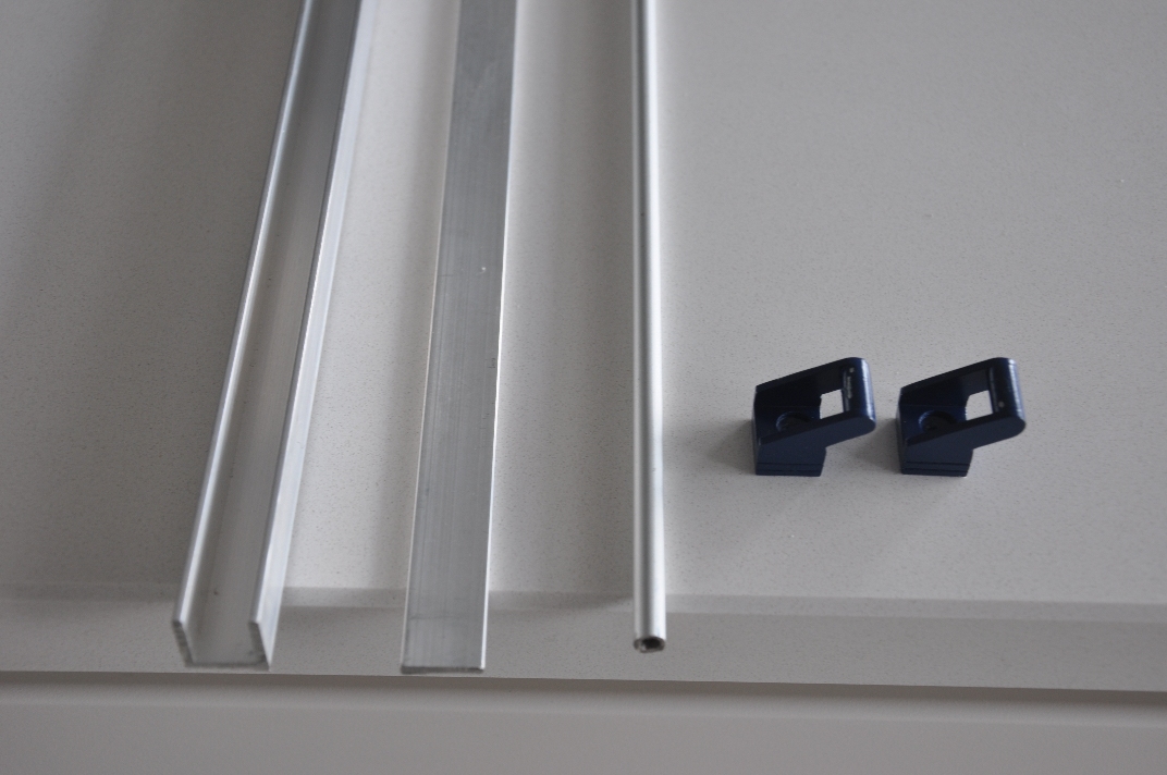

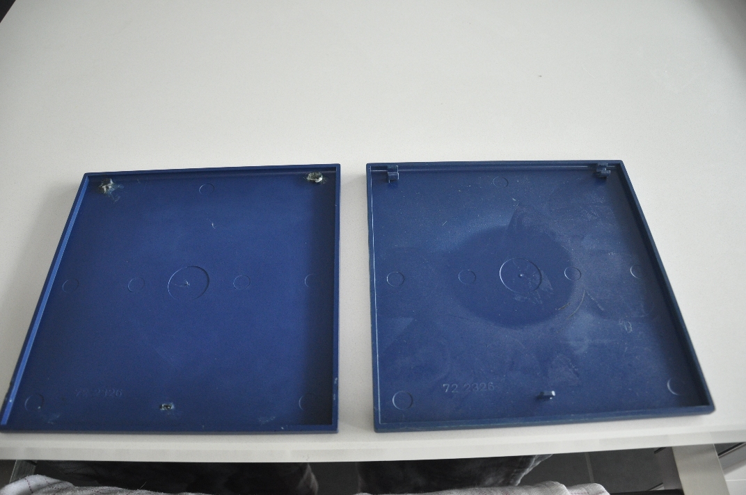

Unlike 7 and 8 series Barco's, where they are part of the cover, those hinges are used in Cine Max/9 and BR909 only. Small chances they are aviable.
My BR909 came also with broken hinges and on the remote cover, the clamping "ears" and pin were missing too.
I just took a remote door from an old 708 ( they are identical on all 7, 8 and 9 series ) and painted Barco-blue and i made the hinges from aluminium ( a U shape, a flat stripe and a tube ). Also a bit of paint and this was the result:
