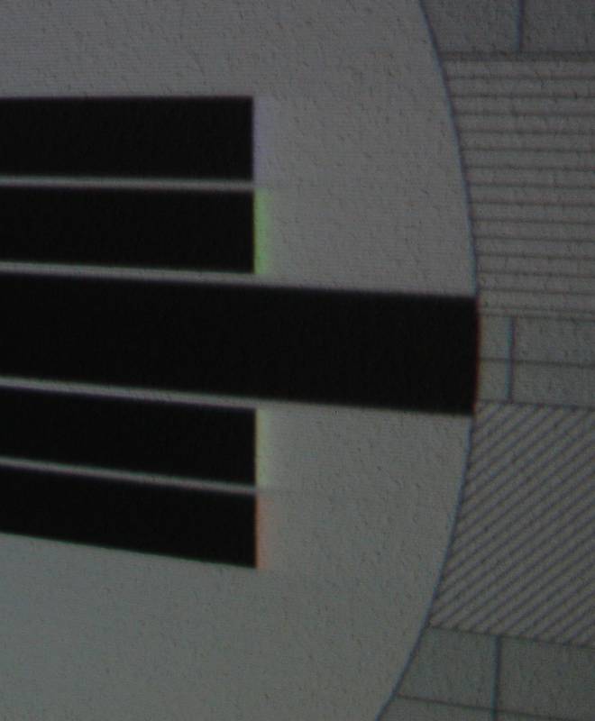

As some of you already know I was all in for extending the bandwidth of my PG xtra, as I thought it can be made better, and all along the reference was the NEC XG design in the improvement. Now I have a top XG so was quite curious how is the XG doing the bandwidth thing. The result is quite amazing, so to say unbeliveable, to be short: CRAP
So far this XG doesn't show any evidence to it is able to handle high bandwidth. While the circuit design is considered superior to what is in the PG xtra.
Here are some pictures:
NEC PG xtra @ 1280x720-120Hz
NEC XG1351 @ 1280x720-120Hz

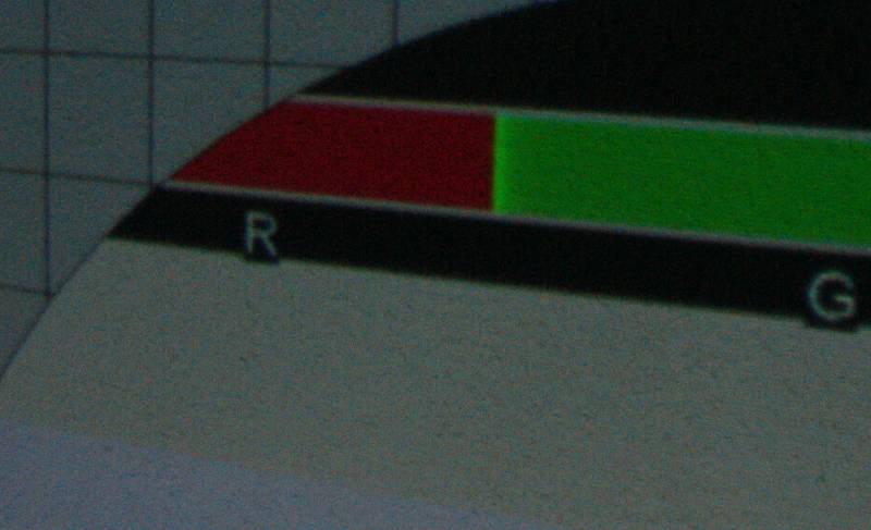

But this is only one thing, I have some bad kind of signal peaking on hard edges, and some kind of streaking as well, and none of these are dependant from signal timings.
At this point am not sure if there is some problem with the machine or this is what it can really do...
peaking issue 2 (intentionally dark exposition)

Thats not normal in the slightest Gàbor. Mine doesnt do anything like that and its only an 852.
Posted: Mon Feb 24, 2014 10:37 am    Post subject:
The fact its not dependant on signal timings should illustrate the fact youve got issues there. Id be opening it up and doing abit of surgery.

if it wasn't you then I 'd suppose to check astig, focus, white balance and probably reduce contrast. Maybe you have a bad ground connection on your BNC plugs (try wiggle it) but your picture doesn't look like typipical ghosting.
Can't believe this is typical for the xg though. Any pics of red and blue and higher resolutions?

So, took some measurements. I measured 5ns rise time on the output of the CRT amplifier (Cathode), this equals to 70MHz overal bandwidth. Not great, but we have very little knowledge about real bandwidth of the machines anyway. Tomorrow will repeat this measurement on the PG xtra -which is fortunately still hanging around Smile
I measured the output of the GAIN CTL, however I not consider this to a valid measurement (got very bad rise times), but it was clear that there wasn't bandwidth loss at on/off pixels.

-The source signal path is the same what was with the PG xtra, only the projector have changed, so the problem is with the projector.
-The signal inside the projector goes: BNC input on the Video motherboard ->GAIN CTL->Neckboards->CRTs
-The problem is presented the same way on all tubes. With pure speculation I find it highly unlikely to have exactly the same problem on each CRT or neckboard, while no one else had a similar problem as it turned out, so clearly there is a problem somewhere.
So this leave the GAIN CTL and the Video motherboard as a suspect.
I should check out the DVI input card, how it goes (this also would rule out most of the V-motheroard) but I don't have a DVI cable, and don't know what should expect from the moome board anyway as this is a first gen. DVI/component card.
I am not able to take valid measurements, wherever I take measurements in the projector (with the absolute shortest ground wires) it starts from about 3-4ns rise time with all kinds of oscillations on it, while I am able to check that the input signal is rising under 2ns, and has an acceptable shape.
Once cheap XG parts come by I'll buy one of each boards that are in the signal path to check what's going on, until that I'll have to live with this Thumbs Down
BTW just figured out that the "aperture level" in the info menu sets the signal peaking, too bad it only can make the picture worse, at 1080i-96Hz only level 0-1 looks acceptable.
