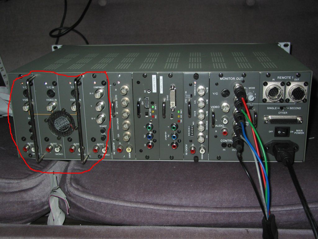

Posted: Sun Feb 09, 2014 9:34 pm    Post subject:
Do you have the line doubler module installed?

No, never seen one of those before.
Posted: Sun Feb 09, 2014 10:36 pm    Post subject:
IN short, I don't think you can. What you'll need to do is get an external line doubler or scaler to convert the composite to RGBHV, and then feed the output of the line doubler to an RGB input of the switcher.
