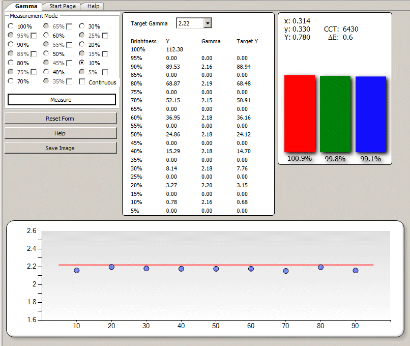

Posted: Sun Mar 22, 2015 9:06 pm    Post subject:
I can not se the redline in gamma(chromapure 2.5.7) i see only bleu circles.
My os is windos 7 how can i fix this?

Posted: Mon Mar 23, 2015 12:01 am    Post subject:
European users need to set the PC to use periods for a decimal points and commas for list separators.
In Windows 7 you do this in Control Panel, Region and Language, Additional Settings
Select a period "." for the Decimal Symbol
Select a comma "," for List Separator
In Windows XP the path is Control Panel, Regional and Language Options, Customize.
In Windows 8 the path is Control Panel, Region, Additional Settings.
Make the same changes as listed above.
You can always set these back to the regional default when finished with the session.
