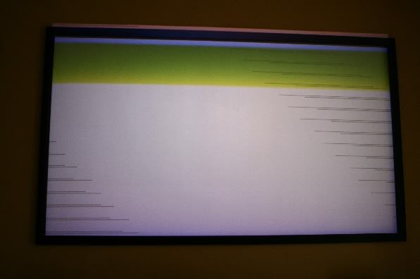

Posted: Sun Jan 12, 2014 10:58 pm    Post subject:
Hi guys
Been away for a while but see that this has generated some interesting theories. I have not fiddled with scheimfplug but have gone through the astig getting round rings with dots centred and such.
I want my old 8500 back..... new issue developed since I last checked and asked about the sharpness. There are now horizontal lines on the image (all three tubes) like -_ -_
-- -__ if this makes sense. I think someone had this issue back in the days of AVS I just don't remember but guess its in the CLM or not, maybe just needs a good once over with some compressed air or something.
I'm getting dejected and cannot even sit down with a good (or any) movie these days what with all the winter storms preventing outside activity. Oh well ...
All that glitters is not gold thats why I prefer red, green and blue.
Posted: Mon Jan 13, 2014 5:33 pm    Post subject:
compressed air won't fix anything. You need to send any suspect modules to someone to test in a working chassis. If your seeing this, it's a control module problem. Usually repairable by re-conditioning the board with fresh parts, or replacing the control module outright.
I know it's frustrating when the machine isn't working properly, but it's totally fixable. It's also really frustrating to spend the money go from an 8 inch to 9 inch and have the picture quality and performance go down, but your not the first person I talked to who wound up in this situation. 2 or 3 people I know personally went from a tightly dialed in 8500 to a flaky 9500 and reported both picture dimming and lose of focus, it really depends on the chassis and what condition the boards are in.
Can't help but wonder if this is really a low hour machine or a machine someone re-set the hour counter on after replacing the tubes?

Posted: Mon Jan 13, 2014 11:41 pm    Post subject: hours
Actually I think you are one hundred percent right on that one...I think they must have been reset because its highly unlikely such a modded machine would be sold after 500+ hrs. I will check the menus and see what lies beneath....

Posted: Tue Jan 14, 2014 3:34 am    Post subject:
pull U7 on the DPB. Actually pull all sockets chips on the CLM and the DPB and clean them and use Caig cleaner and protectant on the chips and associated sockets.
Should fix it.
crt nuts
Joined: 19 Sep 2008
Posts: 58
Location: Wellesley
Posted: Wed Jan 15, 2014 12:34 am    Post subject:
Should fix it.
Thanks Athanasios I actually used some Contact Ol (electrical contact cleaner last night. Just pulled the two boards off and noticed some oxidation on the pins. Have not powered back up yet because I want to make sure it is dry first. Going to try a bit later (fingers crossed) else I will need to get a new clm.
Mark G
Posted: Wed Jan 15, 2014 1:08 am    Post subject:
hope it works but to really get the issue resolved you need an ic chip puller and do every chip on clm.
And Caig is the best for cleaning and I use Stabilant22 for conditioning after.
