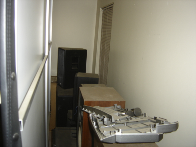

Posted: Mon Nov 11, 2013 1:06 am    Post subject:
A shot behind the screen...very dusty, I haven't been back there in 10 years.
 Filesize:  126.55 KB
 Viewed:  18302 Time(s)

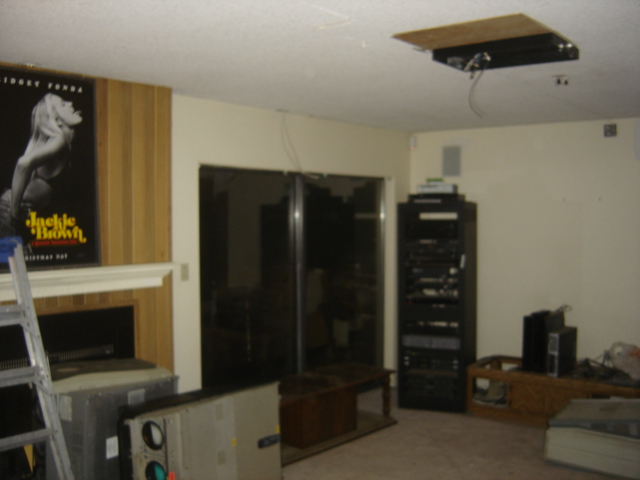

Posted: Mon Nov 11, 2013 1:07 am    Post subject:
Ceiling view (turned sideways, showing that section we cut out of the drywall. I have no need to run more cables front to back save for 2 HDMI cables that didn't exist 12 years ago when we installed this originally. Barco 909 bracket in clear view..
 Filesize:  127.13 KB
 Viewed:  18300 Time(s)

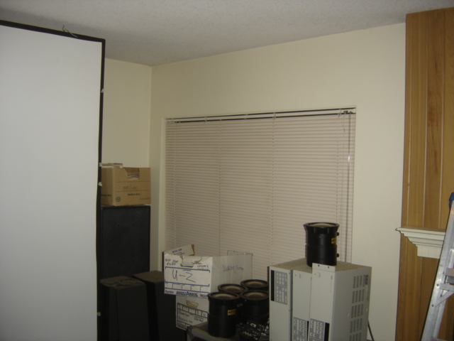

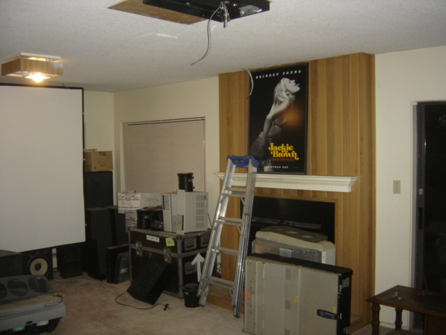

Posted: Mon Nov 11, 2013 1:08 am    Post subject:
To the right a bit more, showing the full window on the front right, and the wood paneling of the fireplace to the right of the window.
 Filesize:  126.2 KB
 Viewed:  18299 Time(s)
Posted: Mon Nov 11, 2013 1:10 am    Post subject:
More or less most of the right side wall. Fireplace in full view, the GE Talaria projector to the left of it. Rolling Eyes
 Filesize:  163.66 KB
 Viewed:  18298 Time(s)
Posted: Mon Nov 11, 2013 1:11 am    Post subject:
Back of the right side wall, sliding patio door to under my deck. Rack shown is the HT rack.
 Filesize:  139.82 KB
 Viewed:  18297 Time(s)

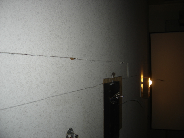

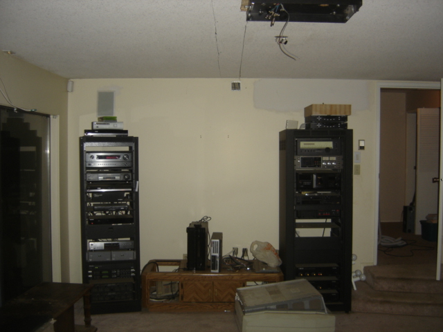

Posted: Mon Nov 11, 2013 1:13 am    Post subject:
Back wall. Note only one in wall speaker, as we never cut the second one in, as we had a good part of the wall open to run wiring to the right rack, which is the multiroom rack that powers the house. Both the HT and multiroom rack need to be rebuilt, as the sources are... outdated.
note that the two racks are slightly different in height from one another. They were surplus, go figure. Also notice the two steps coming down from the bottom landing into the HT room.
 Filesize:  146.37 KB
 Viewed:  18296 Time(s)

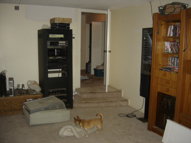

Posted: Mon Nov 11, 2013 1:14 am    Post subject:
Entrance to theater. Dog is a crucial part of the sound absorption.

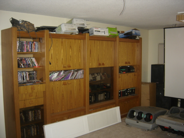

Massive teak wall unit that houses a crapload of VHS tapes.. .and a few DVDs. It comes apart in sections, and has nice backlighting to it, that I want to wire to a Lutron 6 channel dimmer.

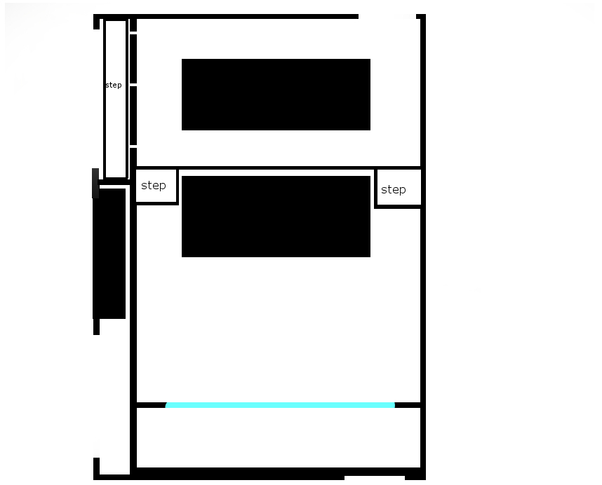

Posted: Mon Nov 11, 2013 1:31 am    Post subject:
So, my thoughts:
1) I need to do this on a very tight budget, as the last 6 months have been kinda slow.
2) My thinking is first to pull a wall in where the current screen is, allowing for a 16:9 cutout for a 10' wide screen. It won't be a wall per se, as I'll cover the area around the screen with sound absorbing panels. I'll want them to come off to access the area behind the screen.
3) I will probably use a drywall screen for now, which will be taken out when I can afford the acoustically transparent screen down the road.
4) I was going to cover the ceiling and walls with DIY sound absorbing panels, but then my buddy suggested removing the ceiling drywall almost completely for a few reasons:
a) It will expose the whole ceiling for wiring now and later
b) it will allow direct access to the existing insulation up there, and will thus simplify the construction of the 2X4 sound absorbing panels. We can stuff the ceiling with insulation galore, deadening the room.
c) The DIY sound panels will cover the ceiling completely, hiding the lack of drywall on the ceiling.
d) It will allow me to make changes to where the 3/4" plywood will be for the projector(s),
5) Put up more 3/4 ply to accommodate the larger screen and stacked 919 projectors.
6) Leave the teak wall unit and fireplace as is for now, but put more DIY panels all around them for more deadening.
BTW, speakers will be 1 3X12" tannoy sub located to the right of the centre channel speaker. LCR are matched EAW 12" 2 ways,. Surrounds are yet to be determined, but I've got assorted speakers around. None are dipole though.
7) Add more power to the room (cabling is already run) as the whole room is running off 1 15 amp outlet. I'm allowing for 2 20 amp circuits to the HT amp rack, and the projectors will most likely run off that as well, one projector per circuit.
8) eventually I'd like to enlarge the steps coming into the HT so that the racks are level with the top step, then 1 row of probably 3 seats, then the other row of 3 seats is at ground level. For now, I'll have to go out and get a couch though, or maybe if things go well, 3 seats for 1 row on the floor.
Ideas, comments?
Also, I'll be running two HDMI cables up through the ceiling since all I've got right now is a single RGB run, but will most likely use one Moome external box, going to an RGB splitter, then out to the projectors.
Posted: Mon Nov 11, 2013 2:40 pm    Post subject:
You probably don't want to hear this, but you should move the teak unit out of the room. It is taking up way to much space especially if you want to go 10 feet wide in a 14 foot wide room.
Posted: Mon Nov 11, 2013 2:43 pm    Post subject:
Yeah, been debating about that. It's modular and could tentatively go in the living room. I'll leave it for now, but it's not out of the question getting rid of it.

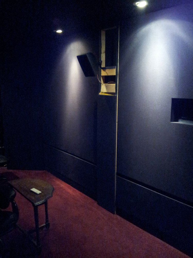

Posted: Sun Nov 17, 2013 4:07 pm    Post subject:
Pretty nice space to work with... Smile
I'd narrow the room.
Frame out the windows, fireplace, and sliding doors. Take the teak
I wouldn't be stripping the ceiling of much drywall, since there's now a side wall
from the back wall to the AT space. Conduit could carry cabling front to back.
The plywood backing for the projectors would be cut out, and I'd simply repair the
drywall there.
I'd use black speaker grill fabric for all the walls. A friend does this, and it looks
great. And you can do some acoustical treatment behind the cloth panels.
+1 to a full width riser, at entry level. But fill it with insulation and cut in some
vents in the rear corners, to create a full range bass absorber.
 Filesize:  100.15 KB
 Viewed:  18123 Time(s)
 Filesize:  38.13 KB
