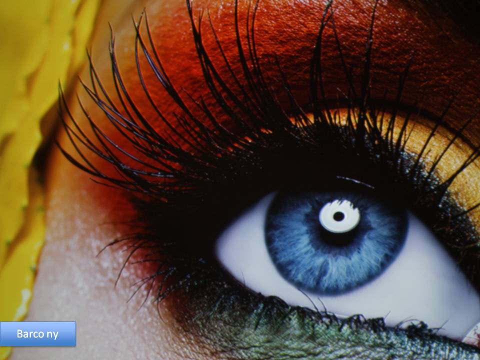

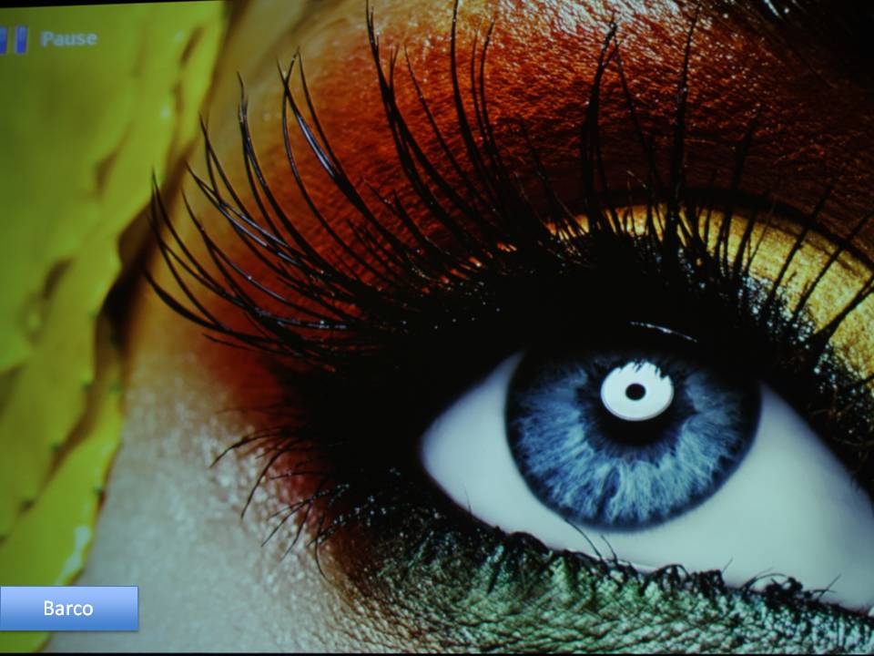

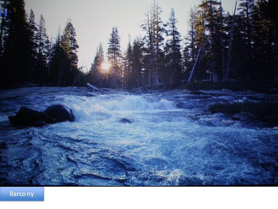

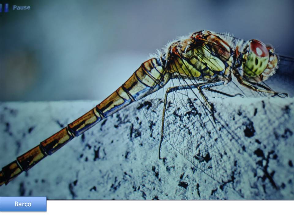

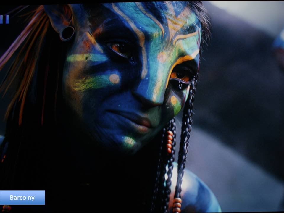

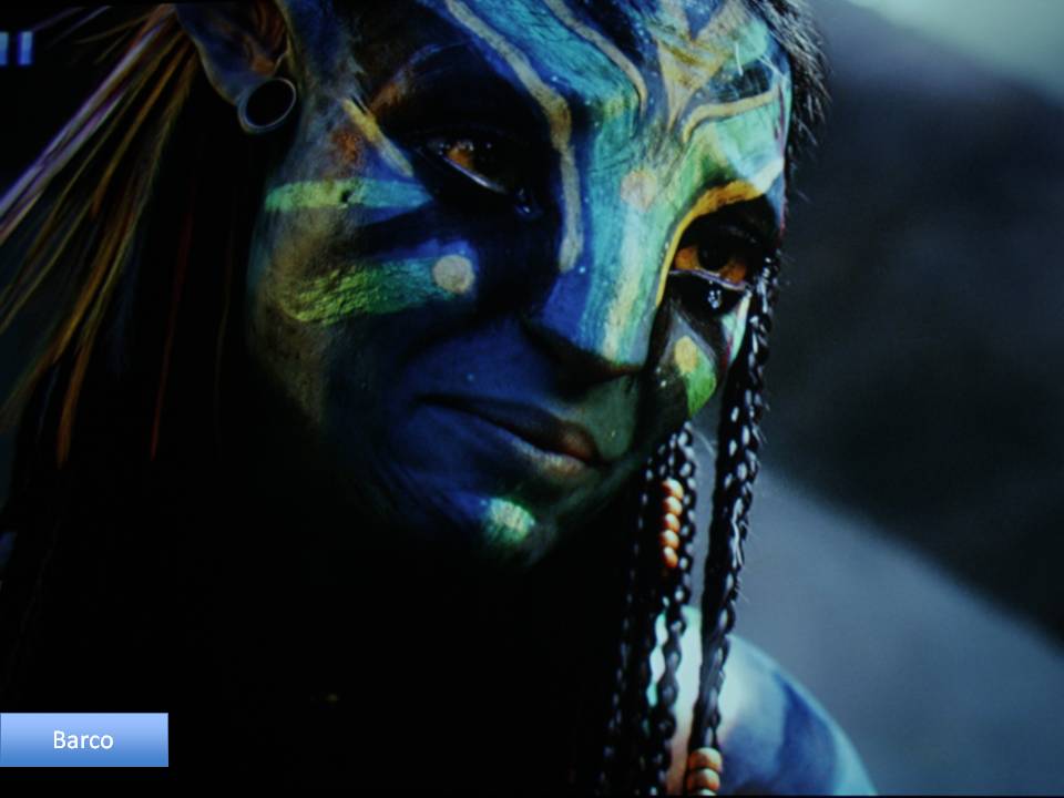

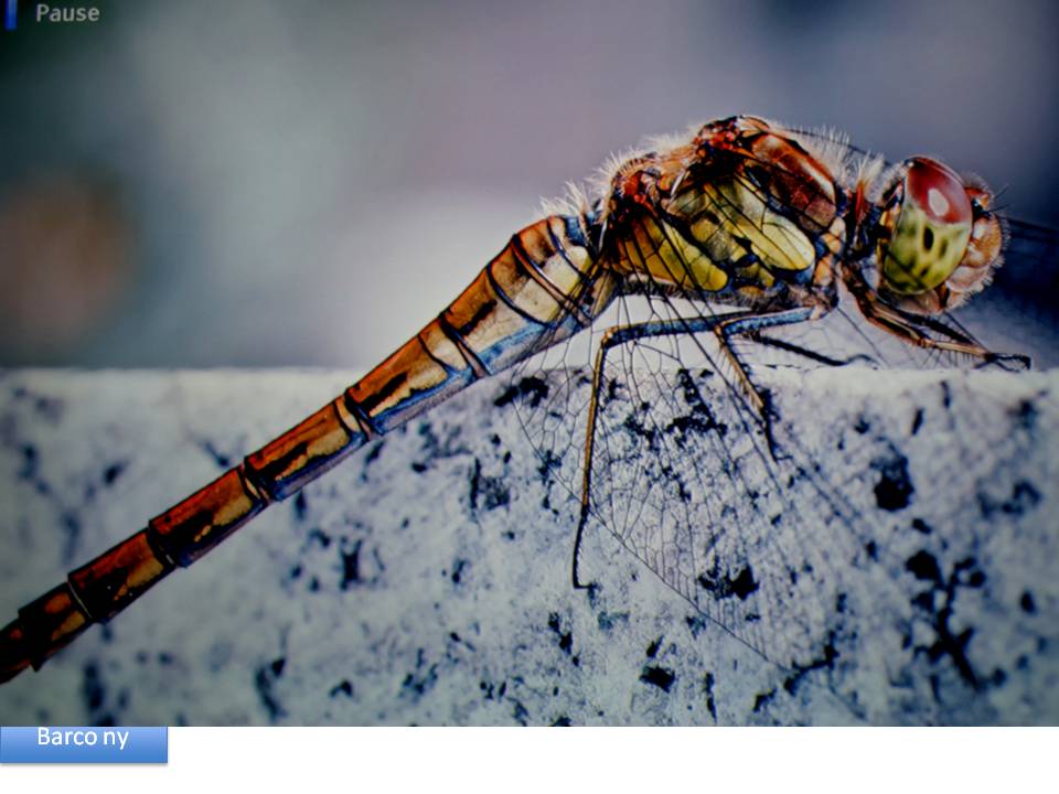

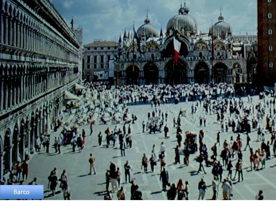

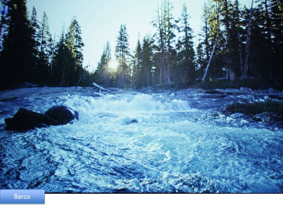

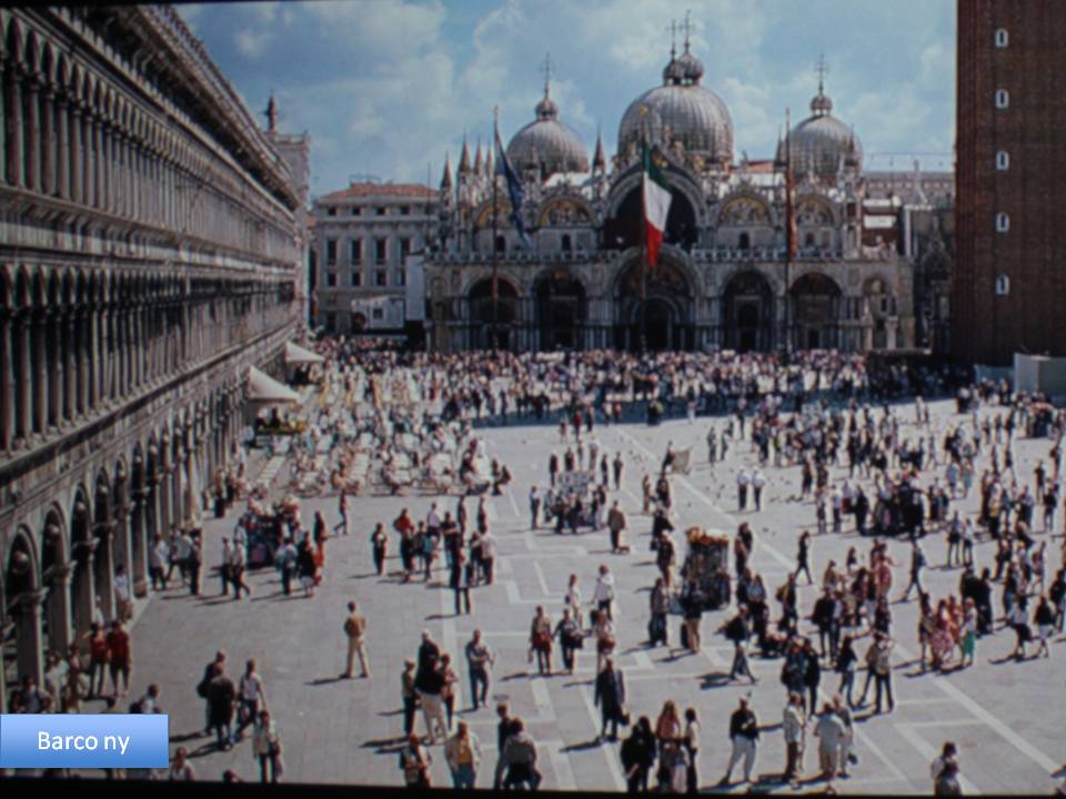

Here is a illustration of the improvements.
Picture taken by same camera Canon Eos 1000D form 2,6m and with same shutter time 0,8 sec. and blend 5,6 and white level on camera on manual.
Barco new is with the inserted card mod 2, with mod card nr 3 its some better blacks in pictures.
Picture named Barco is form last time and Barco NY is the newest.
This is the same test like before, but now the improvements.
All pictures are downscaled so noise can appear that is not there.
Also remember, that pictures look not so fresh like they do in real, this because of camera adjustments.
But just to see improvements and differences.

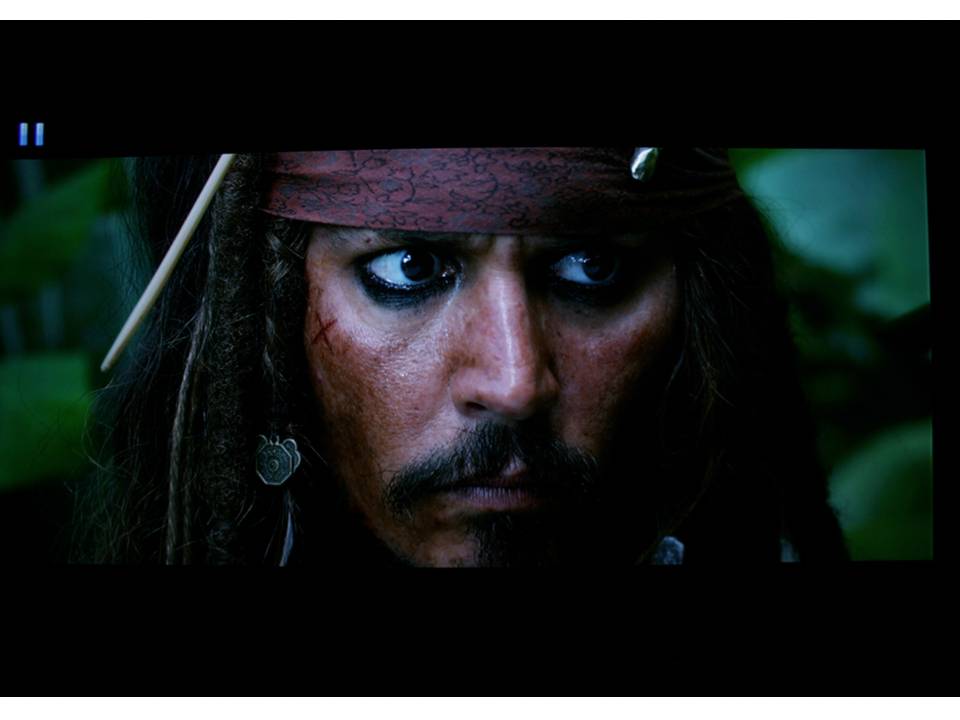

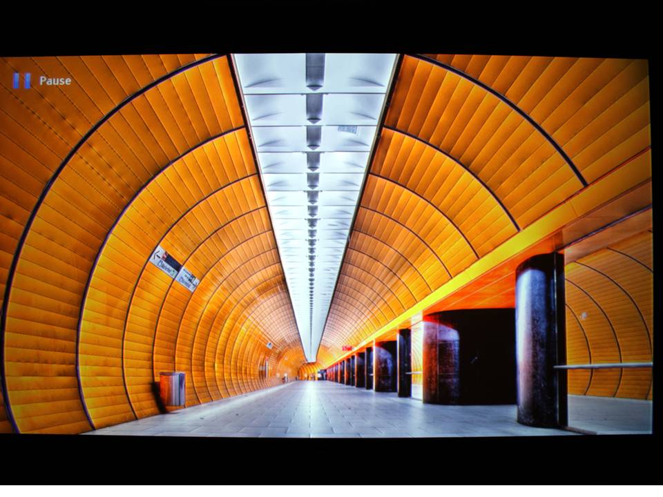

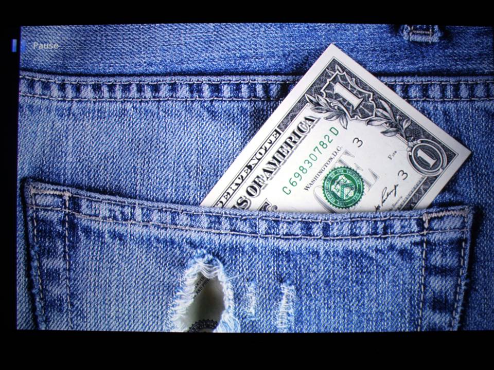

Here to show some pictures taken with camera on auto, just to show that things look better with this setting.
Then is the white level on the camera automatic, and makes differences more difficult to see. This is why its meaningless to have a screenshot war.
But looks dam good Smile
remember here Barco 808G

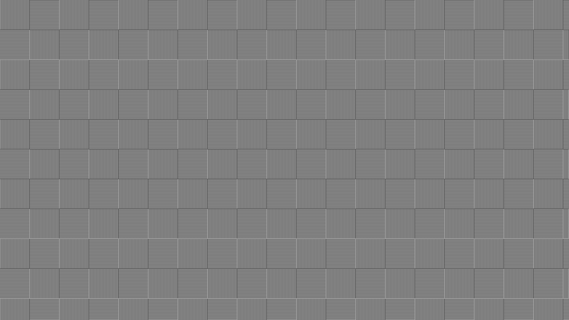

Do you have the pattern used in the screenshots?
Diddern
Joined: 02 Jun 2013
Posts: 821
Location: Norway
Posted: Mon Dec 23, 2013 10:59 am    Post subject:
I fix
Got this form Stridsvognen
