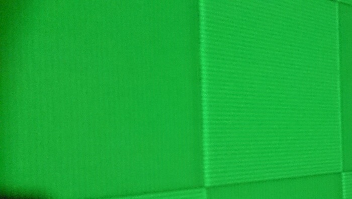

Posted: Sun Dec 22, 2013 3:01 pm    Post subject:
stridsvognen wrote:
Remember to take some before and after mod screenshots of the 1:1 pixel pattern, so we can se how it resolves 1080P 60-72hz.
Picture 1920x1080 60Hz
Pictures are downscaled...
before
 Filesize:  53.13 KB
 Viewed:  6096 Time(s)
After with new mods
 Filename:  desk.jpg
 Filesize:  177.97 KB
 Downloaded:  379 Time(s)
Posted: Sun Dec 22, 2013 3:41 pm    Post subject:
Diddern wrote:
The focus is better, but the bandwidth is still crap...
Posted: Sun Dec 22, 2013 3:46 pm    Post subject:
gjaky wrote:
Diddern wrote:
+1

At least it looks better than a standard 9" CRT projector captured with a IPAD. Right.?
Clearly better bandwitch on the marquee. As the pictures show.
Diddern
Joined: 02 Jun 2013
Posts: 821
Location: Norway
Posted: Sun Dec 22, 2013 4:54 pm    Post subject:
What do you feel about sharpness from the picture?
It's a 8 inch
Posted: Sun Dec 22, 2013 5:00 pm    Post subject:
Diddern wrote:
I have a VIM with peaking trimpots, who are adjusted to match the horisontal level, the Barco looks to have much much more peaking without getting cloce to get a decent vertical level, it also looks like it skips the first vertical line, and role off the last 2 vertical lines.. no idea what goes on there.
Posted: Sun Dec 22, 2013 5:06 pm    Post subject:
Diddern wrote:
It's a 8 inch
As you have told me before screenshots are useless.
But it looks like your picture capture the sharpness much better than mine, your horisontal lines look more like what i see on the screen than what my pictures display.
I dont like to coment on sharpness on your screenshots, i see some of them have lots of edge ringing like there is some sharpness addet in the camera or wherever it come from.
I must say i would expect more if its LUG tubes used.
I also have no clue what light output you got, or other calibration data.
I just know that the Marquee looks quite soft in standard trim.

stridsvognen wrote:
Diddern wrote:
It's a 8 inch
right about the pictures just indication.
and pictures downscaled to fit this forum
but like i said better bandw. on your picture, like your photo show.
better sharpness and better blacks on the 808. but again pictures.
maybe different in real.
If you compare a original 808 in real its enormous differences.
