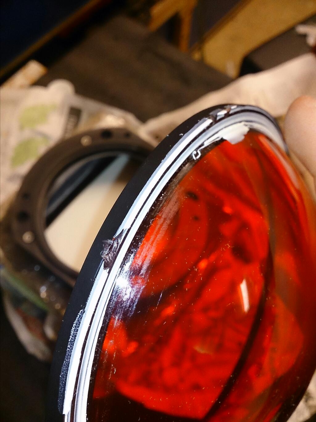

Ready to fill it with glycol. Over to the next problem - will the broken seal on the C-element be able to hold tight despite this crack/chip and two more at the top in the image?
Too broken?

Posted: Sun Dec 01, 2013 7:03 pm    Post subject:
Fill the chamber with water first to try it. If it leaks, use a bit more silicone like the last guy did. I think it will seal fine.

Could not see any leak with just water even when turned upside down and night is approaching which means time to wrap it up so its filled with glycol and the red c-element is fitted. If it leaks so slowly it would not show up immediately we will find out eventually.
There where a lot of sub-mm large bubbles visible when I flipped it in the right direction. I hope they they will recombine and form a large on at the top. I left about 5 cc of visible air inside when I closed it. It would still push out about one or two cc of glycol when I tightened down the holder. I hope that's a reasonable amount of air.

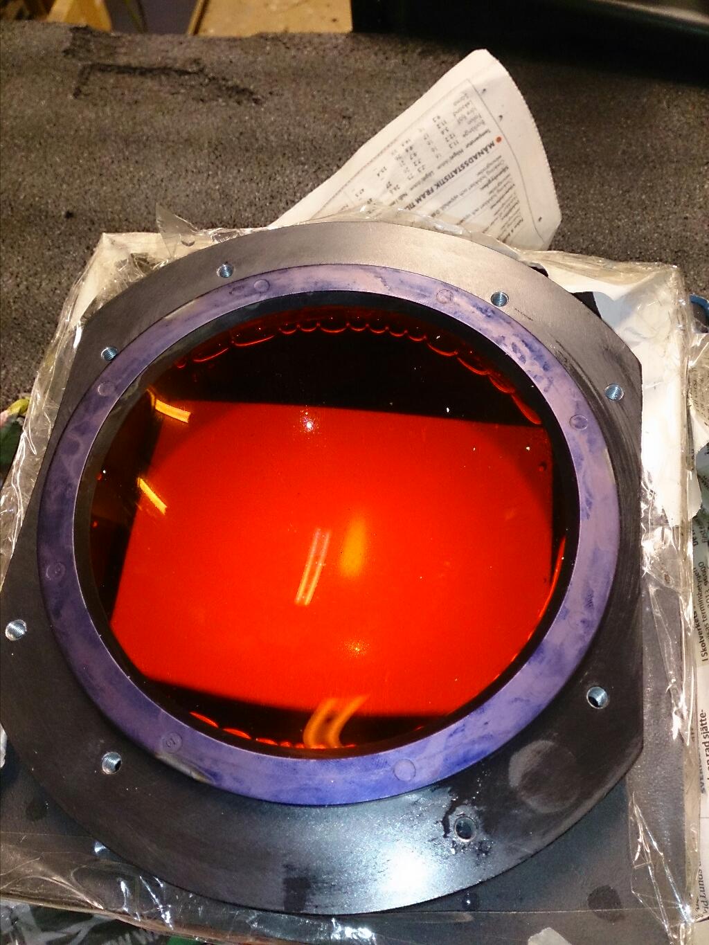

Red c-element fitted.

Posted: Sun Dec 01, 2013 9:25 pm    Post subject:
Sounds like you'll be fine. As long as there's no air bubble near the raster, you're OK.

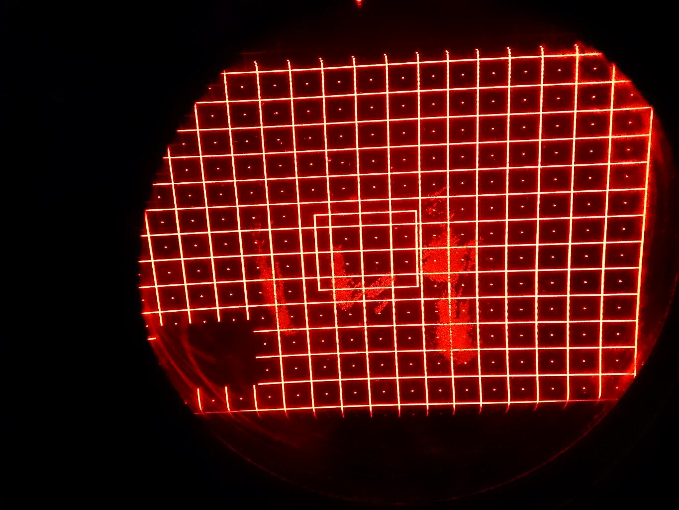

The small bubbles will represent a problem though as they looks to be very visible on the image. Wiped the inside with the provided Zeiss cleaner and allowed it to dry before I installed the C-element. It should prove faster to disassemble everything again now that I know how it's fitted but I don't know what I did wrong in the first place. Any suggestions?
Bubbles on the inside of the C-element
 Filesize:  155.87 KB
 Viewed:  6484 Time(s)
Posted: Mon Dec 02, 2013 10:45 pm    Post subject:
They are in the glycol? They will disappear as soon as you run the set for a couple of days. Don't worry about it.

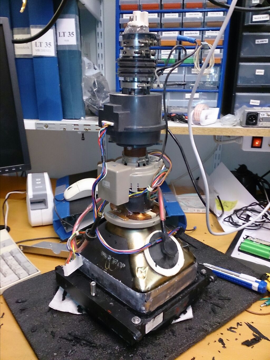

Took out the green tube today to do the C-element swap and now I understand what you are on about. The red tube didn't have the original housing and hence there was no problem with the seal. As for the green one, I can see glycol sweating out the seam. *sigh*
This will have several implications for my plans. I need new housings, and continous scheimpflug comes into mind here. Ordering them is one more expense but I will also be required to drill and cut out the old tubes because they are all in near mint condition. Then I'm left with having to redo the red tube again. The hours spent scrubbing the tube face will not be in vane but everything else will be, including the numerous washes with distilled water and drying it out before adding new precious glycol.

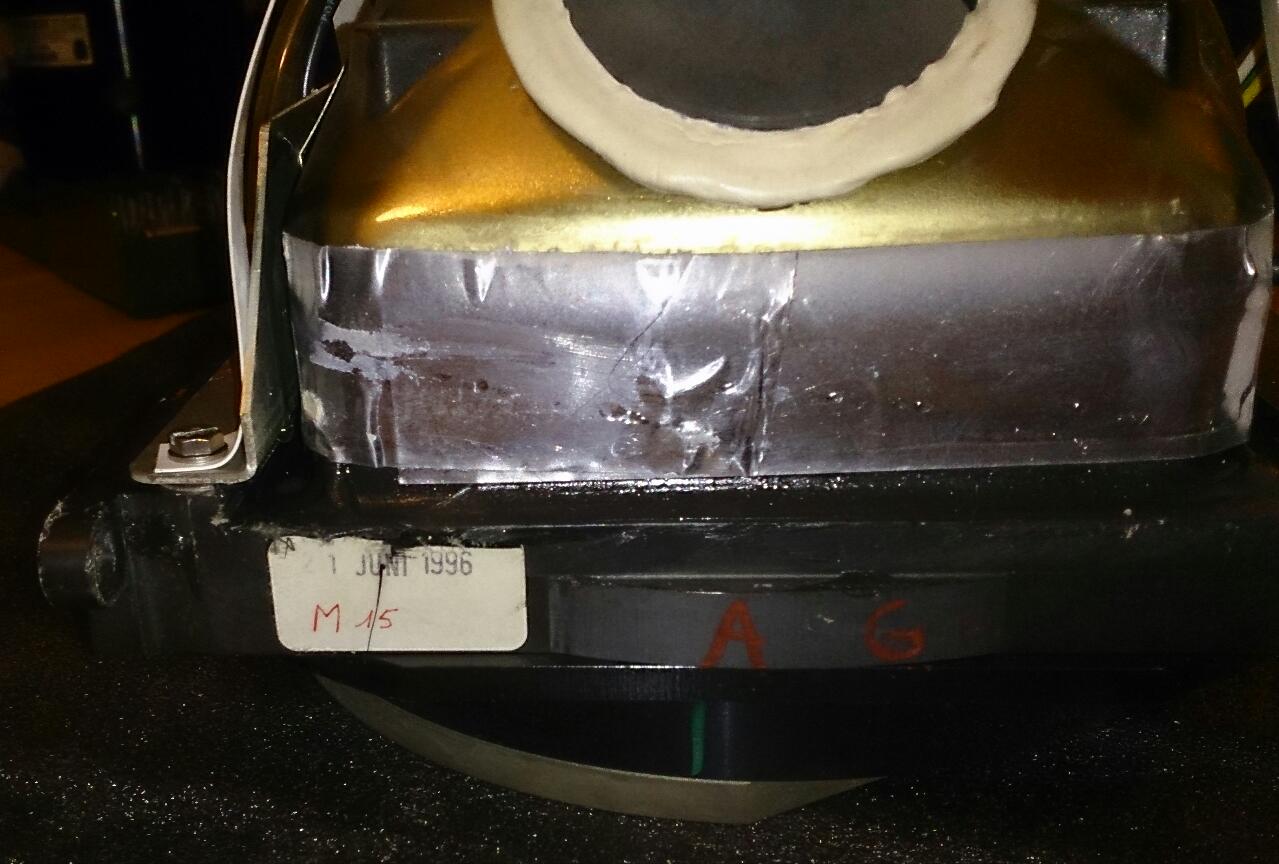

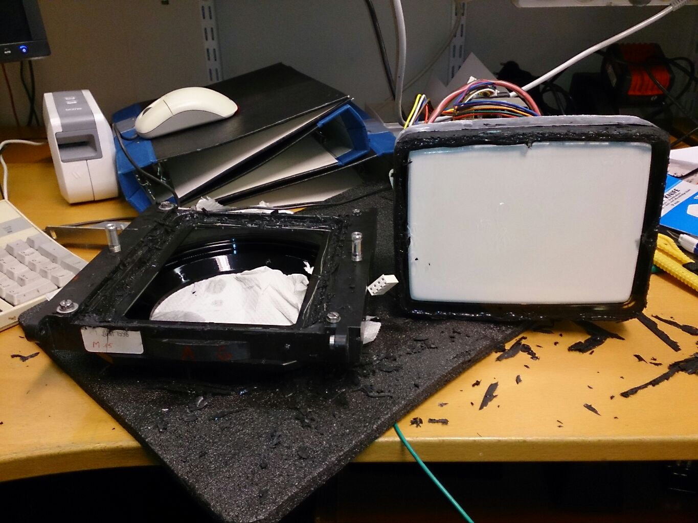

Halfway done on the first tube. I know what you mean now by barco doing a terrible job. I didn't have to push the knife many milimeter before I hit the fluid.
So anyway, what is the correct type of silicone to seal it with again?
