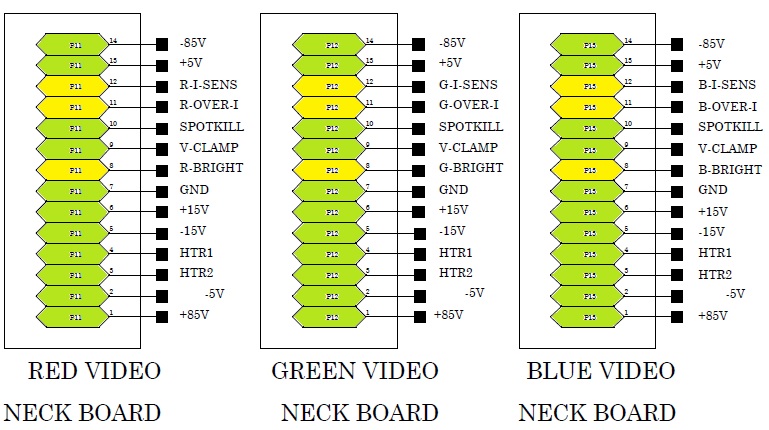

I just would like to add some bit of information regarding the problem with Your green tube.
The 14-pin ribbon connector going to each of the neck boards has been discussed before and some people mentioned that it carries identical signals and supplies for each tube. Well, this is not the case.
Three of the 14 pins carry color-dependent signals (see the ones marked in yellow on the picture).
So, if You really want to find out if the tube is bad, You should swap two tubes (e.g. red and green) entirely by putting the green on the red tubes's location and vice versa. If You try this and the green tube still shows the same effect (although being fed all of the red's tube signals and supplies now), then it is the tube itself for sure.
If the tube really has a problem, we might be able to arrange something. I have a tube analyzing/restoring device. Maybe another visit to my place?

Will try swapping the green with the red tube. But as i asked before,
I heard that the red phosphor is kind of more effective than the green phosphor and therefore driven with less power.
Should the green tube be darker then if i feed it with the red tubes signals and supplies?
I can't open your attached picture.

I really don't know. But it shouldn't matter as this is for testing purposes only. Be sure that You adjust the green tube's G2 (with the red G2 settings) correctly so that it allows for an 1:1 comparision.
Fixed it.
