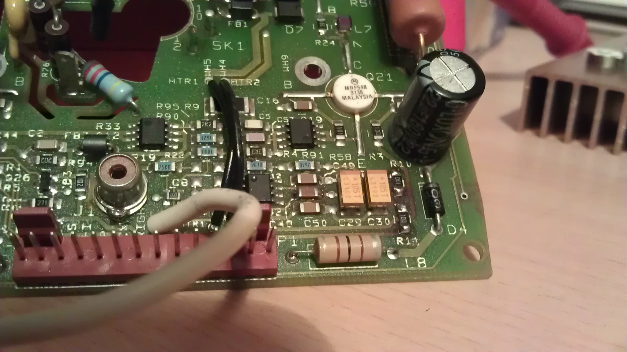

Posted: Tue Jun 24, 2014 9:05 pm    Post subject:
I took the green VNB out and after some resoldering i noticed there are burnt (brown) traces in the area around R10 and R11.
Could the fail lay around here? The two resistors measure 10Ohms like they should.
Regards, Julian

Posted: Wed Jun 25, 2014 12:03 am    Post subject:
replace that VNB, they're cheap and plentiful and it's nor worth risking a tube.

So, the green tube works. I got full brightness again playing with the neckboard, input cables and signals.
The strange powering up and bright dot at powering down stays, but i got a good picture on green.
Update:
Ok, i definitely had a problem with the green VIM. The input capacitor at the 85V rail had a short, or better to say an internal flash-over at higher voltages. No chance to measure it with an ohmmeter or capacity meter.
Changing the capacitor cured the problem with the washed out picture.
I think i know now, where the burned traces come from.
I have a perfectly normal picture again now, but still strange deflection at powering up and the bright dot at powering down.
Regards, Julian

Posted: Thu Jun 26, 2014 8:32 pm    Post subject:
The other option would be to send the tube to someone with an analyzer and they might be able to clear any contamination.
That sounds as the best idea for me. But, i cant understand why this deflection thing at power up happens.
Is it really possible that the tube causes it?
If you have an explanation, please tell me.
Otherwise i will go on using the tube. Or is there a risk of destroing it? The "birght" dot isn't that bright.
It does show up nicely on the video, just as bright as it really is. And thats darker than the normal picture.
Is there a chance to destroy the tube just keeping to use it.
Regards, Julian
