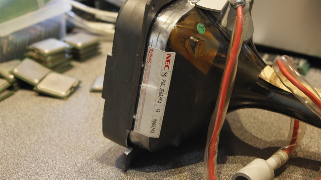

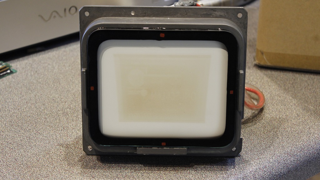

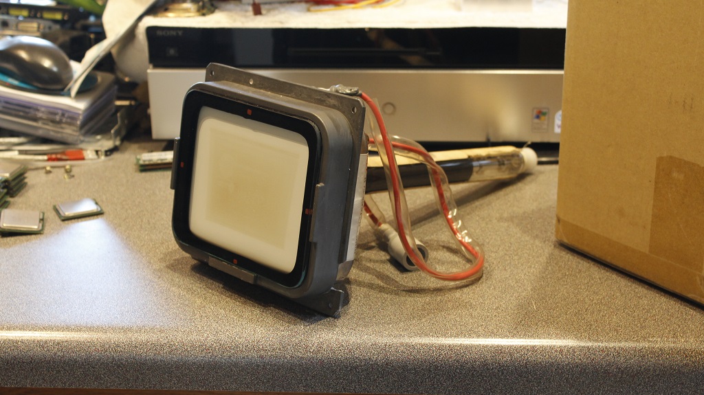

Sorry it took me so long to get you the pics, pretty busy around here! Anyway heres 4 pics of the tube and original NEC shipping box. Tube has some wear and a bit of burn on the wear (can see what looks like an image on the tube face). I remember when I used it that the burn was a bit noticeable, but I was just happy to have my XG up and running again.
Other than that she is in great shape, good emission, comes with the HV lead cable.
So like I said for $50 + actual shipping to you if you want it. Pics below! Smile

Thats a shame about that static burn in eh? Thats not a bad tube apart from that!!

Yeah the burn in sucks, but like you said it was still a usable tube. That's why I kept it for a spare. Right now im getting ready to store my XG for a while until the new garage is built, then it goes out there. Hopefully rather soon too Wink

Its very usable for sure, depending on the person and the application
