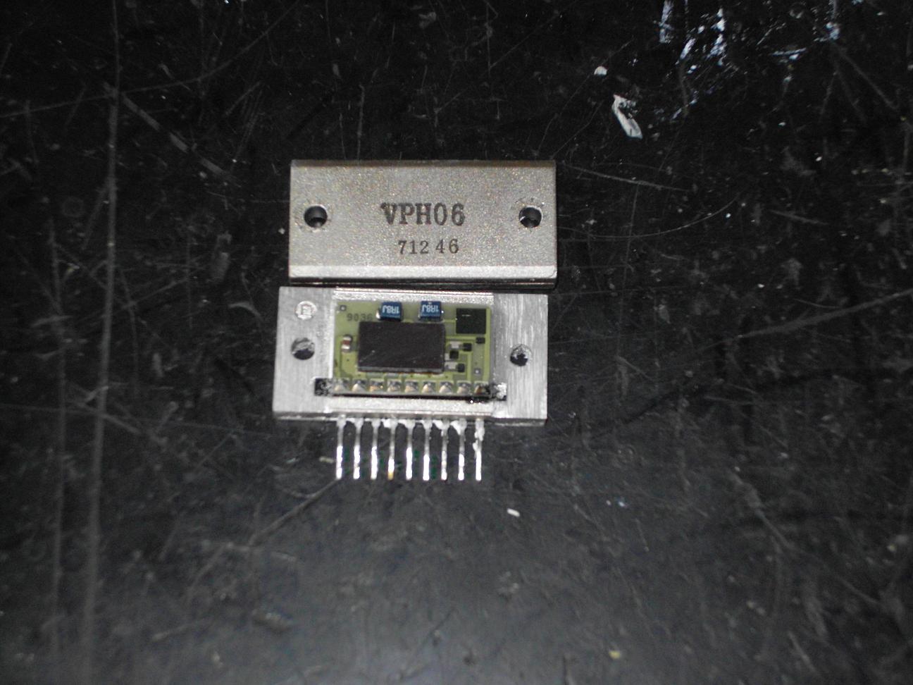

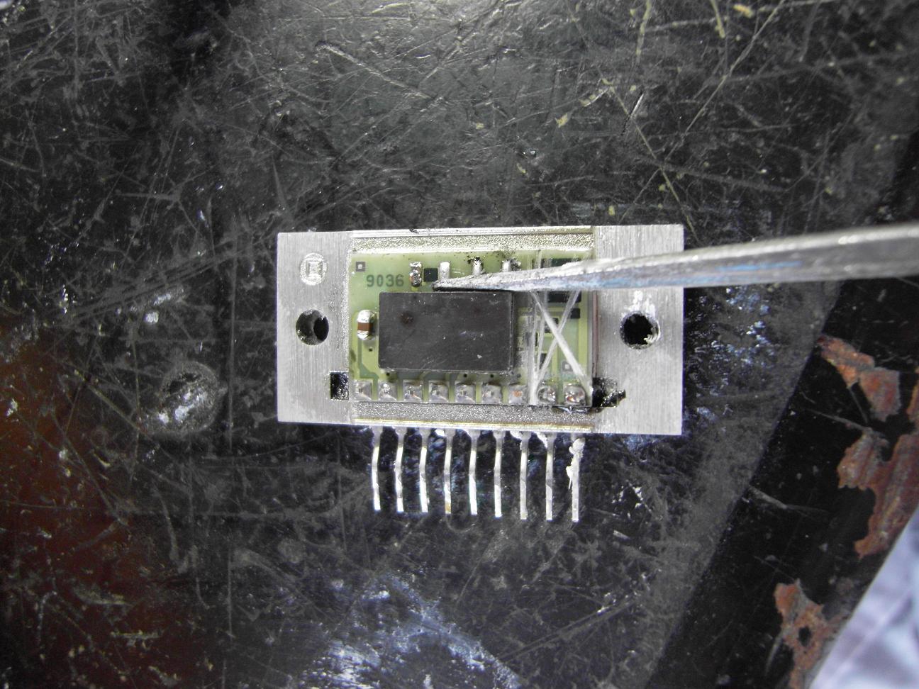

Posted: Tue Oct 01, 2013 5:52 pm    Post subject:

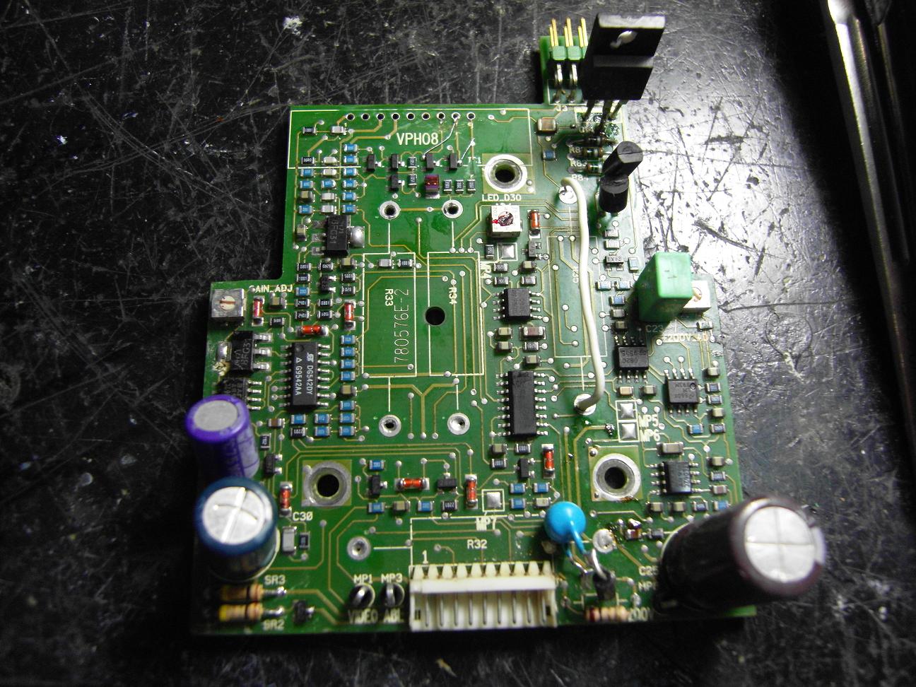

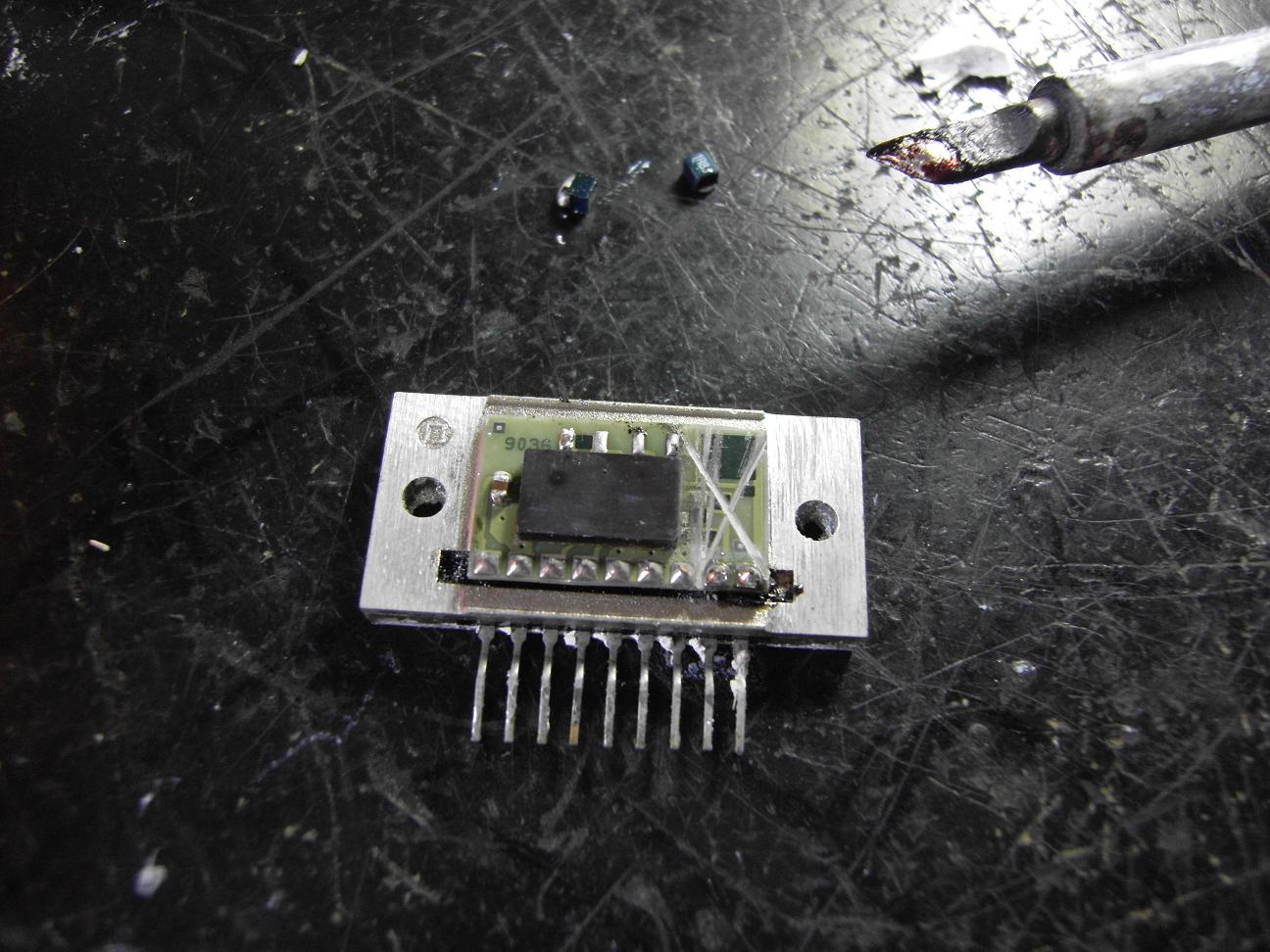

It's very hard to open the vph's chip.
I had to heat the microchip to open it.
Now I would to know other components to do the mod.
Domenico (Barco fan!)
Posted: Tue Oct 01, 2013 5:54 pm    Post subject:
The transistors you want to substitute are under the brown shield...

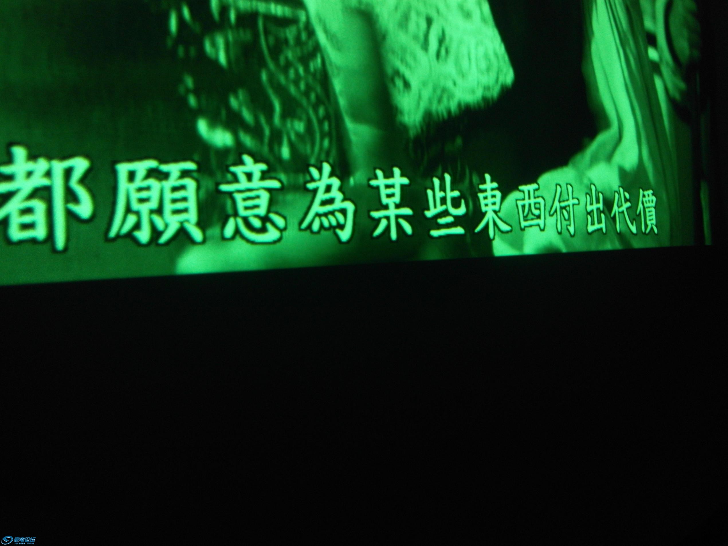

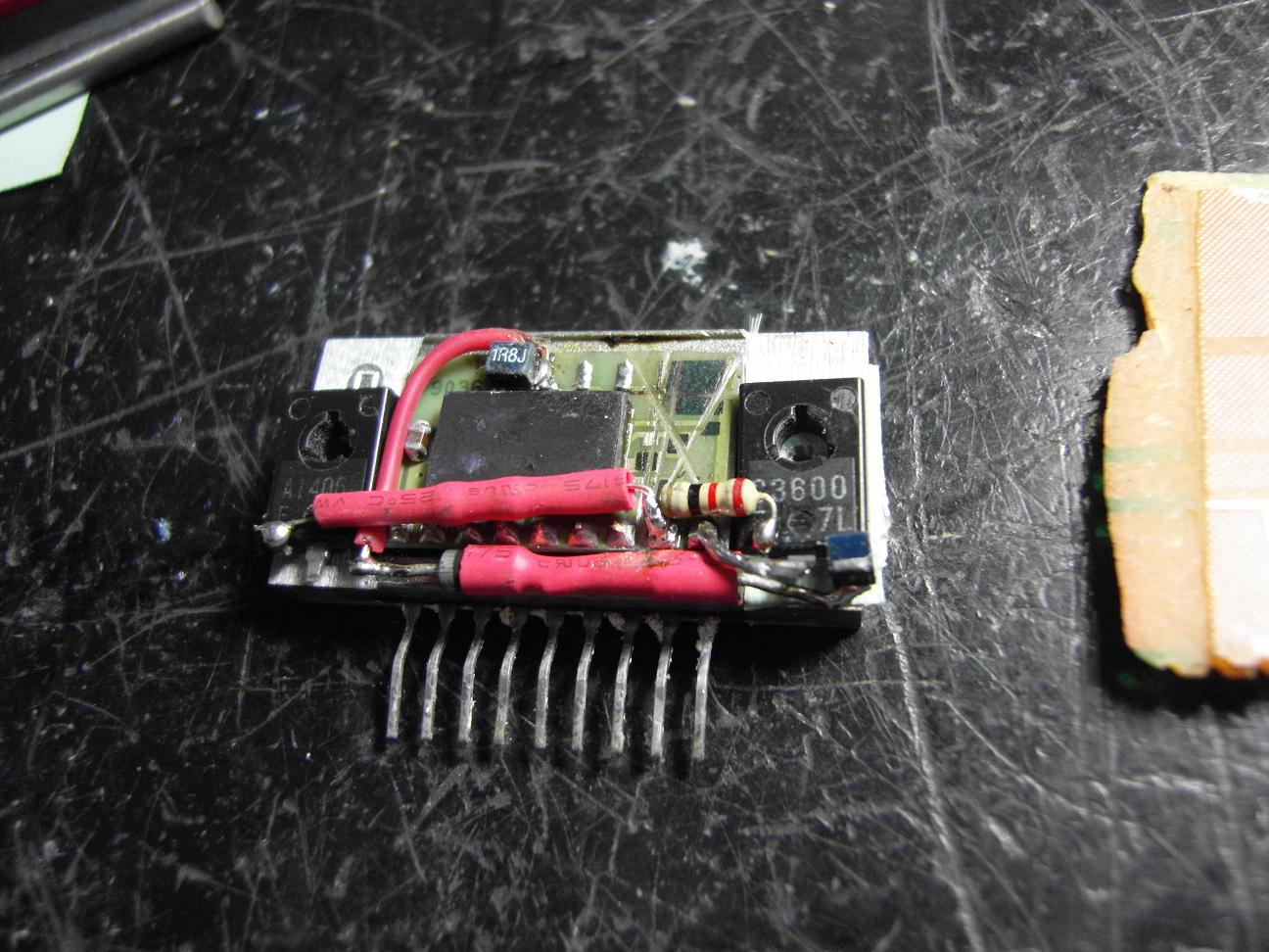

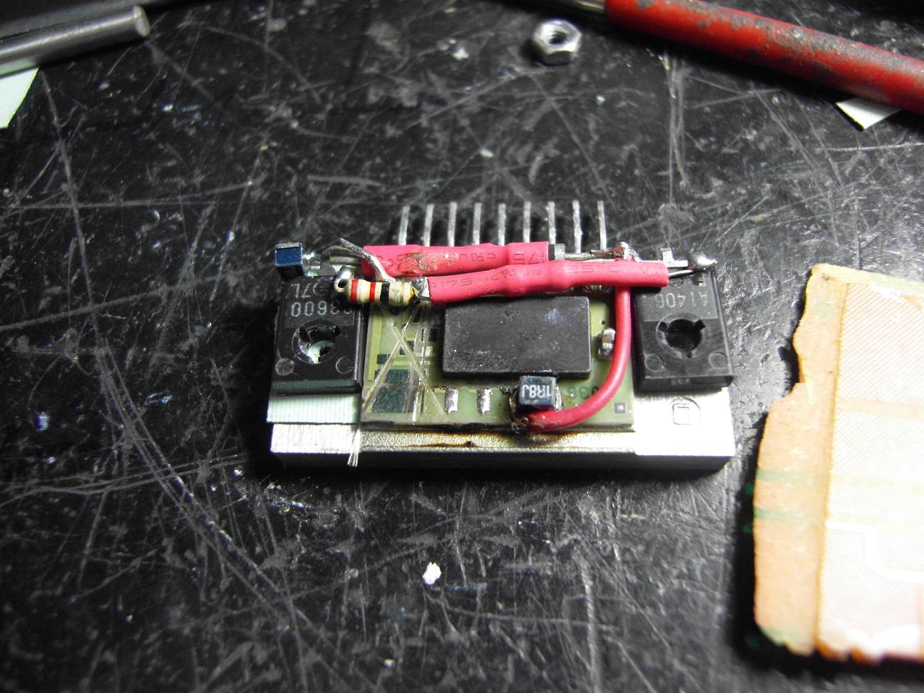

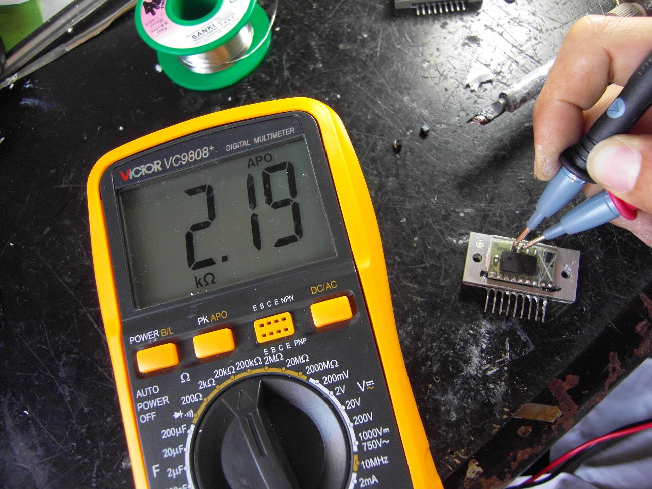

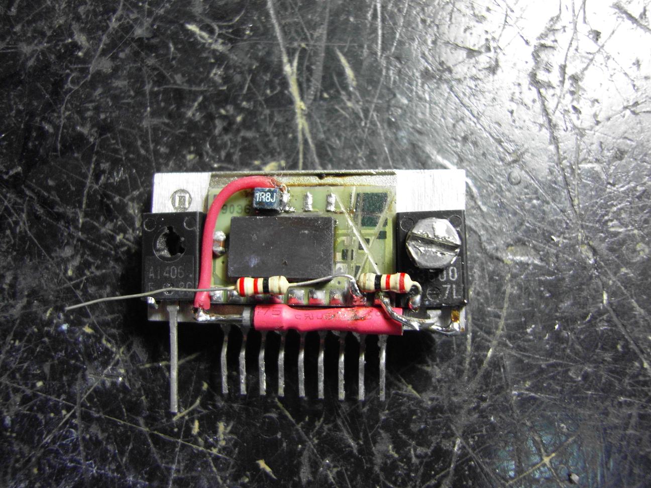

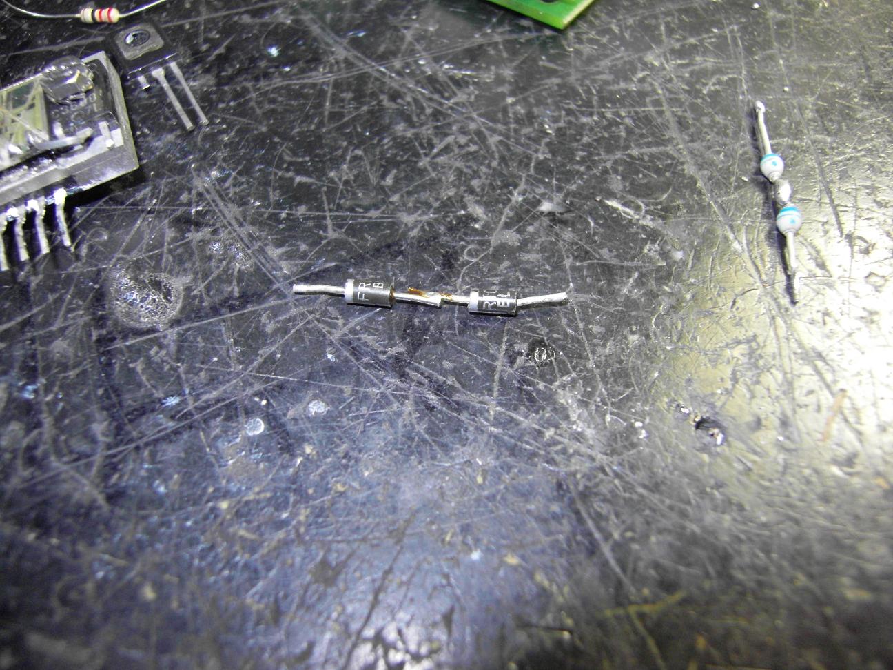

Posted: Tue Oct 08, 2013 1:57 am    Post subject:

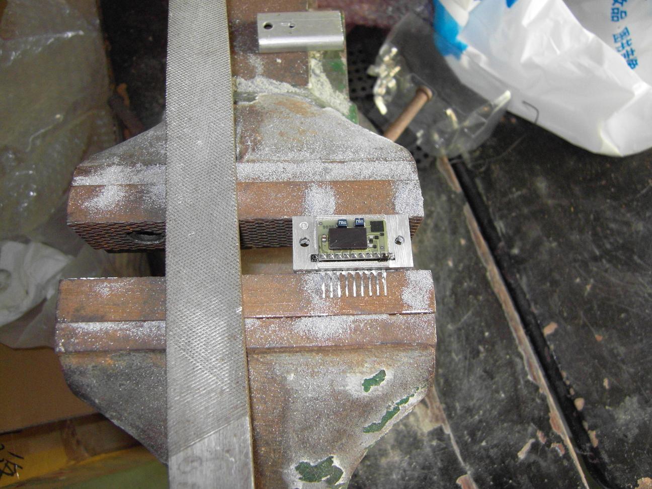

The specific method of modifying IC

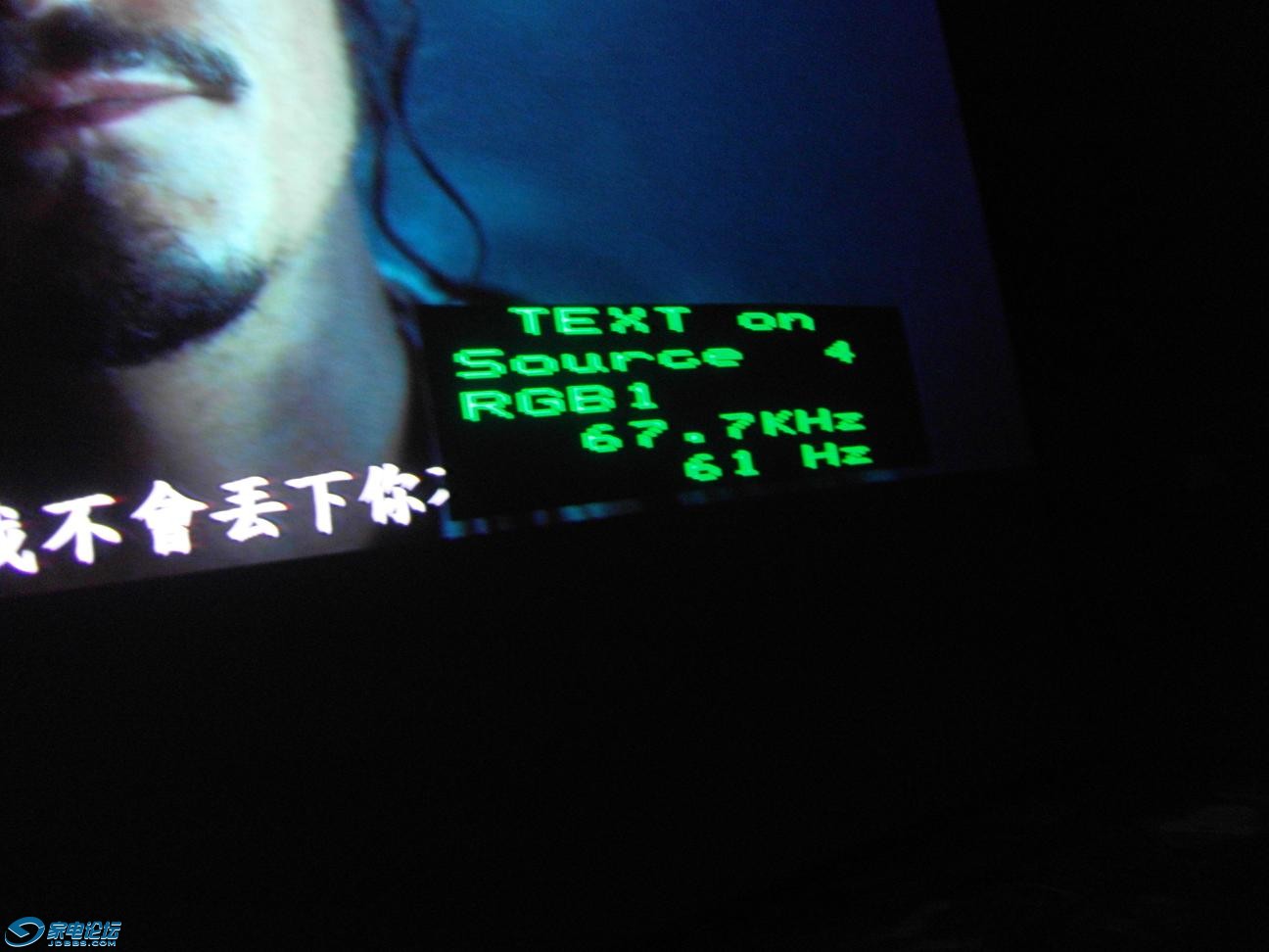

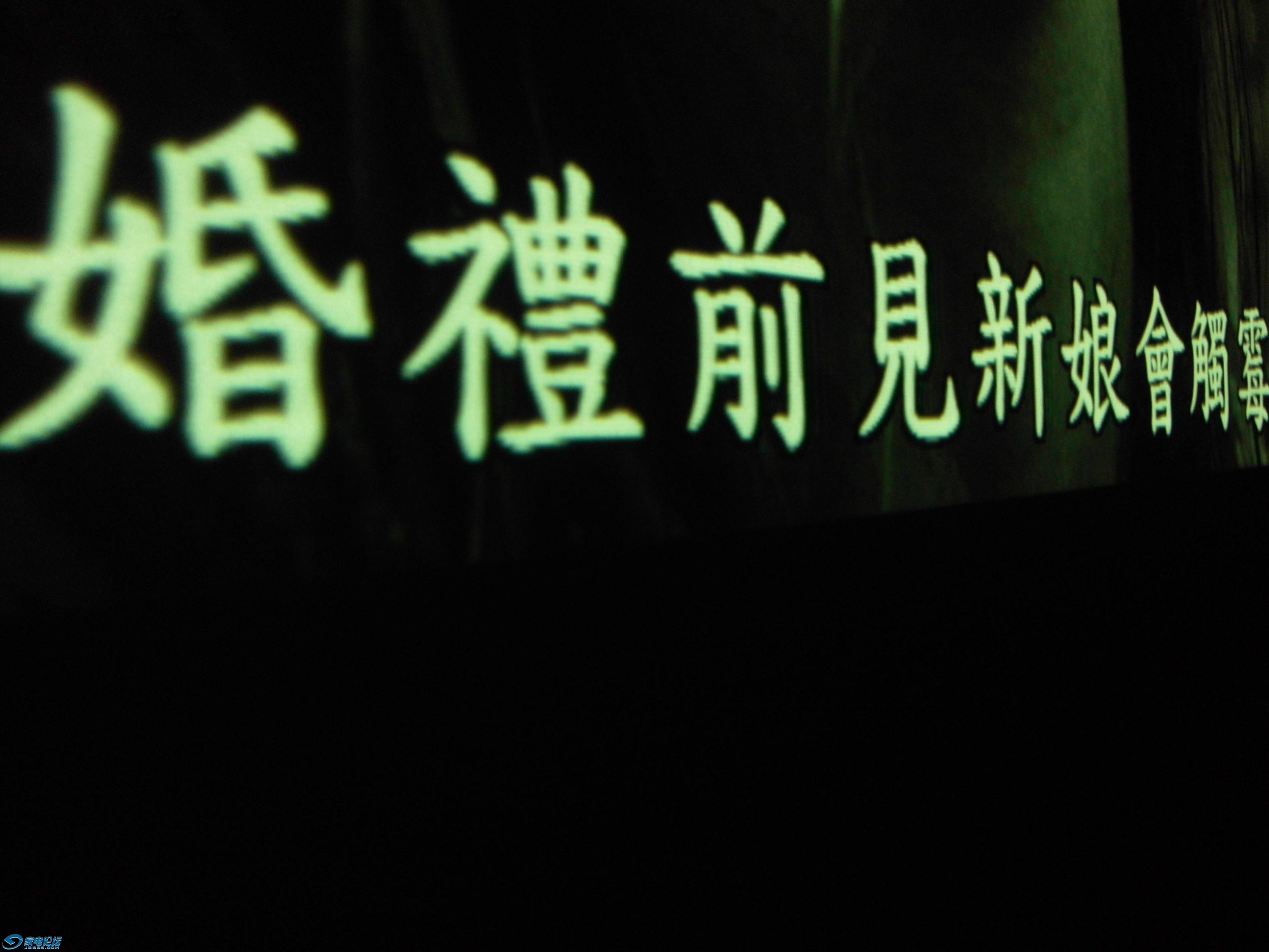

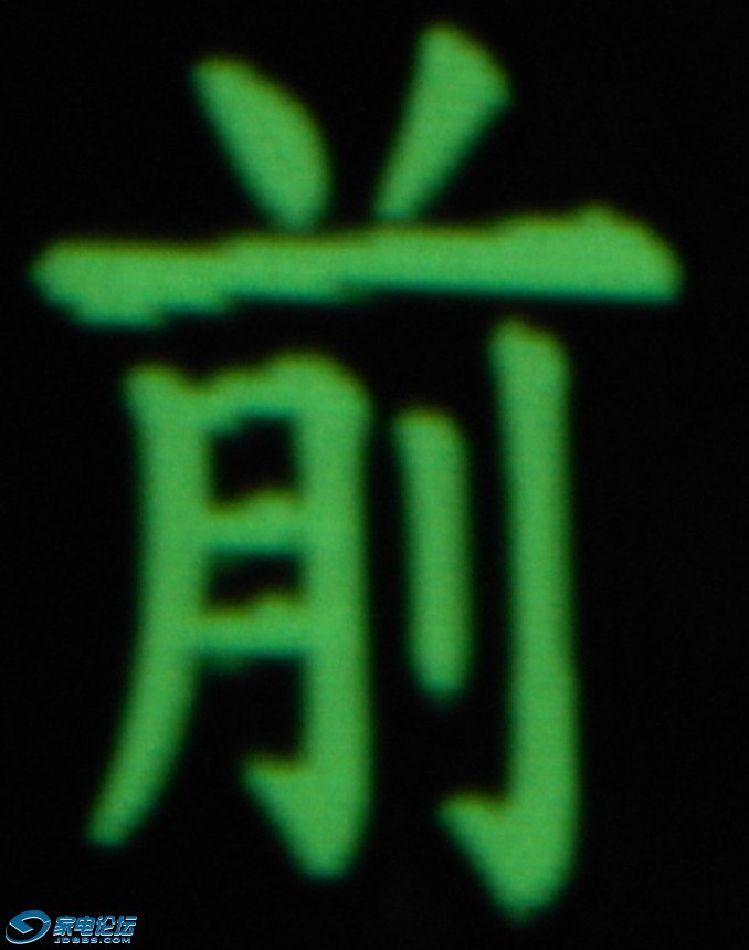

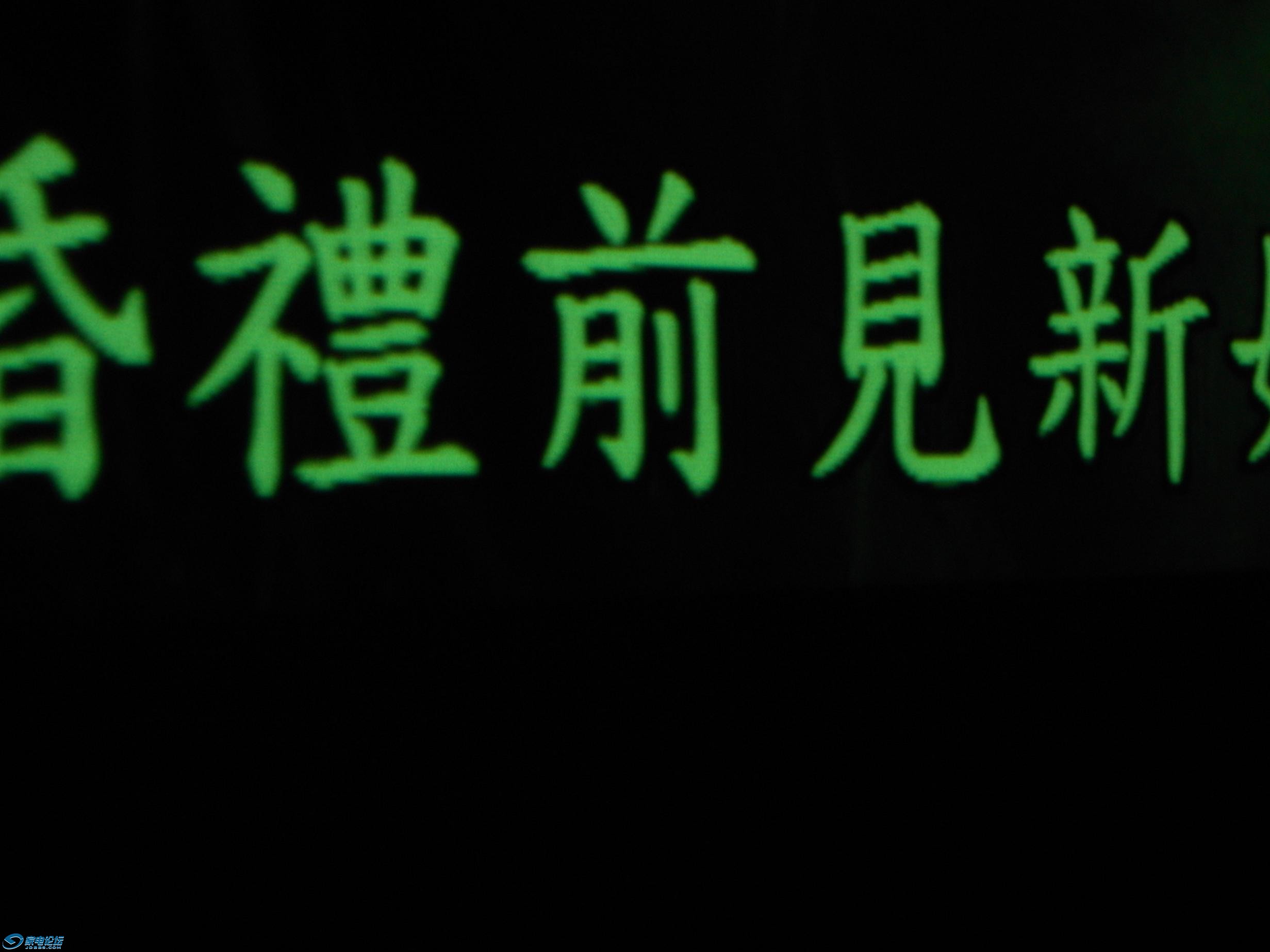

Posted: Tue Oct 08, 2013 2:10 am    Post subject:

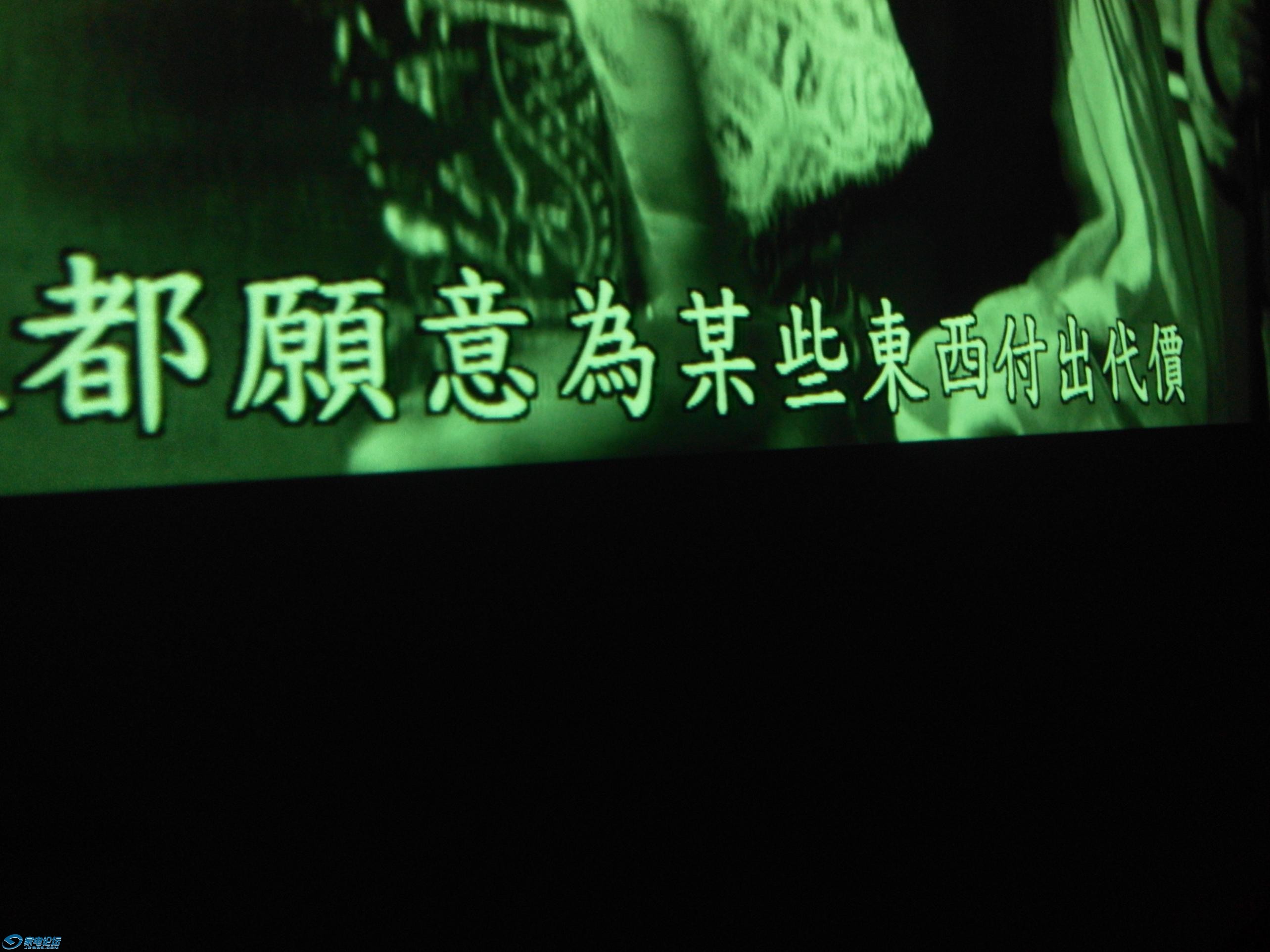

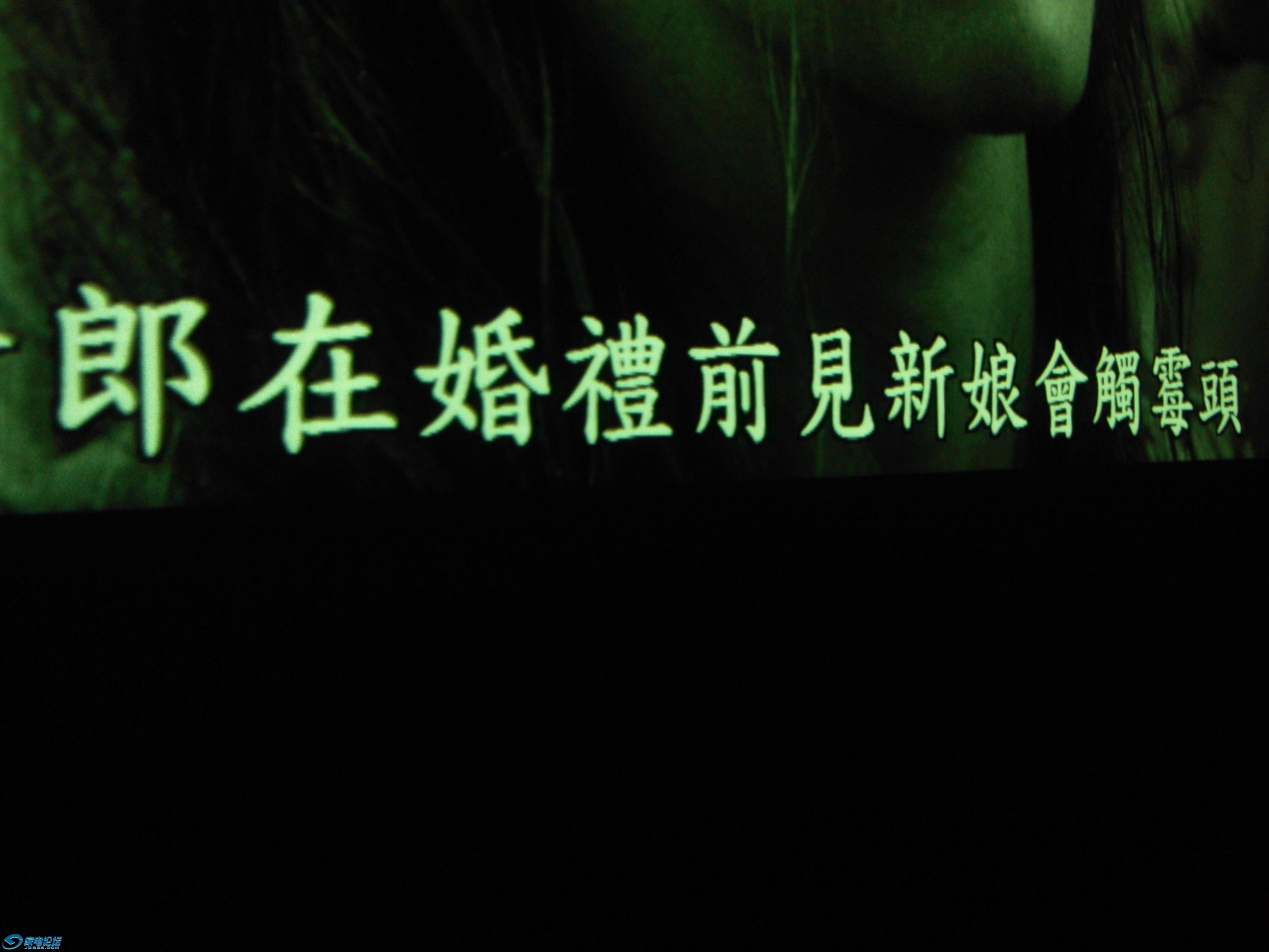

Modified significantly enhance the focus, the subtitles are formed by the scan line
Enlarge the screenshot you can see a clear line

Posted: Mon Apr 07, 2014 5:42 pm    Post subject:
I'm very curious... has anyone other than zxh398 actually succeeded in this mod? The ICs seem to be quite easily available on ebay...
Posted: Mon Apr 07, 2014 6:07 pm    Post subject:
-These ICs are very fragile inside, easy to ruin while you want to disassemble, needs delicate skills.
-The suggested 2sa106/2sc3600 transistors are hard to find, while no one seems to have experience with the NTE replacement.

Posted: Mon Apr 07, 2014 8:26 pm    Post subject:
gjaky wrote:
Hmm... the transistors both seem to be available for purchase on eBay, in the US anyway.
I would be interested in buying a spare neckboard to try this on, if only the instructions were a bit clearer about what exactly was going on, or included schematics of the actual mod.
