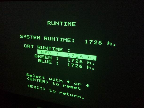

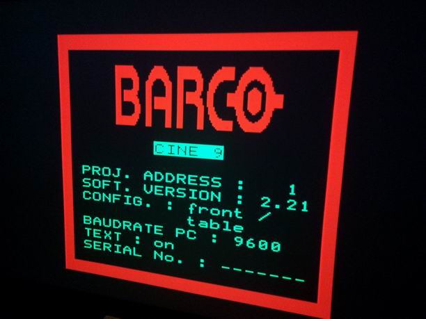

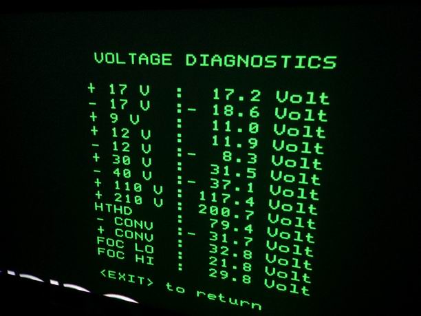

Posted: Mon Jun 23, 2014 11:13 am    Post subject:
Some more shots about software revision and runtime on mine.
I did not reset the hour counter of the tubes itself. They have about 100 hours runtime and are brand new.

He when I compare voltages i see a huge difference in HTHD voltage. Mine is 118V yours is 79V. Who knows what is right or does even this difference not matter?
barclay66
Joined: 27 Jun 2011
Posts: 1304
Posted: Mon Jun 23, 2014 2:08 pm    Post subject:
HTHD isn't a fixed voltage (otherwise it would be + xxx V like the others). It is the supply voltage
for the horizontal deflection and needs to be adapted to the corresponding deflection frequencies
(due to the frequency dependent resistance of the deflection coils).
You will see different values depending on the input Signal (e.g. 720p vs 1080p etc.).

Posted: Mon Jun 23, 2014 2:32 pm    Post subject:
Voltage reading was done with 1080p@60Hz.
