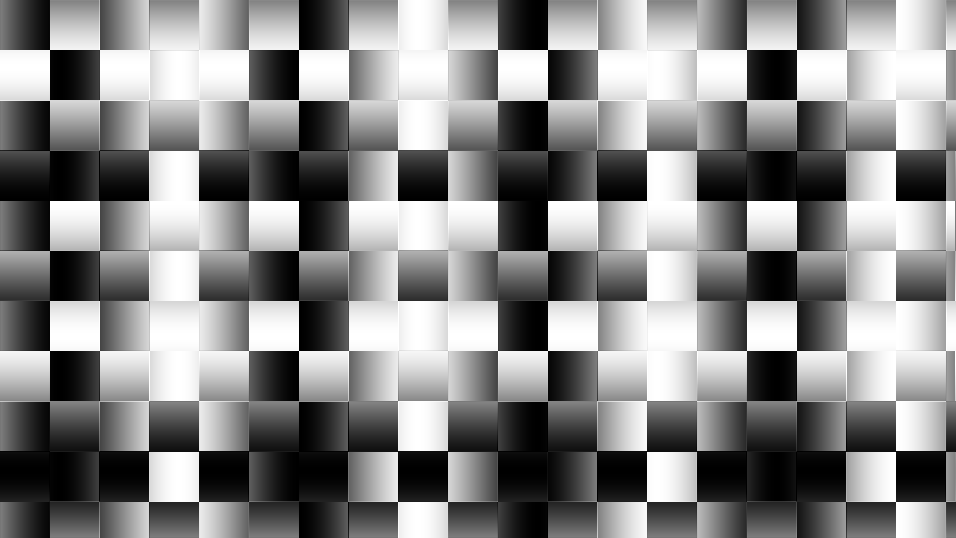

Posted: Tue Oct 15, 2013 1:51 pm    Post subject:
try this pattern
 Filesize:  31.3 KB
 Viewed:  12898 Time(s)

Do you have a file with the pattern you used, you can upload here and share with us, so we all are comparing the same material?
I was playing with different VP the other night, and its not just about the power of the VP, No HDFury i have will resolve 1080P
And same thing with analog outputs on some VP, and it can also be messed up digital before the DA converter.
I realy doubt that anyone made a testpattern with 1:1 pixel pattern, with have different level, i dont understand the purpose of a pattern like that.
The pictures you made are fine, and looks normal, i have never seen any Barco resolve that pattern, actualy they look like yours.
It would be interesting to see how the mods will improve that.
The only reason i can do decent 1:1 72hz on mine is that im using the MP VIM and neck boards.

Posted: Tue Oct 15, 2013 2:29 pm    Post subject:
try this pattern
Nice one.. That pattern just made my 1080P 46" LCD panel look like a joke lol
Posted: Tue Oct 15, 2013 3:11 pm    Post subject:
stridsvognen wrote:
try this pattern
I use that one on my blend and to adjust the Peaking circuit. I definitely will show you how good your edge focus is, edge astig etc. Also it helps setting up the Zone contrast. But to get both PJ's to match and have the H and V the same is really hard.
I still can't get them the same, I can get each color to get close but when I put all three up you see color shift and
luminance differences. But i also love that pattern for focusing.
