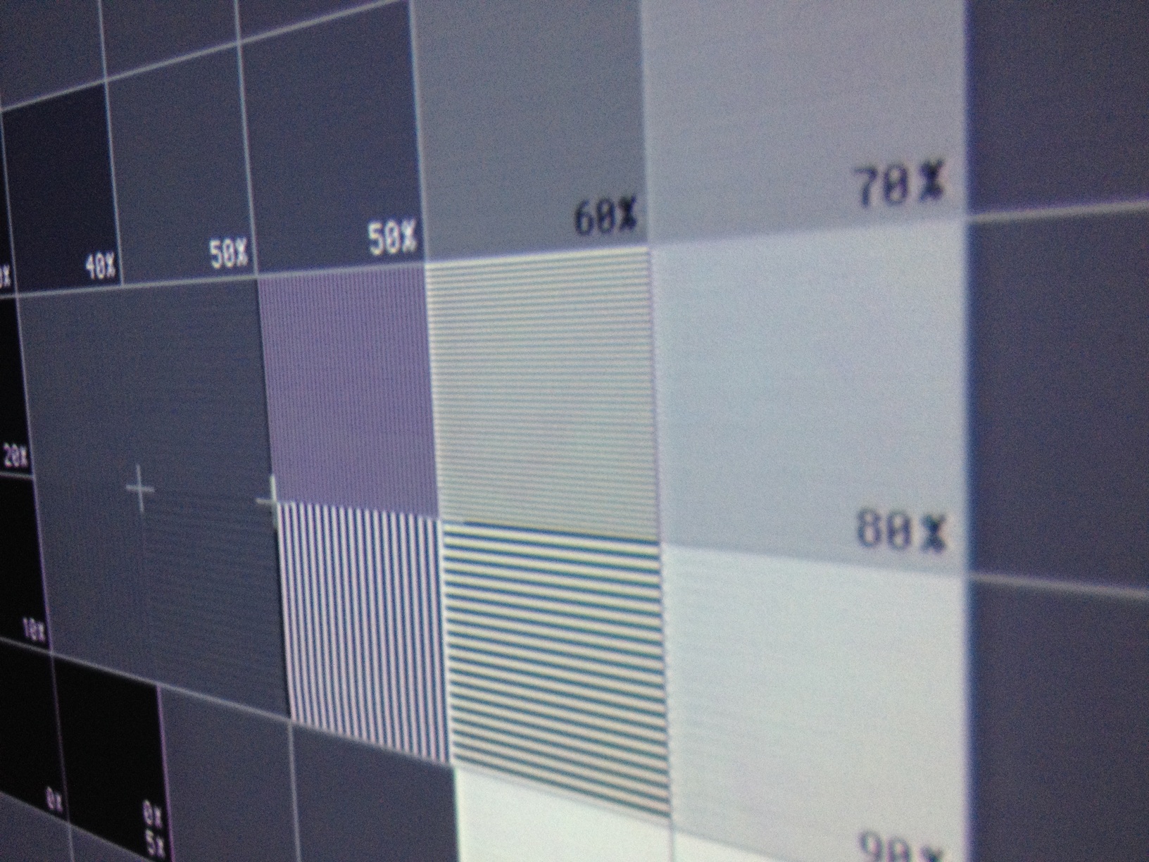

I went to redo zone focus just before, some zones do not adjust at all, where as the one right beside it will adjust just fine. There is some sort of issue with this machine.
Ill post a close up one on one off in a minute, took with the iPhone 4S, its not too bad, but im pretty dissapointed with it really, it just should be better....
Posted: Sat Oct 12, 2013 3:14 pm    Post subject:
Here we are:

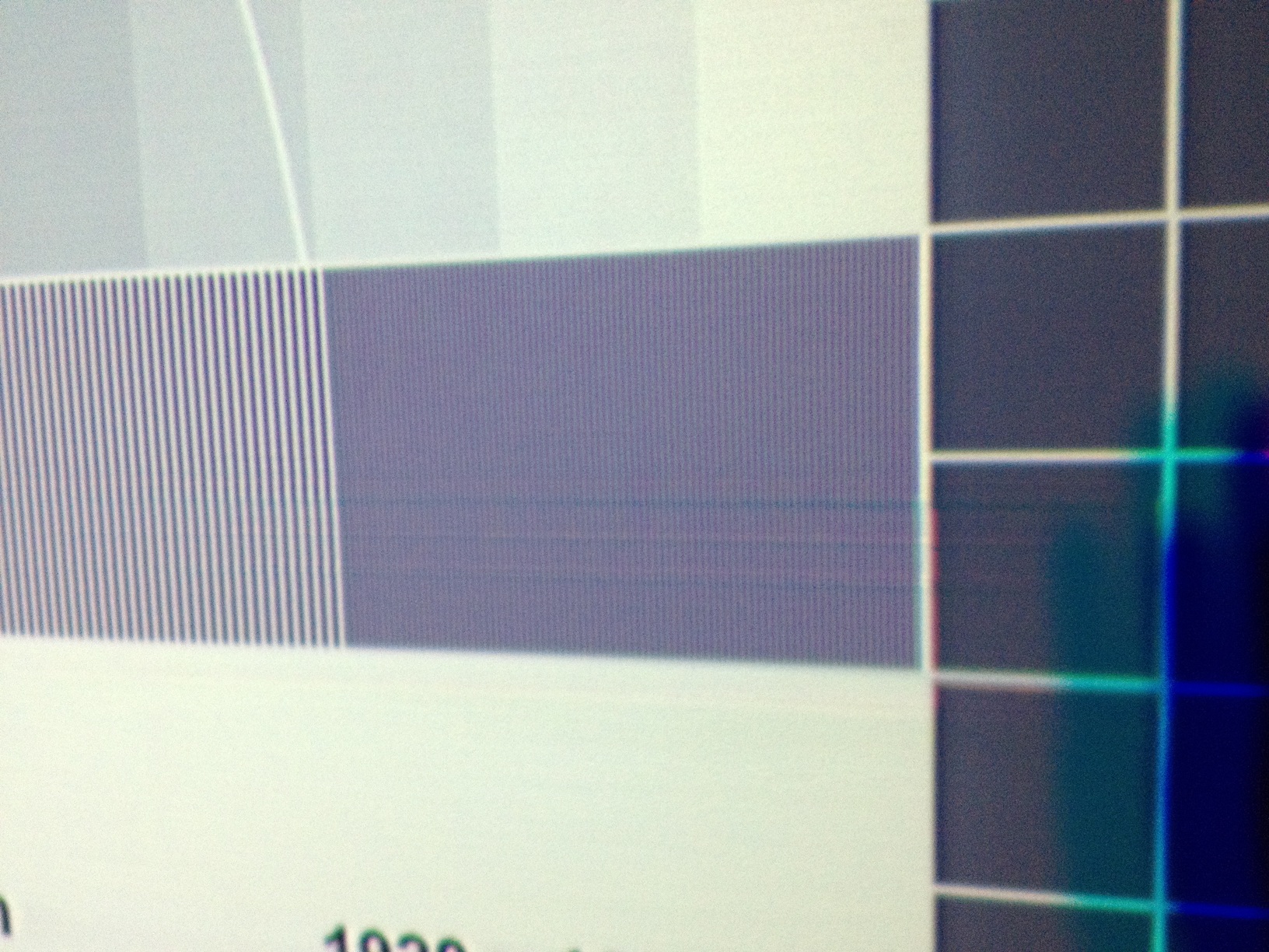

The waves i cant correct... On any source, varies in degree depending on resolution
 Filesize:  670.48 KB
 Viewed:  8973 Time(s)
Lines in the image

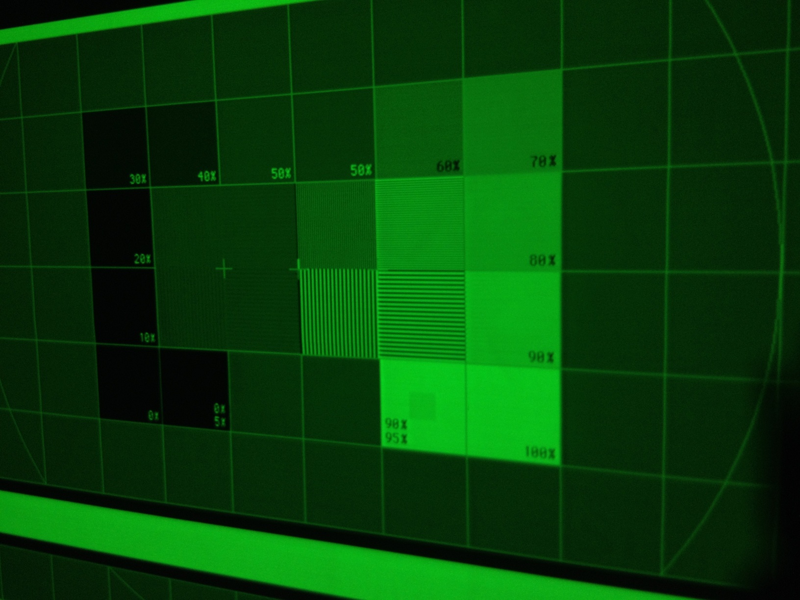

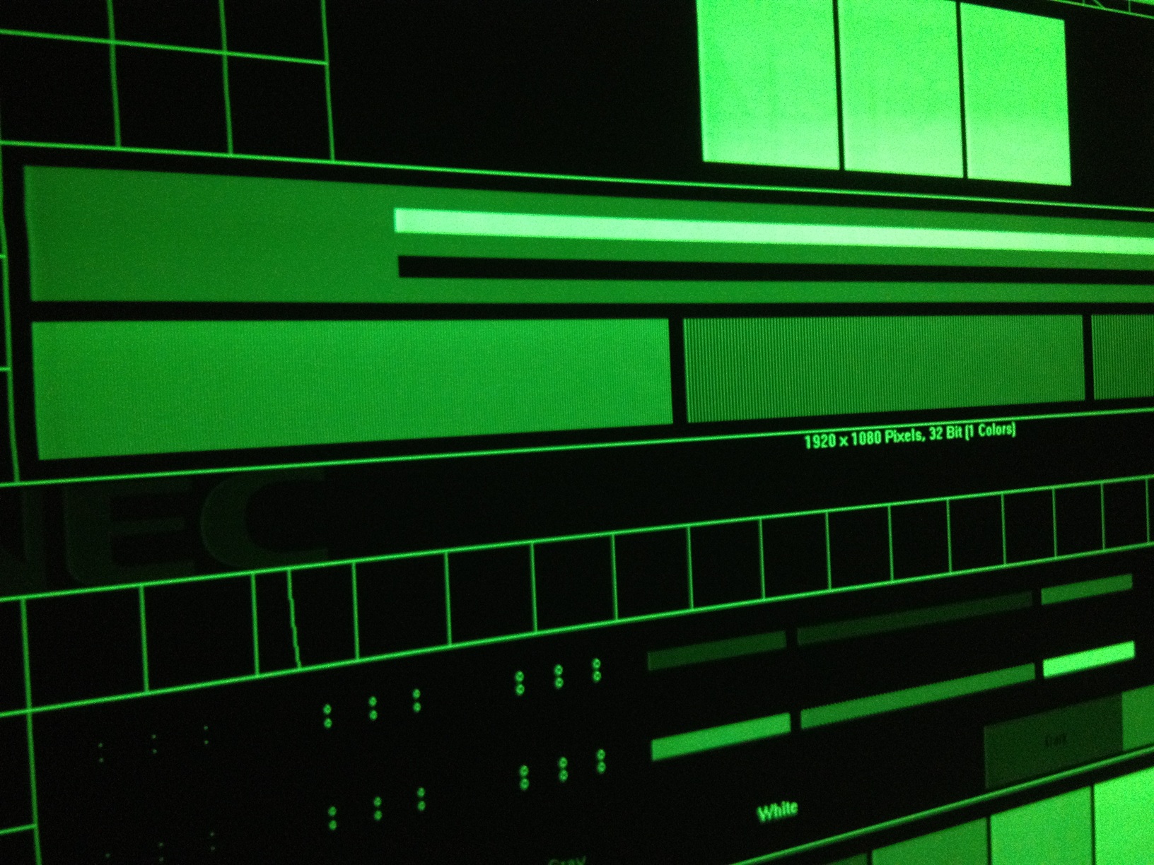

Here are a couple more:
Green using an NEC test pattern
 Filesize:  587.85 KB
 Viewed:  8978 Time(s)

Im not sure how much my screen is affecting the 1 on 1 off ability....
all colours
 Filesize:  692 KB
 Viewed:  8969 Time(s)
Green only
 Filesize:  393.42 KB
 Viewed:  8964 Time(s)

All those done with PORT 5 on the CineMAX, direct from the video card via 5x quadshield 75ohm RG6 with compression fittings each end.
As ordinary as it is there, it is not that sharp via the Ext MOOME V3.
Posted: Sat Oct 12, 2013 4:02 pm    Post subject:
Should probably add that it was 1920x1080 @72Hz...

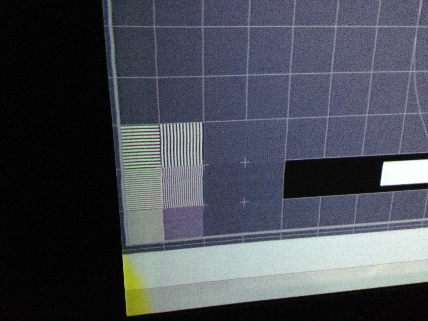

Is your green out of focus on the right side ?

Posted: Sat Oct 12, 2013 4:50 pm    Post subject:
Case, the line distortion seems to me an LVPS (HVPS - Horizontal deflection interaction) problem, check when moving brighter windows on desktop would affect the distortion's degree and/or position.
Posted: Sat Oct 12, 2013 5:32 pm    Post subject:
My green 1:1 look like this, hand held camera, cold projector, lower right corner.
188Mhz pixel clock
H total 2325
V total 1125
V rate 71.93
P19LCP tube
Ill try make a new shot when i get the new LUG tube in.
Posted: Sat Oct 12, 2013 10:31 pm    Post subject:
Yeah mate, there are a few zones that focus has no effect on. Most of the ones on the left work, and were very close anyway, but right and bottom are rather terrible. Hard to tell in the pic though cause its focus is on the 1 on 1 off lines.
Yeah mate i dont know, the lines are extremely hard to see cause they move very fast, the waves pic is a static distortion thats worse on the right.
Mike will probably know when he sees it, from all ive read around since owning this rig he seems to be an expert on the 909...
Posted: Sun Oct 13, 2013 12:34 am    Post subject:
CasetheCorvetteman wrote:
Everything mid mate yep.
What is the part number on the focus board (in the tray) in your Cine 9/909?
There are two different versions of the focus board for that set. The earlier one was replaced later with a focus board that had a larger black heat sink.
If you're using a PC as source, you're not going to get that pattern displayed properly until you replace the filters on the video card with ones that better suit the resolution. That's what we had to do with the Moome cards.
It's been a few years since working on these, and I have very few parts left.
Posted: Sun Oct 13, 2013 12:44 am    Post subject:
I will have to check it out in a few days for you Mike, ive got perfect stability in alot of zones, it seems the flicker and juddering is worse in some zones. Hard to say. Its a July 2001 model.
