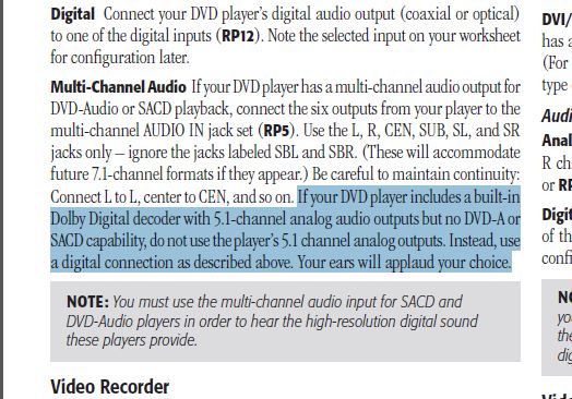

I *thought* my Outlaw 970 would do this...but now I'm less certain it doesn't apply room filters, etc. to the 7.1 multi-channel DVD-A or SACD. That is, outlaw explicitly states stereo bypass sends completely separate lines for two channel stereo, but don't make this statement for multi-channel in. Regardless of how which way it is, Outlaw still went out of their way to suggest I do as Hogpilot says (my highlighting in blue). So for my unit, at least, I'll trust outlaw has the data and knows of what they say...and I imagine by now most quality prepros are no different.
zaphod wrote:
i ended up getting a split pack from Curt, but due a trio of medical issues, family issues and two kids the whole basement reno has slipped and slid when we need it the most.
Super bummer how life can kick us all in the nads like that. Well, glad you can at least plug along on this stuff!
cheers,
Matt
Page 17 Outlaw 970 manual (different from analog bypass, which is 2 channel direct totally unmolested).

Its easy to try if you have both digital and analog cables.. Wink
And let your ears select, as they write in the manual..
Would be fun to see a block diagram to that processor.. not that it say anything about how it sounds, but just to see what the signal have to pass.
Is it possible you could perform a test and share with us what you hear.?
