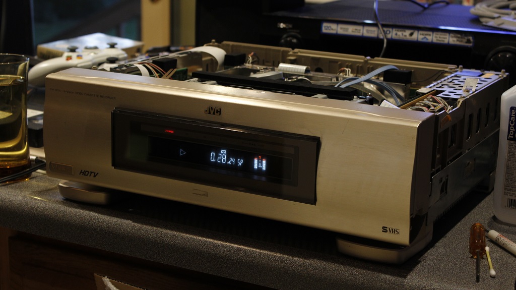

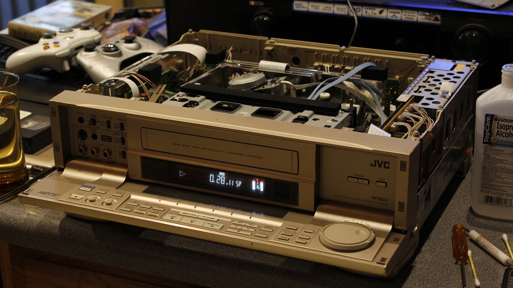

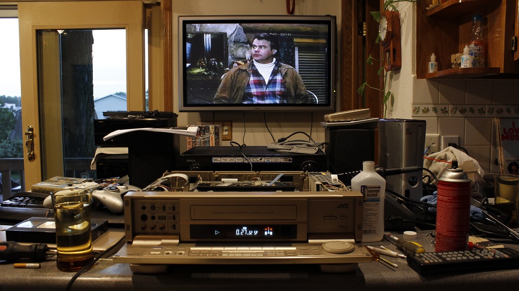

just an update... The heads must have been THAT dirty, it works PERFECT now Very HappyVery HappyVery Happy And WOW the PQ on this deck is honestly quite amazing for a standard VHS!, I'll have to up a screenshot Very Happy

I used alcohol since I just didn't want to risk it on the heads on this unit. It's too expensive to experiment on Razz
I also used some electronic cleaner on the heads as well, between both of them that got it. I'm just glad its not a major issue, since when I opened the unit up, I found a broken off test lead still on a test point! So someone else thought there was something more seriously wrong.
and here's some pics of the working product!
