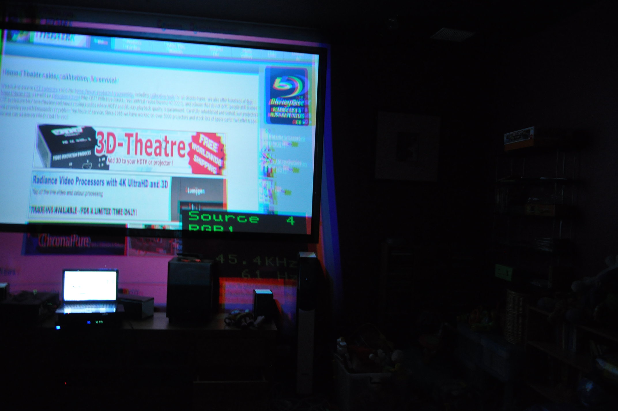

pic 3

So how did you get picture #3 to work fine? Definitely a sync issue. I was going to say a bad RGB input board, but if you get one pix fine off Port 5, then the card is OK.
Posted: Mon Jul 15, 2013 1:44 pm    Post subject:
Ok one says 206Hz and the other says 156Hz, what does it say on the computer monitor when you plug the Fury into it with the same source?
Posted: Mon Jul 15, 2013 1:46 pm    Post subject:
Why isnt the image centered on the tube face? It must be way up near the top to look like that...

Using port 3 should test that theory, maybe there is a bad connection or some other issue with port 4/5

ok just tried dvd player to monitor same problem cant pic it up but then I plug laptop in with hdmi lead to monitor and it works perfect every thing is pointing to this hdfury2 being the problem and bcos it has curt palms name on it I think he should send me a new one for free lol

did u see my pics corvette man
Posted: Mon Jul 15, 2013 1:56 pm    Post subject:
He doesnt sell them, just helps to market them Wink
I doesnt sound like a Fury issue to me, sounds more like a bad cable or wrong setting somewhere.
Set the DVD player HDMI output to either 1080i or 720p at 60Hz and see what it does then.

ok I have set the dvd player to ntsc and droped it down to 480p and I almost get a picture but still only for a few seconds then it drops out but it is definatly much better
Posted: Mon Jul 15, 2013 5:13 pm    Post subject:
So this is DVD -> Fury-> projector?
Now try adding the GammaX. Also, do you know that the power supply plugs into the GammaX when using it with the Fury?
Try that, and then try switching the sync inversion switch on the side of the GammaX.

tried that still the same problem crap signal threw the hd fury 2 it has to be stuffed I have got another hdmi to rgb/vga convertor but am back to work today so I will let use know if it fixes it when I get home and if it does I will send u this hd fury and u can have it maybe u get it working
Posted: Tue Jul 16, 2013 4:46 am    Post subject:
Connect the PC with RGB-HV and see if itll work on various resolutions. 1600x1200 will likely be the best itll do.
