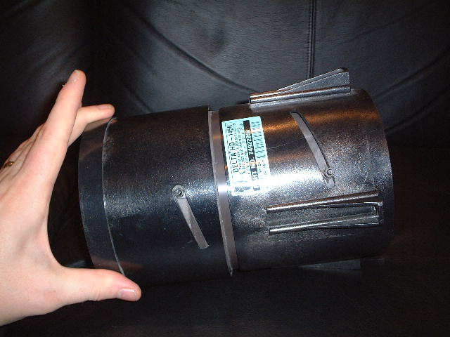

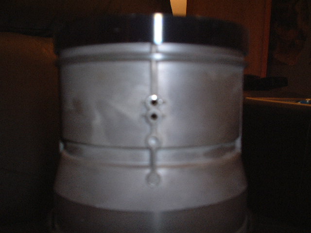

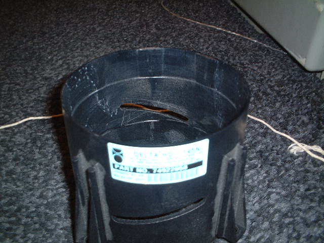

Popped the lens shroud off one of my hd145n's. There are two threaded special 'screw things' that hold it on. One has a wingnut on top which is how you adjust the main focus, the other is 180degrees round the lens. They both undo with a square socket, though not finding one so small i used an adjustable spaner, very carefuly as not to round of the square head. A little tricky but doable.
The lens body apears to be aluminium with a drilled and tapped holes for the 'screws'. There are however two more holes further in than the normal ones, one is quite close, the second a way back and a touch recessed - I would guess that these are fitting options for using the casting on other lenses.
The shroud is a black hard plastic, but i would have though it was cutable with a hacksaw and drillable with an electric drill.
From reading arround there is the problem of getting the lens closer to the tube for screen width focus and fitting the smaller lens in the bigger hole, complicated by the fact that the lug fitting on the smaller lens fouls the larger aparture when trying to fit the lens closer.
I'm wondering with a flat plate adaptor sat on the front of the large hole which would mount the lens, but not give the closeness if the shroud can not be modified, there is 1/2-1" that could be gained by trimming it flush with the lugs, or by turning the shroud through 90degrees so that new focus slide holes can be drilled to give greater depth, or a combination of trimming and new slots ?
I'm only brain storming at the moment, but have included three pics....I also don't know if my HD145N's are the same construction as the 144's and what the N stands for i'm also not sure.
Cya,
Lee
