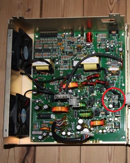

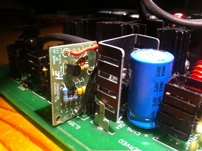

There are two things I'd like to mention:
- Looking at the pictures of Your LVPS I couldn't make out the small extra board that is to be found in later models and is intended to make sure that the filament voltage (plug P14) is held within tight margins. Please see the picture below for reference. Of course Your LVPS model could be so new that the circuit has been incorporated into the LVPS board. But, if You still find the old spindle trimmer for the 6.35V filament voltage You should check this first.

I have not tested the filament voltage yet, but i put the LVPS from my non ultra machine, that i know is right, so ill se tonight when it gets dark.
I dont have that regulator board in any of my LVPS.
