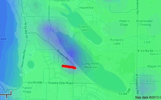

I didn't realize a nearby lake made a big difference. I live on the SW shore of a lake, with a bit of a hill (maybe 30-40') to the SW of me. Most of the distant channels are S and SSW of me in Denver / Boulder, some closer ones are W. What effect would the lake have in that situation?
FYI here's a close-up of my area, showing signal strength (from http://www.tvfool.com/?option=com_wrapper&Itemid=80) for a station 70mi to the SSW. Most of the area is green (fairly strong, probably work with a set-top antenna) but my immediate neighborhood on the SW side of the lake is purple (much weaker). The ridgetop near my house is the red line, and I suspect that's what causes the purple shadow. The lake doesn't seem to do much.
