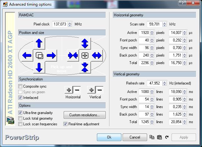

Updated 1080i96 timings that result in spot on 95.904 Hz (96/1.001).
Note that the porches are identical in both my previous and updated timings. It's the microsecond and millisecond values that differ.

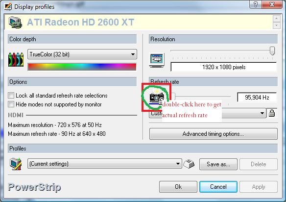

Something most Powerstrip users don't know:
the displayed refresh rate is usually not identical to what the videocard actually outputs (Reclock users know that).
However, Powerstrip has a feature that tells you the actual refresh rate.
You just have to go to the Display Profiles configuration dialog and double-click on the camera icon under "Refresh rate" (see attached pic).

The actual refresh rate trick doesn't work on interlaced resolutions, at least on my PC. (On both XP and Vista).
Rik Wang said that is still a guess. It's all integrated over time, so it's an average.

Posted: Mon Jan 19, 2009 9:11 am    Post subject:
Apparently it does work for me though.
However, I cannot use the latest Powerstrip version (I'm one of those affected by the 50 percent CPU load bug). And I really want to start playing with it since it allows us to write the extended EDID block.
