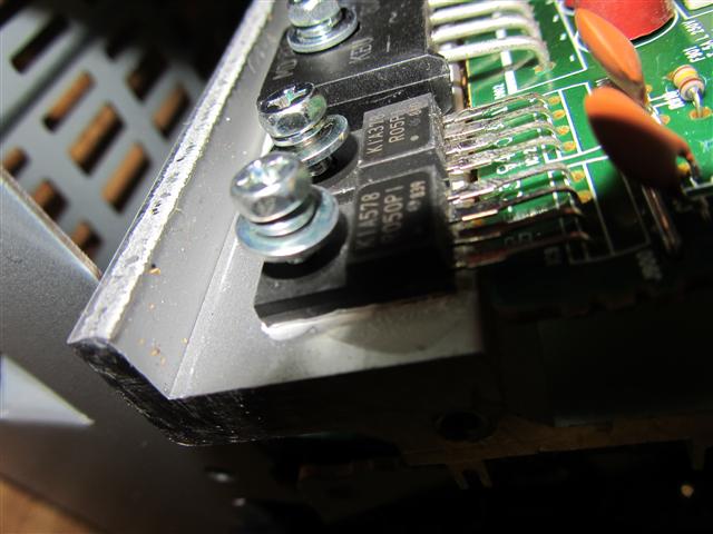

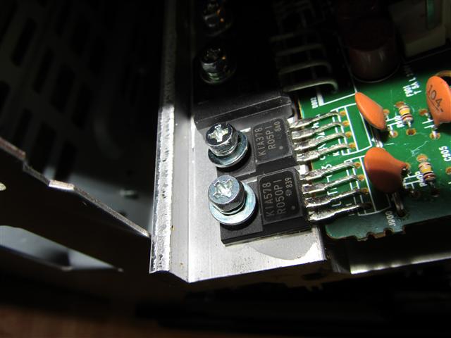

Greetings!
Yes, it does have a 4 pin device there. Looks like it says KIA 578 but nothing comes up for me when I search it. Also in the second pic you can see a bridge rectifier KBU 804 below the fuses, FWIW.

Posted: Tue Jan 08, 2013 4:33 pm    Post subject:
Ok, so it does have it. Then you should of had +5v on pins 4 and 5 at BN94 which, according to your chart you did not. Set your DMM to diode scale and see if there is a short between any pins of that ic91.
