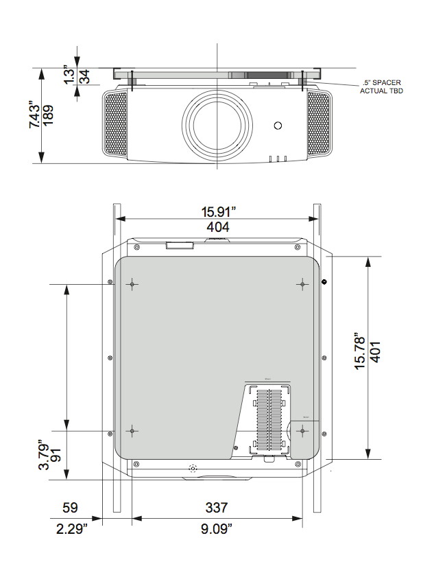

Posted: Sat Jan 26, 2013 12:52 am    Post subject:
RV, I don't have an 8-foot ceiling in my room, and my projector is right over my second-row aisle. The mounts all had either too much drop, were too expensive, or both. $300 just seems way out of line to me for a couple of cast parts, some stamped parts, and a black wrinkle finish. God bless them if they can get that... It just rubs me the wrong way.
Anyway, I wanted absolute max headroom, so I used 1" O.D. aluminum channel, and then built a "foot" for the projector out of Baltic birch. The projector mounts to the birch, then slides right into the channels I mounted flush with the ceiling, right where the CRT used to be.
I'm 6' 3", and I can now walk on the 6-inch riser, right under my projector, without ducking, and with room to spare. Winning!
Drawing attached.

Posted: Sat Jan 26, 2013 2:05 am    Post subject:
The projector is only 35 pounds, so we're only talking roughly 9 pounds per mounting point. I don't know how to calculate it (one of our engineers here probably could), but I'd guess that a single M5 screw would easily handle the weight of the projector all by itself, let alone a quarter of it.
Agreed.
I do know I wouldn't substitute imperial hardware for the correct metric hardware.
I also wouldn't substitute. They're 10 cent bolts from Home Depot. I'd use the right ones.

Posted: Sat Jan 26, 2013 2:39 am    Post subject:
Drawing attached.
Given the choice between what you did and Kals mount, I prefer your way as well. Like you, I give the head height and astetic value more priority than my picture quality.
But what I still don't like (as compared to my Barco mount) is that you have no flexibility to make minor vertical adjustments if you so desire at a later time. Thats why I was going the direction of thread rods into the existing mounts that I already have in my rafters. Yes I do agree I can buy metric hardware at Lowes but coming up with a metric thread rod I don't think would be so easy. Maybe an auto supply house, I don't know. I guess I could weld metric bolts to standard thread rod though, but then I have to worry about whether I can trust my welding to hold.
Posted: Sat Jan 26, 2013 2:48 am    Post subject:
Vertical adjustments are done via lens shift (which you have to use anyway).
I took the quick and easy (and more expensive) way out and bought the mount. I agree with SC that it seems silly expensive for what you get. A few things made me go this way: (a) a million other things on the go and not time to build, (b) I needed to drop down about 7" or so from the ceiling so the premade mount was perfect, (c) the mount will work with any other future projector I want - all you need to do is replace the one plate that fits between the mount and the projector (and if you stick with the same brand odds are future versions of JVC projectors may not even need a new plate).
