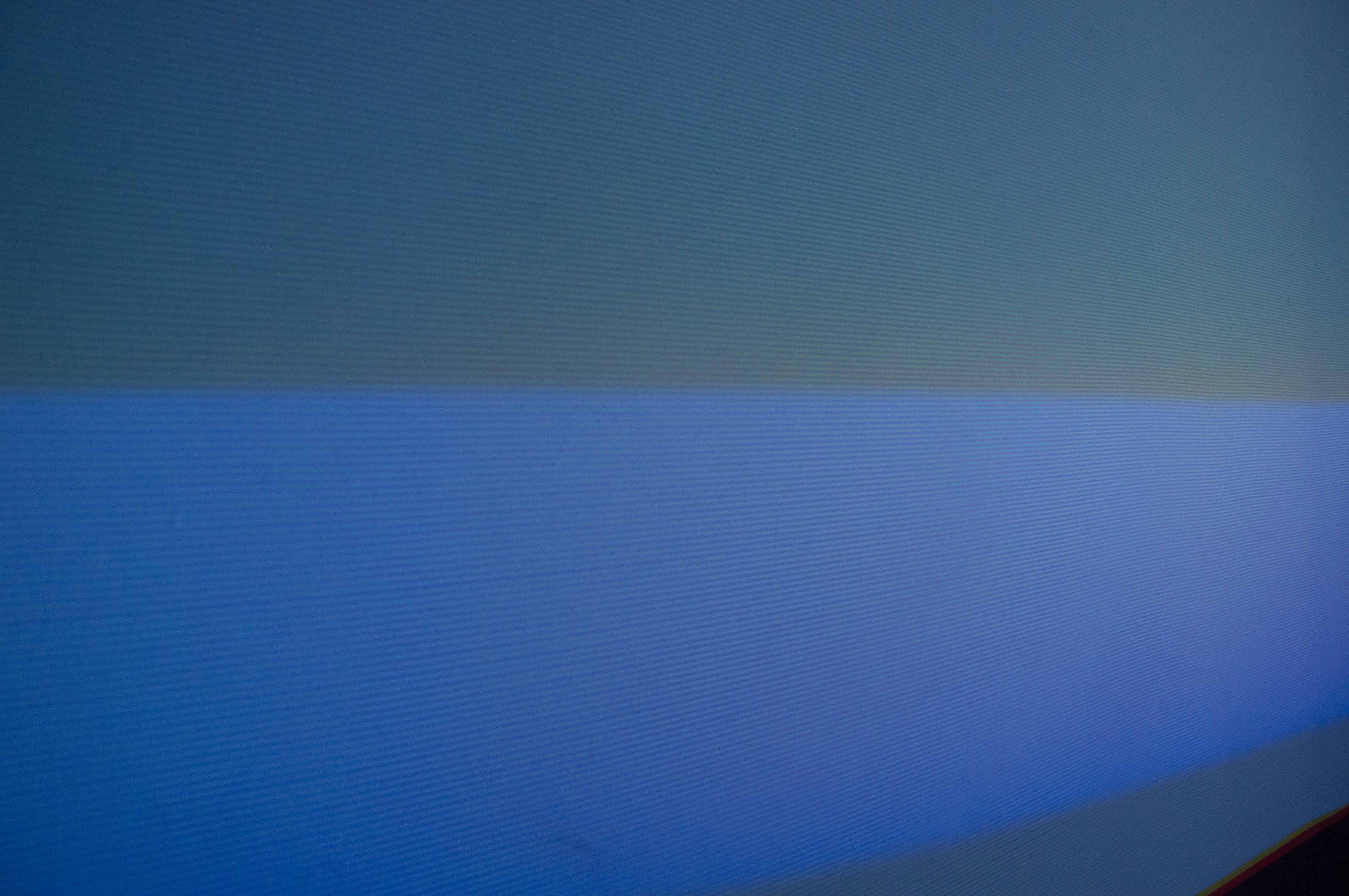

I tried to took a picture to indicate the problem, therefore I included a picture of the 'warm-up' screen.
Probably its just my eye's, but in this screen the lines do not move. However when connecting my PC the lines seem to move rather slow over the screen, moving from the top of the screen downwards

I've also included a small video clip, which hopefully visualize the problem a bit better: http://www.youtube.com/watch?v=3SyAtSRtJj4&feature=youtu.be
Be sure to play it in 720p and ignore the obviously noticeable lines, its all about the ones in the blue area of my windows desktop.
It might not look that bad, but honestly the screen like this is not usable, its very very noticeable when watching a movie or anything else.
It also does not change with Brightness/Contrast increase/decrease.
