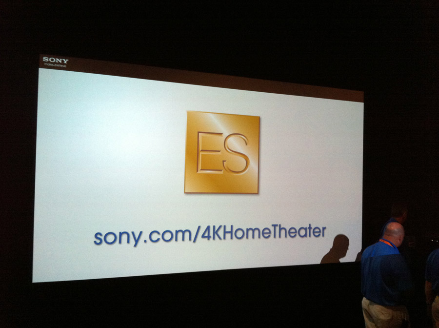

I can look back at my photo collection to see, but my recollection is that there were about 4-5 rows of 10 seats across, and the screen covered most of that width - so yeah - I'd guess something around 160- or 170-inch diagonal, or about 12-13 feet wide. "Up to 200-inch screen" is what they were pushing in the marketing, but that's 15 feet wide. I don't think they were running it quite that big at CEDIA.
And yes, it was definitely limited by source material. I was also sitting way too far back to enjoy the 4k at probably close to 2x screen widths. That's too far back to really see the big difference between 1080p and 4k.

Found it... Not sure how big that is. Anybody want to guess based on the guy's head shadow?
