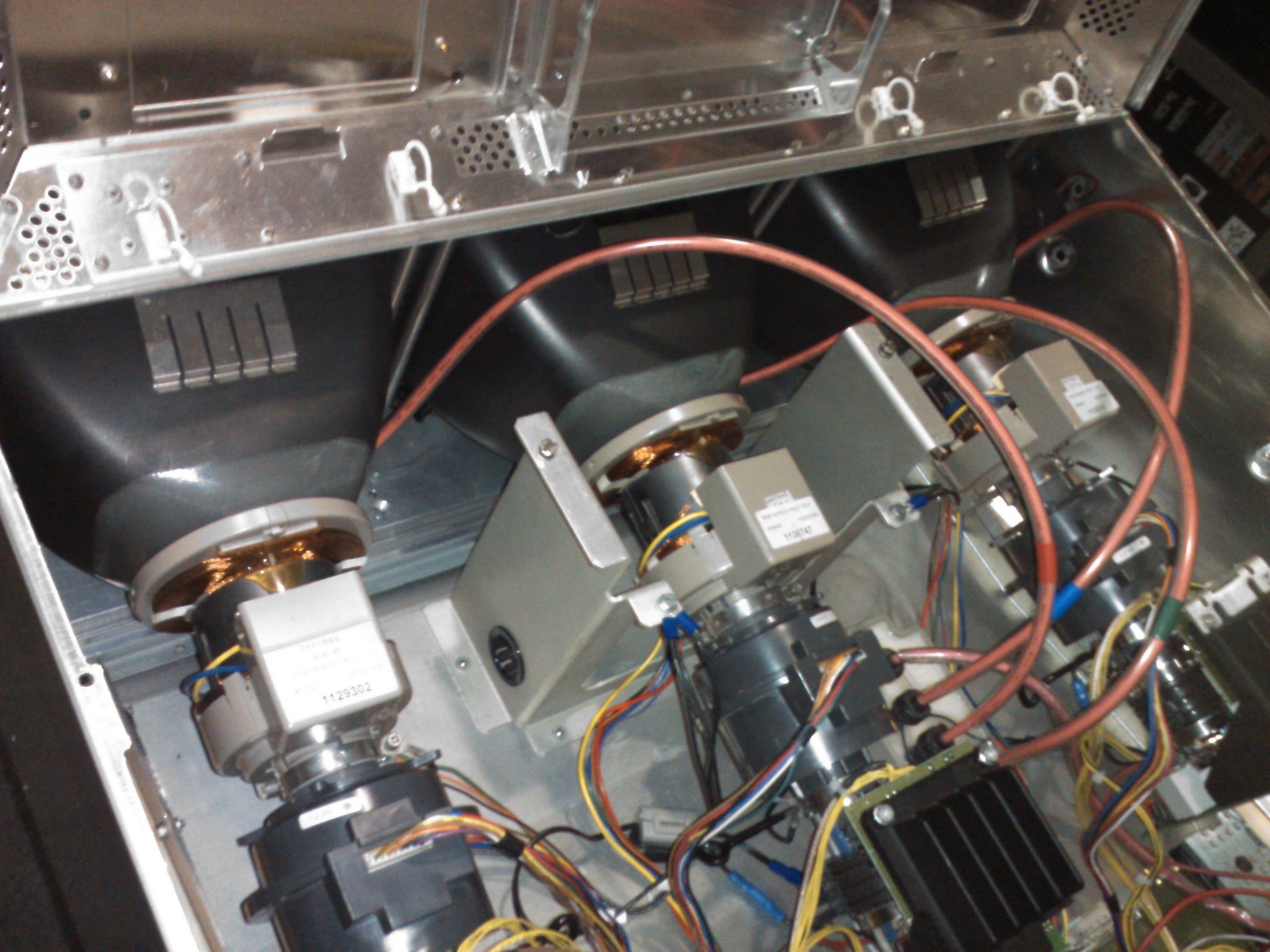

From what I can see the 909 is more closely related to the BG808s than it is to anything else. Thats why I used it to build what you see in the image attached.
BG808s with 9" tubes
 Filesize:  410.23 KB
 Viewed:  5772 Time(s)
Posted: Sat Dec 07, 2013 8:38 am    Post subject:
Thats a pretty special machine youve built there Keith, its somewhat of a credit to your dedication mate, i think its very well done.
