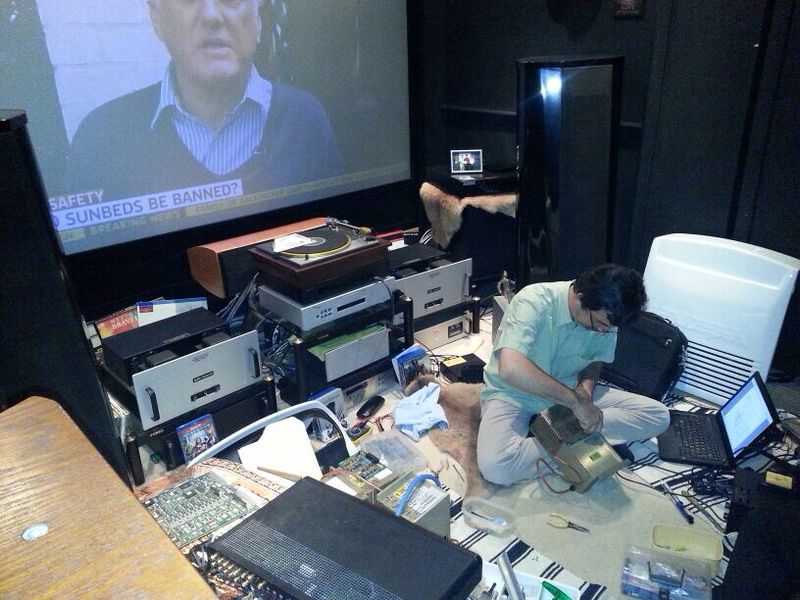

Posted: Wed Jun 04, 2014 3:53 pm    Post subject:
Guys,
Barclay66 were at my place for the last 2 weekend to look at my hvps. Now I have at least 3 hvps that is in working condition and really would like to thank him in this forum as well.
Not only that, he also gave me the latest chips for the clm U7(V5.6) and U35(V5.0). The chip for U35 (V5.0) is incredible as it give us the additional G2 sub brightness adjustment and now the colour is very outstanding.
Thanks Barclay66!!!!
Thumbs Up Thumbs Up Thumbs Up
Doctor Barclay66 in action! Thank you!!
