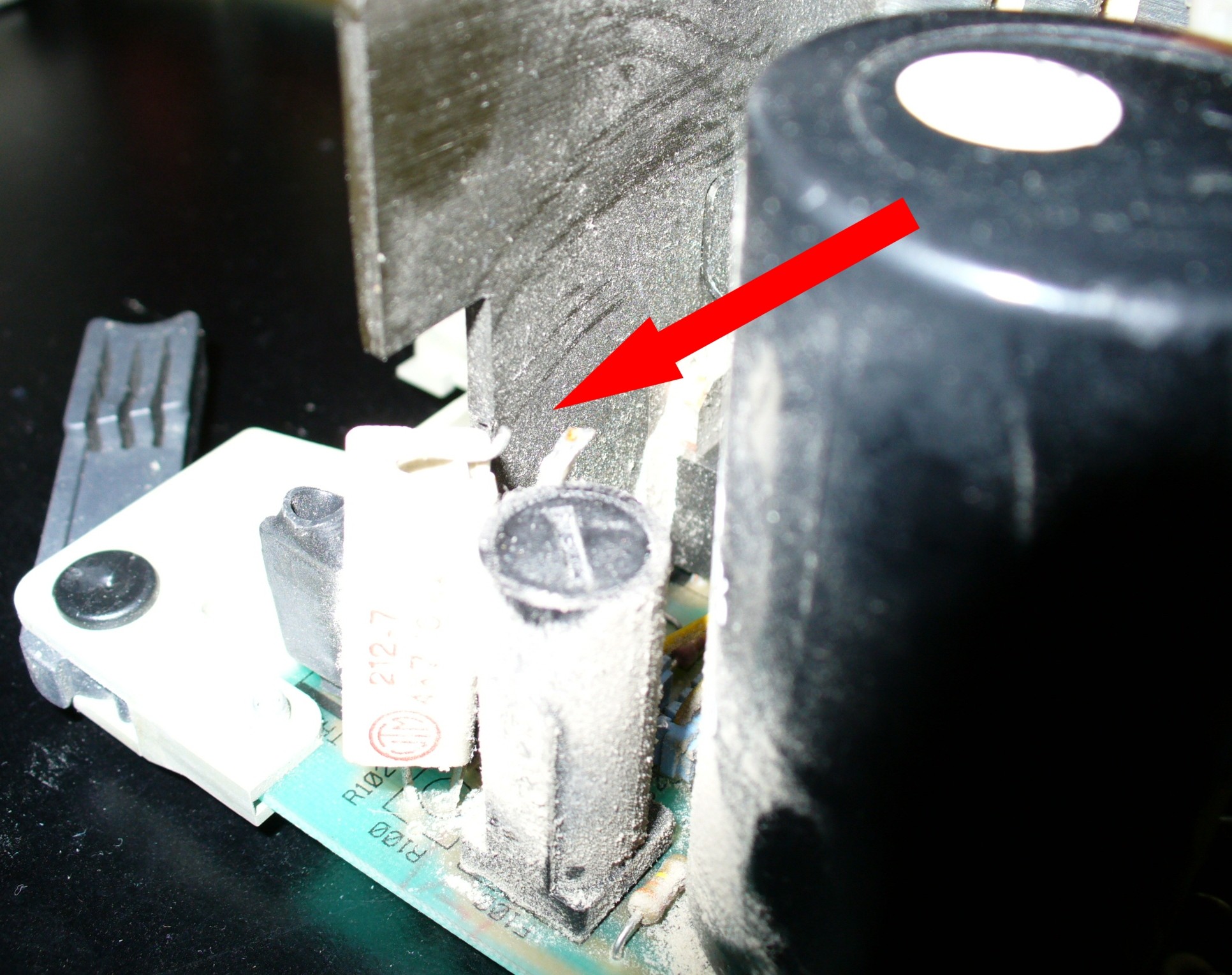

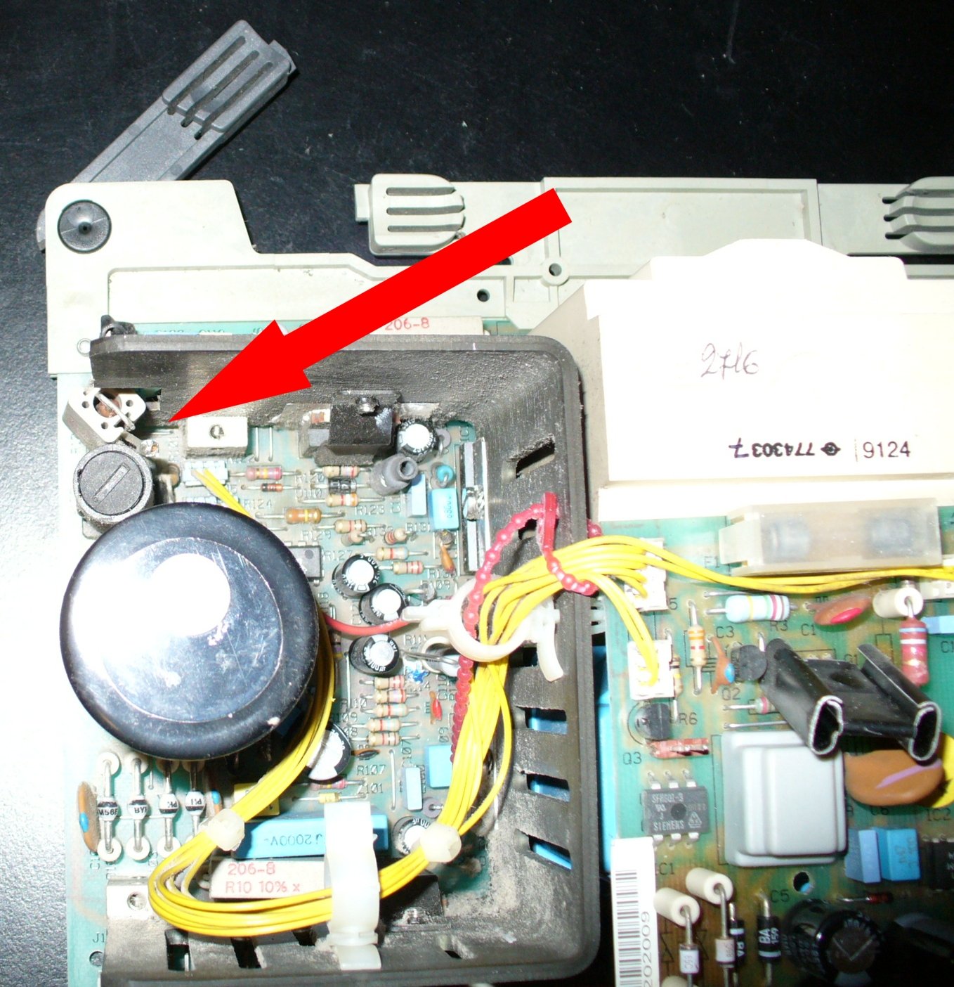

I've been browsing through Curt's troubleshooting steps for the Barco 800, and I think I may have found the reason it won't power up.
http://www.curtpalme.com/Barco500_Layout6.shtm
I tested the 125 mA standby fuse and 5 of the 8 SMPS main power supply fuses (all but the three covered up by the SMPS, which I didn't try removing) and they all appear to be functional. Then I noticed what looks to be a broken connection on the metal bracket leaving the top of the grey thingie (I don't know electrical terms so well Smile ) labeled "212-7 4K7 10%x", just above the main input fuse to the power supply.
Is that one of the common power supply failure items, and is it something I can try replacing myself? I don't see any obvious way to remove it.
The last pic on this page shows it from above, but the connection is difficult to make out:
http://www.curtpalme.com/Barco500_Layout7.shtm
It almost looks like on mine, I could bend the disconnected metal back in and solder the two pieces together, although I can't remember if I have a soldering gun. Confused
One other big item worth mentioning: The previous owner had a bit of a mouse problem and one apparently set up shop in the Barco... I've removed all the boards and vacuumed it out, and more importantly looked stuff over to make sure no wiring was sabotaged. The pics below are the only thing I found of significance. I haven't dug in under the tubes, though.
