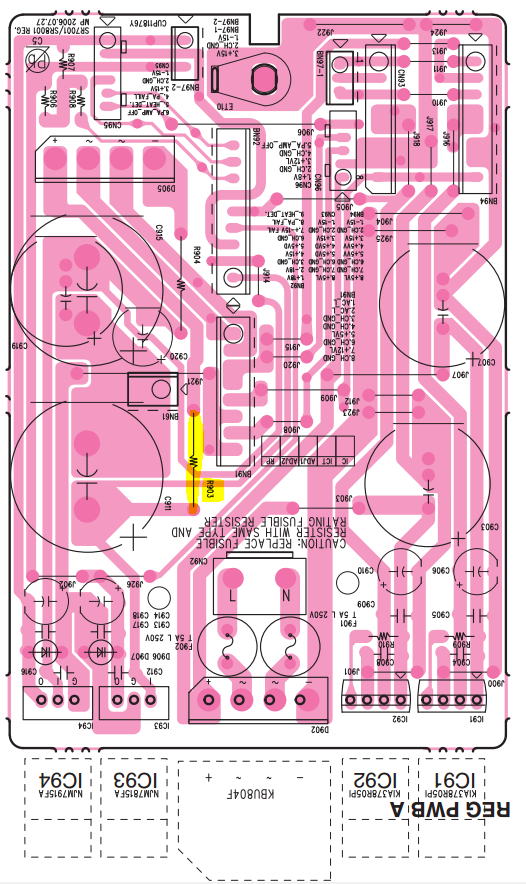

This thread is right on the money. My SR7002 stopped working due to power protect mode (blinking red led). With info from this thread and download of the SR7002 service manual online (3 bucks) I was able to replace resistor R903 on the Power Regulator board and resolve the issue.
A few notes on this:
1) There is a lot of ribbon cables/headers that need to removed to access this board so be careful. Best to remove the entire heat sink from base to better access this board from the bottom.
2) While you are in there mine as well replace the other resistor of same value acting as a fuse for another circuit (R904)
3) These are .33 ohm 1W resistors you can get a 10 pack from Mouser for around $10 with shipping
4) The board is upside down with respect to how the layout in the manual has it where R903 is toward the bottom.
5) Need small socket driver / ratchet set to remove the screws holding down the Voltage Regulators to the bottom plate. Also helpful for some really long phillips and standard screwdrivers.
6) After soldering new resistor and re-assembling you must reset out of protect mode using key sequence in this thread.
Thanks again this saved me $350 or more to replace the amp.

I have a Marantz SR8002 (same chassis as the SR7002 and possibly the SR7001 & SR8001) and the red standby light was blinking/flashing at the rate of 3 to 4 times per second (service manual says 500ms, but mine was definitely blinking faster than that). I took the cover off and found that there was no +15v. The fusible resistor (R903) on the REG board had opened. After checking for short and other issues, I bypassed it with a two amp fuse and my DVM in amp mode and the receiver fired right up. Current draw was about 540ma.
The service manual lists this part as: R903 90M-NH000160R FUSE RES. 0.33 OHM 1W FUSE RES.
With the help of a service manual and this site, I was able to repair the unit in no time. I just wanted to post a big thank you and wanted to note that both the SR7002 and the SR8002 use the same chassis, so the repair was the same. I also believe this same chassis was used for the SR7001 & SR8001 as well based off of notes in the service manual, so this repair may also be relevant to those models, but I can't be sure.
Hopefully this thread can prevent another beautiful Marantz from ending up in a landfill. Thanks!
-TDA1541
SR7001/SR8001 REG PCB. Photo is rotated to match orientation when installed in chassis.
