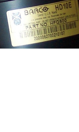

HD10E = HFQ900

Yeah, I was thinking the same thing, but finding out that there are two different specs associated with that one set of lenses, I prefer to now agree with the guy from Barco and go with "definitely different"
Also, I would like to think that the label on that particular lens shows that its a special version of the 10E.
