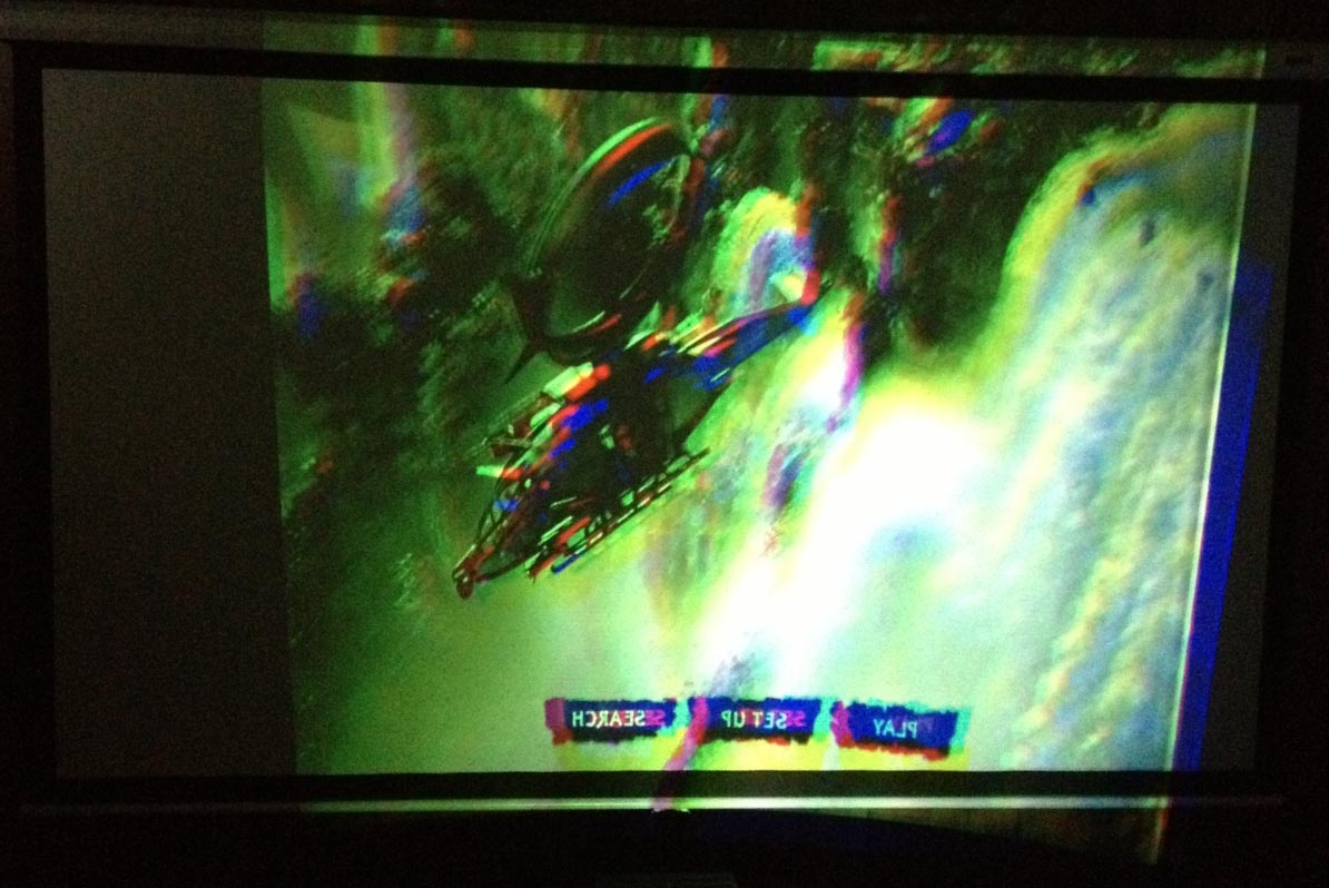

Posted: Sun Jan 13, 2013 11:59 pm    Post subject:
Here is the screen shot of the PG10 so far.
 Filesize:  133.38 KB
 Viewed:  7363 Time(s)

Posted: Mon Jan 14, 2013 2:21 am    Post subject:
Nice to see I have company with my 10PG. Rare as hen's teeth, but throws an amazing picture.
